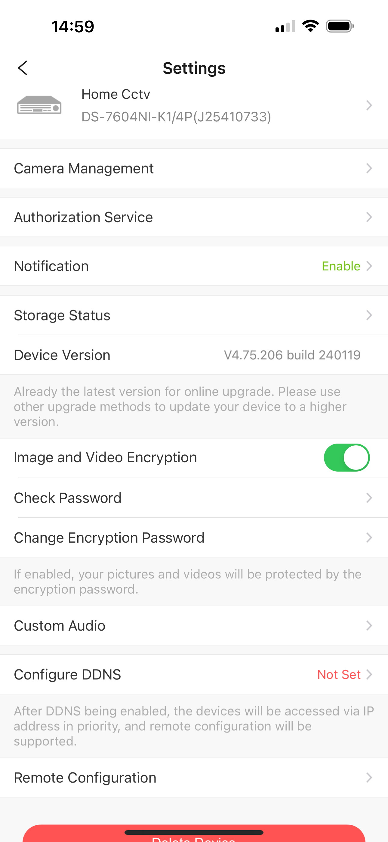

Could you send a screenshot of what you are seeing, please?
What are you running Hik-Connect on (iPhone or iPad etc.) and what iOS version is it running?

It is on iPhone and iOS 18
Also this happened before I upgraded to iOS 18, if you see from the screenshot there is no option there for intelligent detection or any of the other new controls/functions
The intelligent detection setting was only available where a camera is connected directly to Hik-Connect. It won't show where cameras are connected to the NVR with the NVR connected to Hik-Connect.

I'm not sure why that feature would've shown and then disappeared, all I can say is that I've only seen it where the IP camera was standalone and directly connected to Hik-Connect. Your firmware is up to date.
