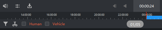

iVMS has a check box for "human" and "vehicle" but these are not available on my camera/NVR. I should add, I've added the NVR/cameras via hik-connect account, not locally of-course.

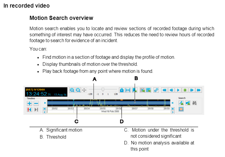

Bonus question. Many years ago a colleague showed me software he used at work (Indigovision). It's software app had this brilliant ability to overlay motion profile on the timeline, as can be seen below. That way you could click at different points which might be of interest. It was not binary event markers, but oscilloscope type so it was different for different cameras/scenes. I know this does not exist with HikVision, but it would be super useful. Has anyone seen anything similar and to make it work with HikVision cameras?

Regarding the bonus question, we aren't aware of any VMS with that capability, but hopefully, someone else can suggest something from experience!

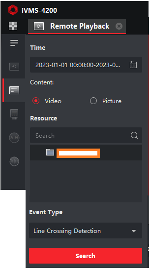

I did not notice the "Event playback" tab in the screen! However, when I search, no events appear and I have received events just today in HikConnect. To clarify, under my hik id, there are no cameras listed as a resource unlike in the playback tab, where I can see all the cameras. i.e.
Note, on the NVR settings the events already have "notify surveillance centre" enabled in the "Linkage Method" tab. This was necessary to ensure HikConnect send notifications. So is it another setting elsewhere?

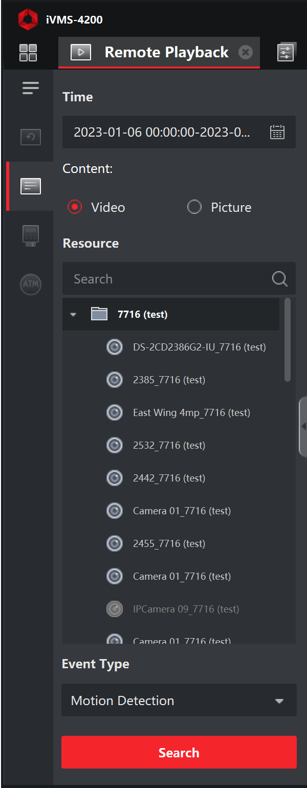

Ah, you need to re-add the NVR on the Device Management page, but when you do, tick "import to group":
There will then be a folder populated with the cameras in the Playback menu:
The device was already imported to a group. The actual problem was what I alluded to in my first post.
As you can see below, I have added my devices via Hik-Connect account. I went back in and added the NVR via IP/Domain mode which then now adds all the Video Events. It would appear if connecting via Hik-Connect mode, event channels are not pulled into iVMS. Someone is welcome to test and correct me.
The one downside of IP/Domain mode is you need to enable UPnP NAT to open to get to the NVR. I assume (again someone correct me) the Hik-Connect method is more secure because it tunnels via http.
Anyways, I can now view events in the remote playback pane, which actually works well enough.
Apologies, by that I thought you meant you had added your NVR to Hik-Connect via serial number to your account in the Hik-Connect web portal, as you can also add locally via IP to the app - reading too quickly!
It looks like you're probably right on this, I'm seeing the same thing, but it isn't something I was aware of before. Normal playback works fine for devices added via your Hik-Connect account, but I can't get event playback working.
