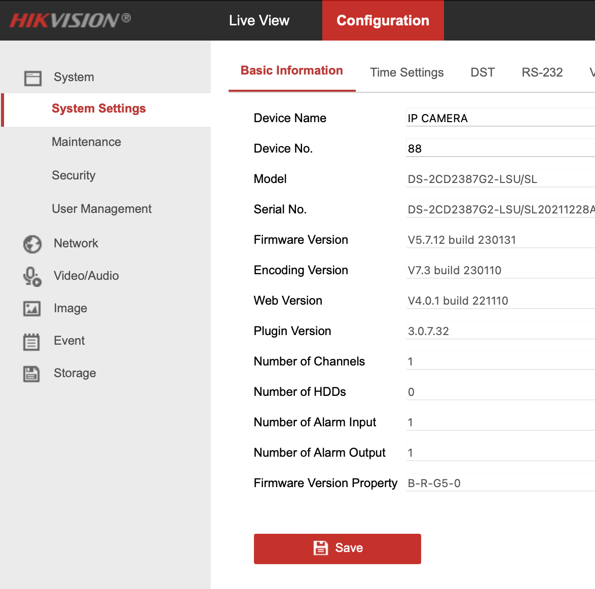

Mine above is a G5 with the latest firmware.

The ‘Firmware Version Property’ at the bottom of the page showing your existing version either has G3 or G5 in it - that’s how you can be sure. From what you’ve posted yours is a G5 and you can load the latest 5.7.19 if you want.
Occasionally you can get ‘update failed’ Clear your browser history or try a different browser if it persists.
Ah yes, it says B-R-G5-0.
So I need to get this version?
Yes. That’s the last version that supports VCA search/smart search for ‘non human’ when human/vehicle is filtered in the event setup. If you’re not bothered about that functionality and never need to do a non human smart search you can use 5.7.19 direct from firmware search page or any G5 camera product page on the main website (5.7.19 is not on the portal)
