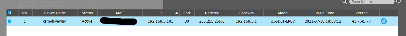

Camera is powered by PoE and I've restarted it a few times, it re-appears in the device list on my router, but the Web GUI and Video of the camera doesn't work. In the PoE section of the router (Ubiquiti 16 Port PoE+ switch) I see it's initial boot power draw that's high, then a lower constant draw a few mins after booting. When using the Milesight IPC Tools (v2.4.0.3-r2) I see the camera and the correct IP address etc displayed when discovered and I see broadcast packets in Wireshark.

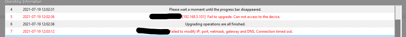

That doesn't work either, the tool just pauses for a few seconds and says "Cannot access the device", I tried changing the hostname also and it failed.

OK, It looks like it is a network issue.
Can you please use Command Prompt and confirm the router/gateway address of your local network, is your network range actually 192.168.5.xxx?
