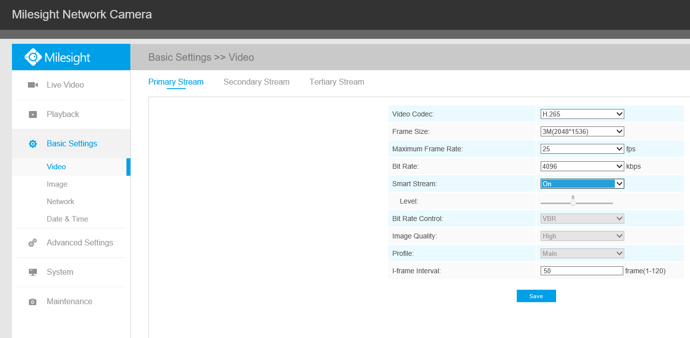

Milesight recently introduced their new most efficient h.265+ CODEC with Smart Stream in their latest camera firmware.
This is now available in all the current Milesight camera models (except the 4K bullet - for which h.265+ and VCA are coming soon).
To enable it you simply select the h.265 Video CODEC option from the dropdown, and then turn on Smart Stream. A slider control then appears, allowing you further 1-10 adjustment of the compression (10 being the most compressed).
As shown in the screenshot below:
