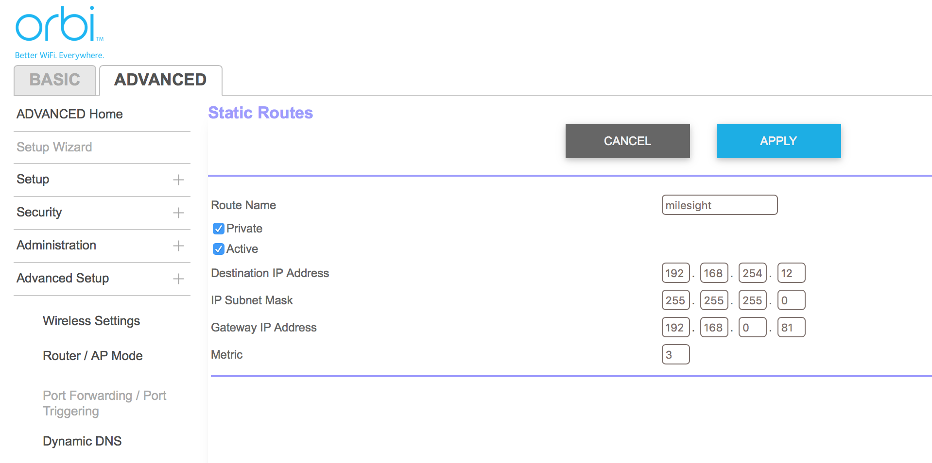

Hi Magic, thanks again for helping out with this. However, I have been trying to sort this out all day with no success. I don't actually know how to set up a static route, I have googled and tried but failed dismally.
I have Netgear Orbi routers and they do have the function to set up a static route but I've put what I thought were the obvious details in but I still get 'failed to open page' notice?
Screenshot attached?
The destination IP can be 192.168.254.0 to reach the whole subnet. If 192.168.0.81 is the IP of the NVR, then it should work. I’d suggest 1 as the metric.
Does it allow you to reach any of your other cameras on the NVR?
Yeah, you're correct with the addresses, it won't let me use 1 as the metric. It also won't let me access the other cameras.....

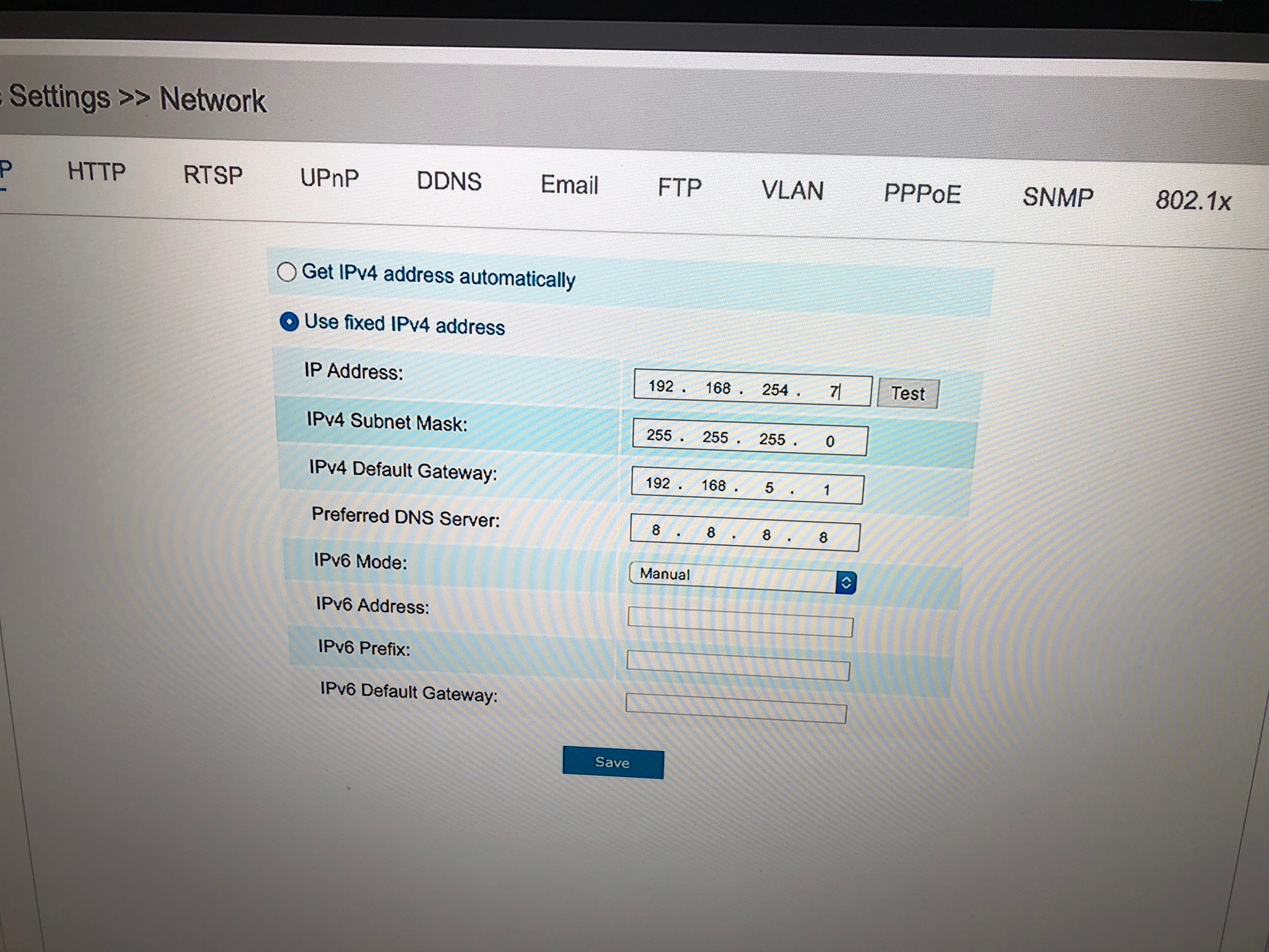

This is where it now gets tricky though as the only way I can now access the MIlesight directly would be to cart the mac down the cellar. I do have this grab that I took originally but I don't think these are the final settings... if that makes sense? Or if anything in this pic helps?
That default gateway of 192.168.5.1 doesn’t really fit your networks. If that is set now, then it would cause problems. You’ll probably find it left empty on your working cameras.

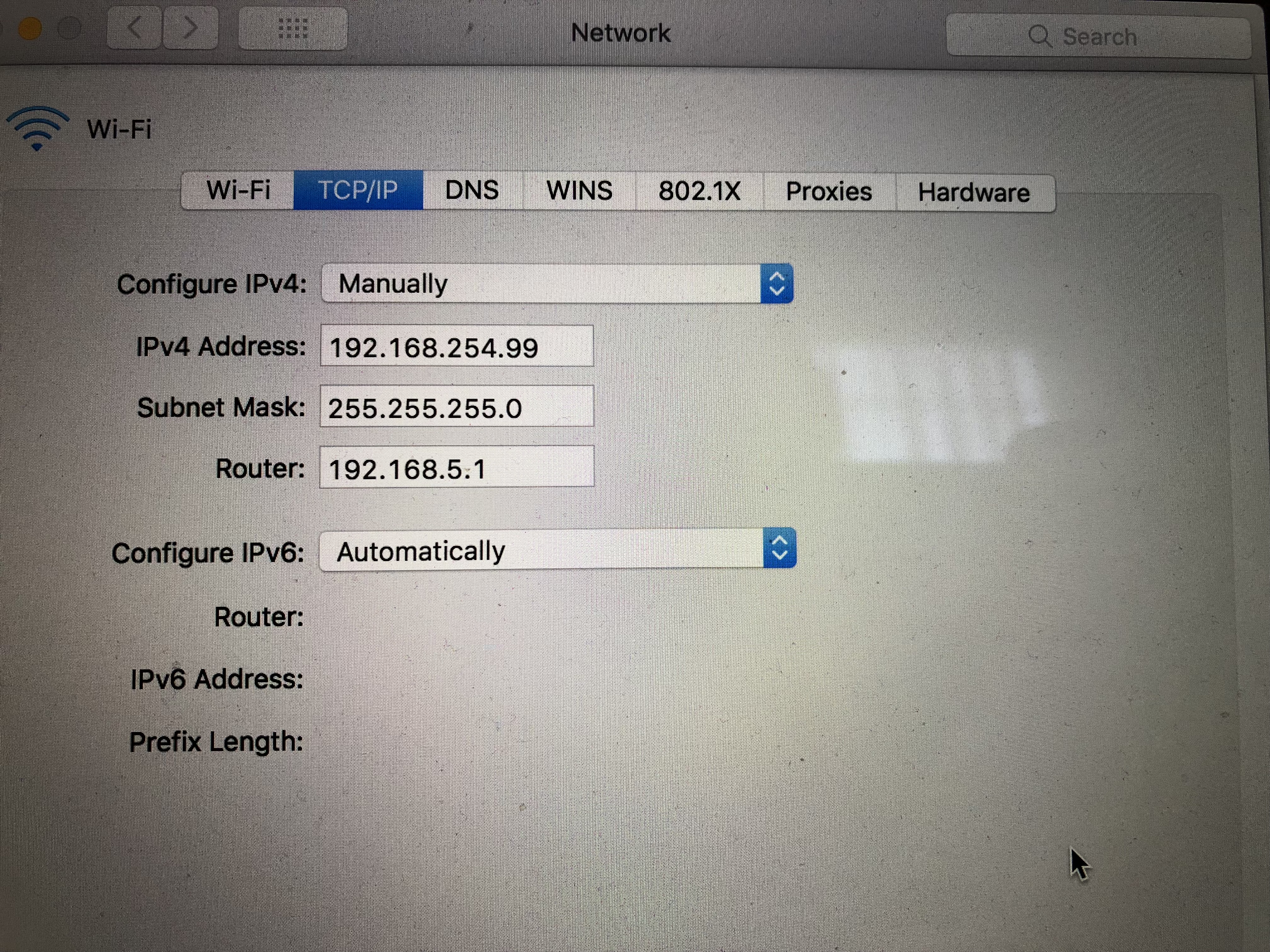

Ok, here’s a suggestion. Can you give the Mac a 192.168.254.x address where x = 200 or something else unused. Then try to hit the 192.168.254.12 address on the Milesight. This would work wired into the PoE switch and may also work on your LAN if you’ve run a cable between.
Right I’m in but connected the camera to my switch directly. Wouldn’t connect through NVR.
This is the settings on my Mac

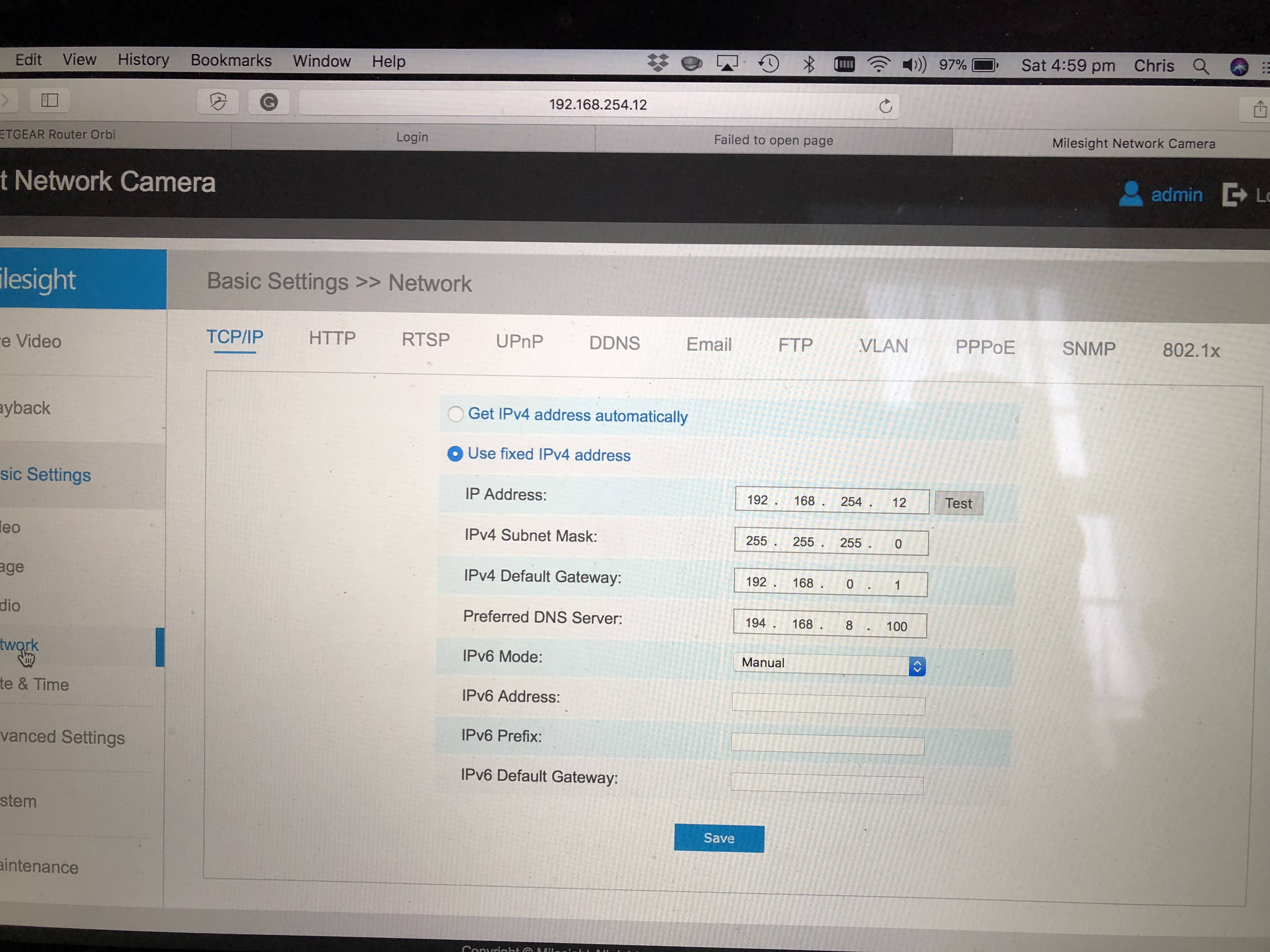

And this is what I can see on the camera.
What can I do/change so I don’t have to go through this every time lol?
My cameras work with no default gateway. Can you just remove the one on the camera?
It says it’s a required field? If I add 0.0.0.0 I get a warning saying it’s not on the same network subnet as defined by the IP address. Do I want to save this configuration.
