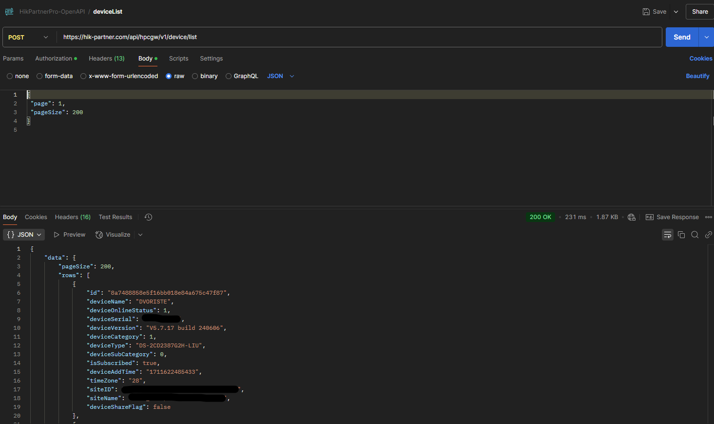

We have a HikCentral (v2.6.1.20240816) server that we want to use to manage a variety of remote devices. Because of the potential issues with all of the different firewalls/switches/etc. between HikCentral and the devices, we've been advised that the best way to do this is to add the devices to our Hik-Partner Pro site and then import that site into HikCentral.
I've added a test device (a HikVision DS-7316HUHI-K4 DVR) to HPP, imported the site into HC and I can now "see" the device in the HC web client. However, there are several issues that lead me to believe that something's gone wrong:
1. HC is reporting that it can't get the device's time zone, no matter which setting I try (NTP or manual).
2. The device's IP address and serial number aren't listed.
3. Navigating the device's configuration pages in the HC web client is incredibly slow: it can take a full five minutes for the inital configuration page to appear; and after that it can take 30 seconds to a minute to move between config pages.
The only ports open on the HC server are 80 and 443. Do I need to open any others? I haven't done any port forwarding/DDNS configuration on the device itself. Is that necessary?
Many thanks in advance for any pointers/guides on what I've done wrong and whether this is the right way to add devices to HC.
