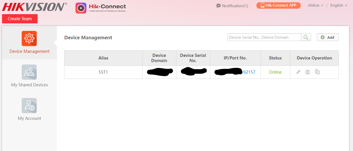

If I login to https://ieu.hik-connect.com/ I can see the NVR (although it has a different Alias) and it shows as online so not sure if I have added the NVR correctly now to the hik-connect app?
I've tried re-installing hik-connect, and adding the NVR via it's serial number. I get the same message as when I tried to add it via QR code. It shows a screen that says device has been added but on this screen there is no button to advance and if I click back it goes back to the Add screen. If I exit and restart the app it hasnt added the NVR

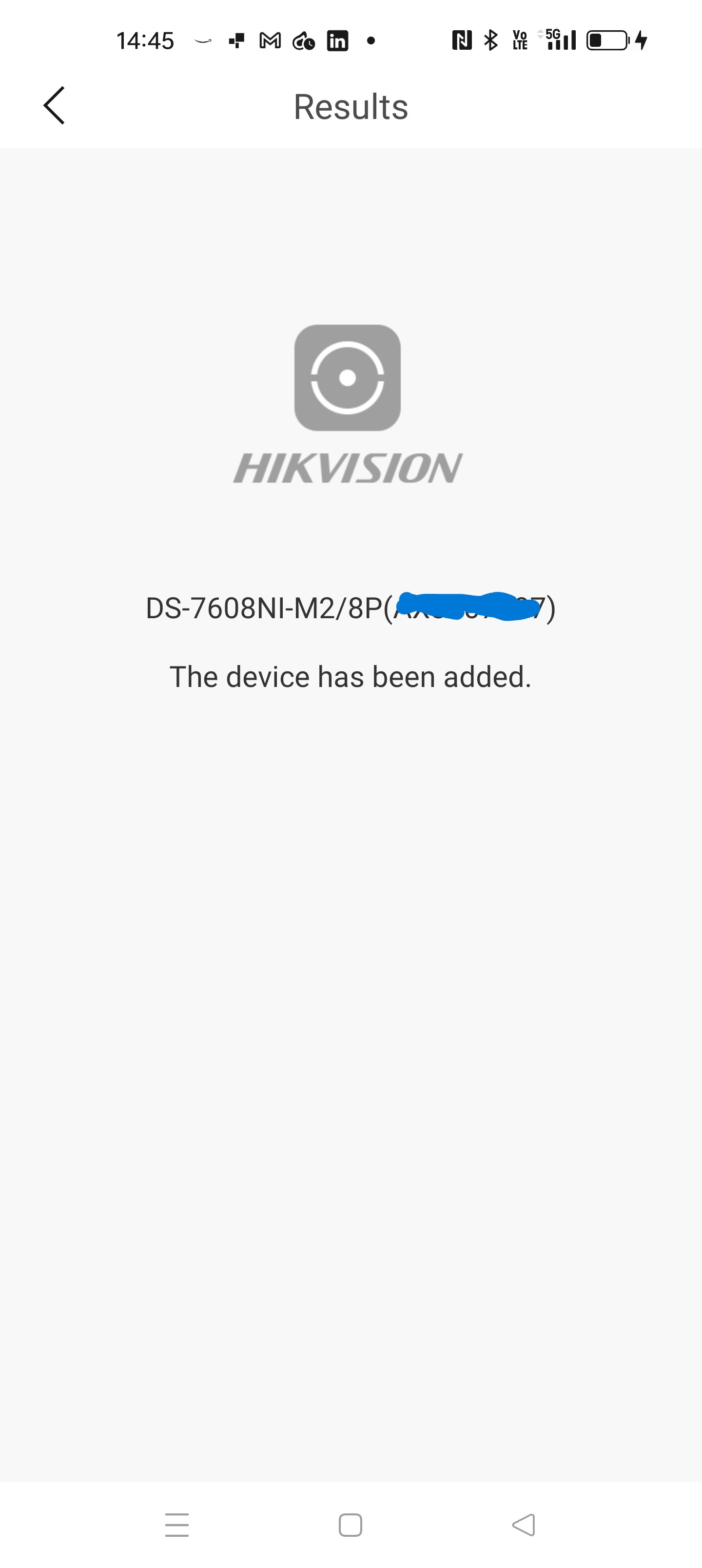

When I login to the NVR (web) under HIK vision is showing as online - and shows the QR code to add to the app. when I login to ieu.hik-connect it again shows as online.
I've removed the 'local' NVR. I've tried to re-add both using the QR code and the serial number - both get as far as the attached screen. There is no 'next' nor does it take me onto the screen where I can name the device or the screen where you can skip the service provider authorisation (as documented in your how-to How-to: - How to add a Hikvision NVR to Hik-Connect)
You can see on the screen there is no way to move off that screen? I can only click < back which takes me back to the previous screen to add a new device.
I updated HIK connect yesterday and am running the version reported as the latest on Hik visions software site (version: 6.4.0.0613, Update at: 2024-06-17)

Although, I have just tested with our M-Series NVR on that newest firmware, and managed to add it to Hik-Connect using the Google DNS servers.
I get the same screen in your screenshot once the NVR has been added via QR code, and I try to add it again.
So, there shouldn't be an option to progress from that screen other than back.
I.e. Hikvision's servers seem to think that the NVR is linked to your Hik-Connect account, but it isn't showing, which is why it's taking you to that page (thinking it's already added) - very odd...
So, try using the SADP tool to unbind the NVR, which should completely remove it from any account it is linked to, and then try the QR code again.
If that doesn't work, can you please send screenshots of what the app home page is showing you, as well as the web portal? (Blur out any serial numbers.)

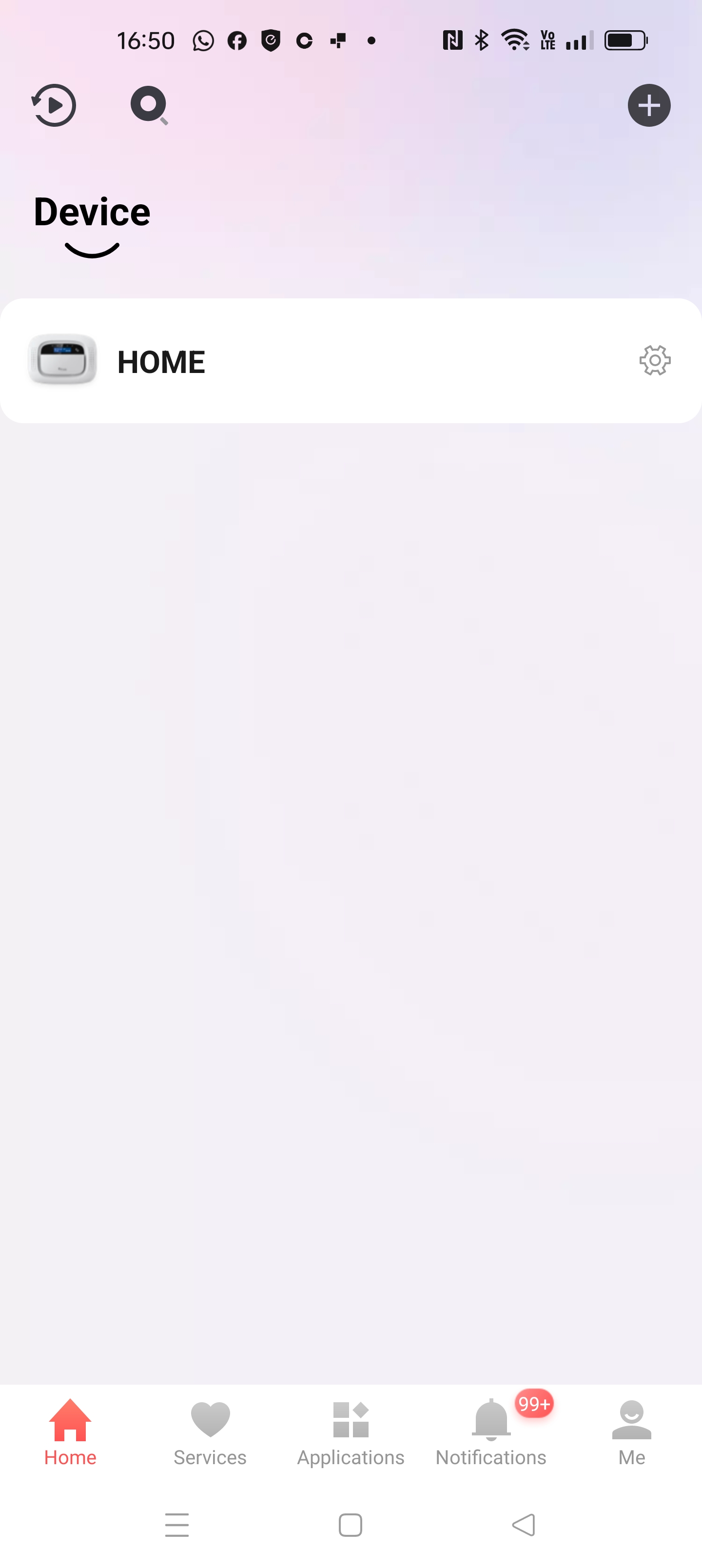

I've gone into the SADP tool - ticked the NVR, clicked un-bind, username admin and the password of the NVR and it says failed. Here are some screenshots
1. android app home page - HOME is my pyronix alarm system
2. SADP screen
3. Web portal - I've also blanked out the IP (which was the public IP) 86.19.xxx.xxx
