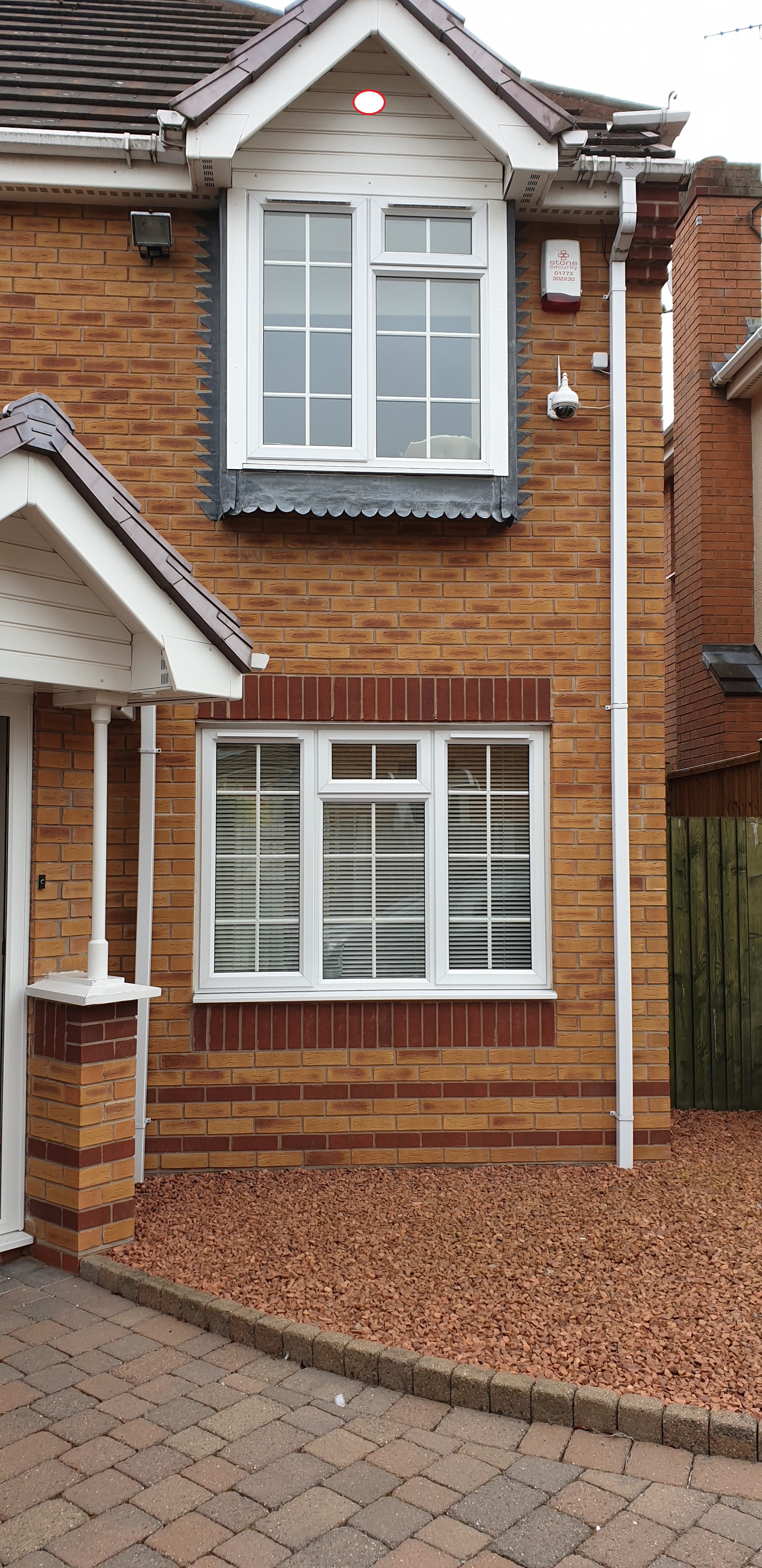

I currently have 1 x Dericam IP camera which I'm going to replace with a 4 Camera Hikvision NVR system.
The camera I currently have has terrible issues with white spots at night from where rain has dried on the dome. I understand the turret cameras don't suffer from this issue as much and I was going to go down this route but what I was thinking was mounting the camera where the red circle is which is more sheltered. Does anyone know If I'm likely to have an issue with the infra red bouncing back off the white box section?

A turret camera will be fine there.
2345 Dark Fighter
7604 NVR.
2TB HDD
