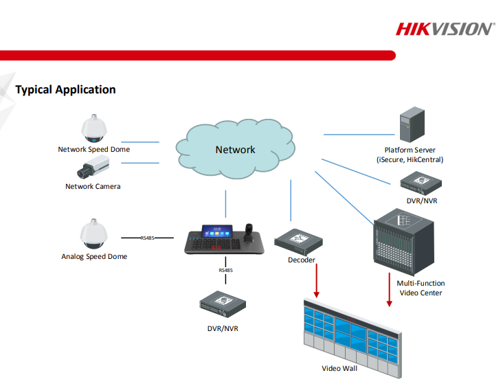

I believe that you'd connect the 1105-KI keyboard to your network, and configure it to do all that you wish:
