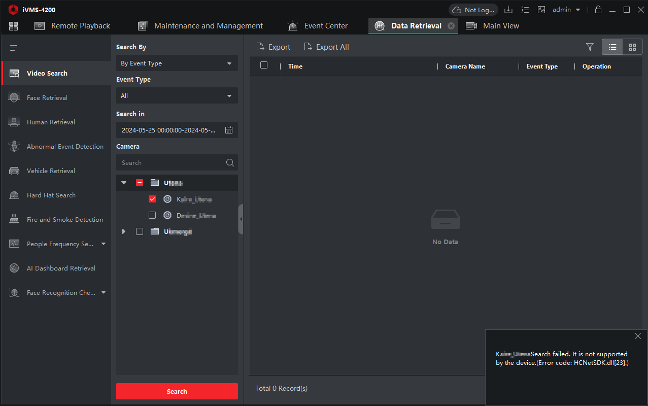

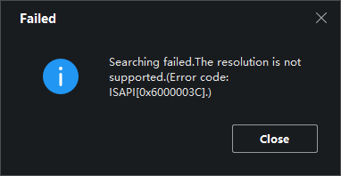

I have also tried Video Search feature and it is not working at all. I always receive "It is not supported by the device" error.
I have not used this feature before, so I don't know if it was working previously. My steps: launch iVMS, go to Data Retrieval tab, pick Search By -> By Event Type, select one camera, click Search button. After that I always receive the same error as you can see below.
I am testing these features on two different NVRs (NI and NXI), which both have the latest firmware.
Is it a software bug or am I doing something wrong?

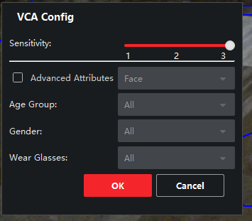

Remote Playback - Camera Playback - NXI-K camera playback - VCA search for previous days gives no results.
Also closing iVMS or restarting PC, then VCA must be re-adjusted to sensitivity level 3, otherwise there are no results even for present day
