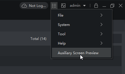

Here it is. With that you get extra IVMS screen for another different view.
Hi, have you tried Auxiliary monitor in IVMS? If i understood you corectly.
I did not know that feature existed, that is pretty much what I was after, thanks. BUT although it seems it would work with another monitor connected to the same PC (you could drag the second window to another monitor), I wanted to move the second window to another windows virtual desktop (allowing me to flick between the two main views using the virtual desktop hotkeys).
But so far I have failed to find a way to do this - you can't seem to move second window to another desktop. Unless anyone know different?
As i know you can move it on different monitors of same PC.
