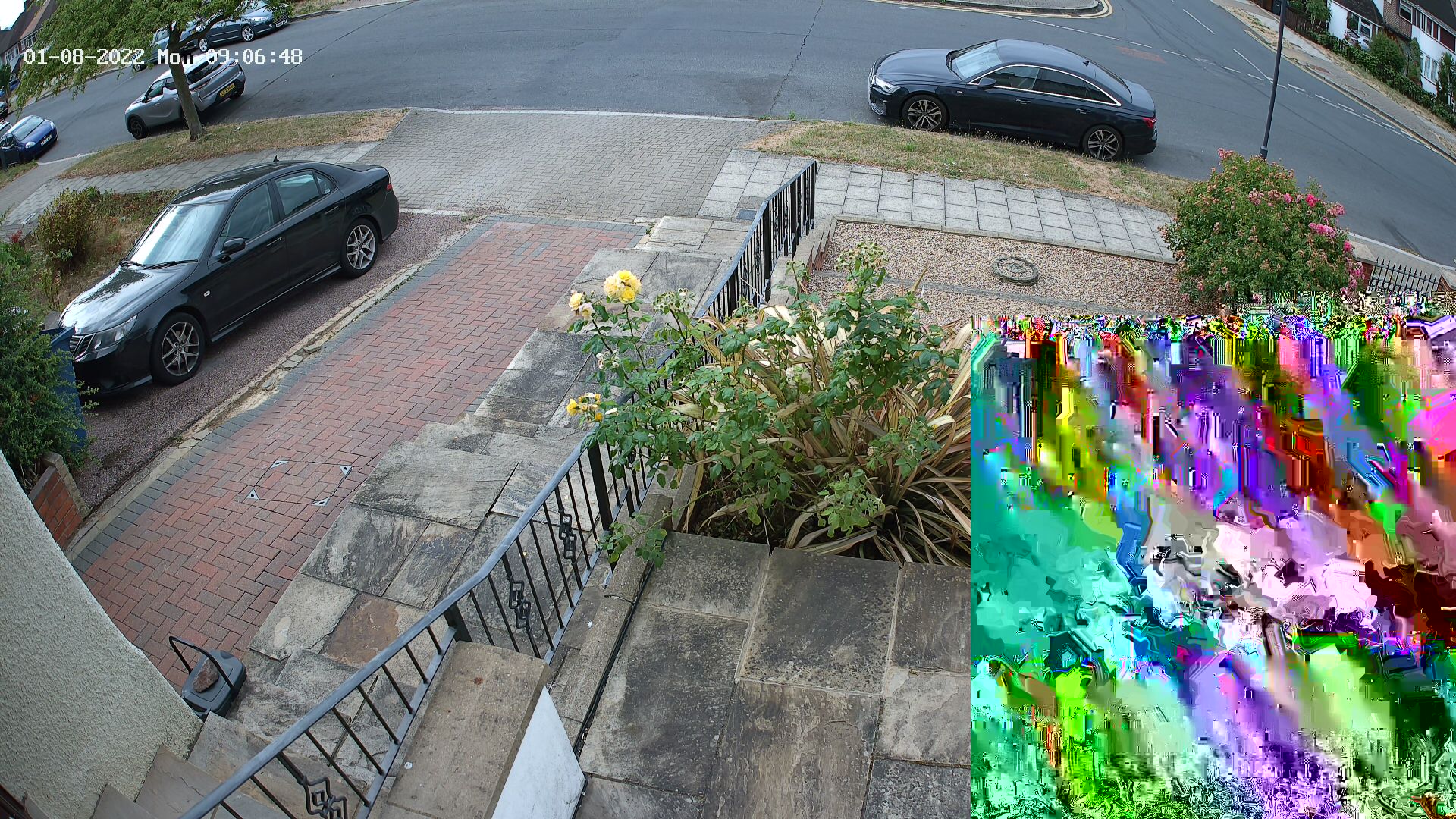

  5. Sometimes the recorded video contains sections with what looks like fuzz/noise. See the “Fuzzy Recording.jpg” capture. This happens 2-3 times a day and lasts for 1-2 seconds.

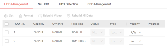

    1. Should I just have both HDDs set to R/W in storage settings? (I seem to think it might decrease load on NVR)

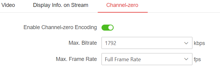

    2. Does Chanel Zero have any benefit for me? I enabled it thinking it might make live view on HK app smoother but subsequently read that it only works for admin user?

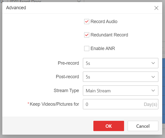

Local Playback on the NVR (via HDMI) jerks every 5secs - plays fine for 5secs, then freezes for 1-2 seconds and then resumes but seem to miss those 1-2 secs.
Set the pre record to 0 if you're recording 24/7. It's unnecessary to use pre record unless you're recording motion/event only. Going way back having pre record at the default of 5 seconds has been known to cause this issue.

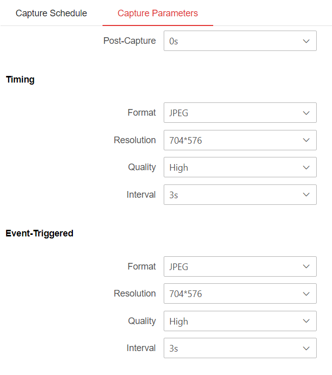

Are you using the captured images for anything? If not, don't use the capture - event or continuous. If you've continuous recording set, it's just additional processing for the NVR and shouldn't be necessary (unless you've a specific use for those images). You're potentially just filling your hard disks with thousands of unwanted jpegs.

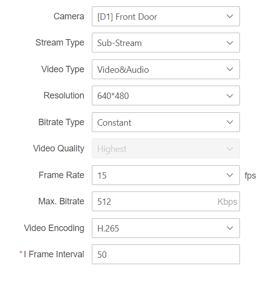

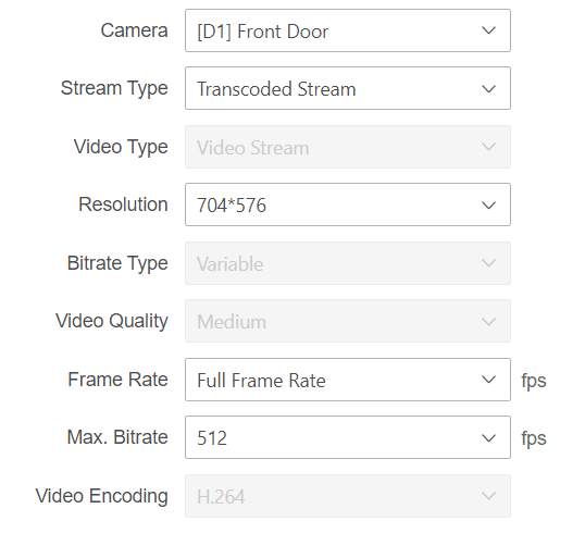

I don't use transcoded stream myself. However I'd say 512 kbps for full frame H264 is too low at that resolution. At 4CIF (704 x 576) you should have that at 1024 or above.

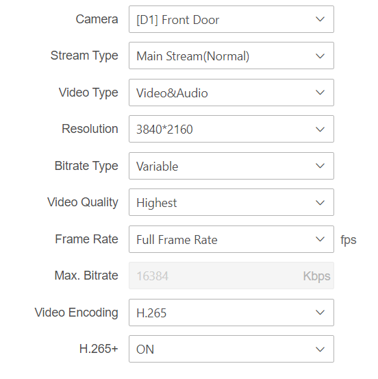

You're recording the main stream but you've not shown the parameters for the main stream.
Channel Zero simply encodes all images into a 'multiscreen' so to speak. It sends that 3 x 3 layout of 9 cameras as a single image and restricts itself to the FPS and bandwidth set. It's useful if you're away and have an iffy mobile data connection but want to check your cameras and you're struggling to get enough bandwidth to show a stream at its native settings.

Thanks @JB1970. I've set the pre-record to 0, rebooted and that's helped considerably with the jerky playback.
I have some smart events set that only alert me via email, so I had enabled captured images for those. If they don't need it, I can disable it? Or only enable it on cameras where I have email alerts configured and perhaps set them to Event based rather than continuous to save the extra processing?
Continuous Main Stream setting also attached.
I've turned off Image Capture altogether, pictures in email alerts work with it anyway.
Pre-record is snow set to 0.
Increased bitrate for Transcoded stream to 1024.

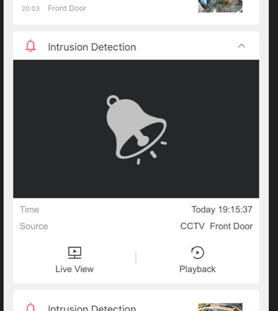

Still had the same issue with some events being missed despite people walking in and out.
So I reverted to firmware V4.61.010, Build 220606 on the NVR, reset to defaults and re-configured everything.
Image capture is still off and pre-record is still set to 0.
The only smart event set is Intrusion Detection on one camera which is set to alert via Buzzer, Email and HikConnect.
Initially it all works ok, then after 1-2 days I receive an email when the event is triggered but no notification via HikConnect. Sometimes the event is never triggered - my wife drove up and parked in the driveway, got out and walked into the house - no event triggered. On another ocassion, I received the attahced alert via HikConnect which didn't have a the video playback.
Not sure what the issue is but seems like the the nvr/cameras aren't doing their basic operation?
