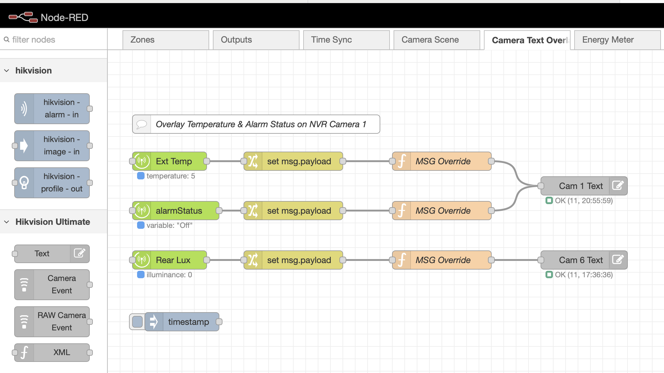

I use a node-red flow to add various text to a couple of my cameras. The node-red Hikvision palette provides an easy method to do it. I'm adding external temperature, lux, and the status of my alarm system from a link with Hubitat; however there's a multitude of node-red palettes. You would look at the 'Big Timer' node setup with a cron job and the Hikvision text node (from Ultimate Hikvision palette) to configure the camera connection/add the text. There would need to be a node to grab that info from your spreadsheet, but it will definitely be relatively easy to do.
A quick peruse tells me that you would add the 'node-red-contrib-spreadsheet-in' node to read your spreadsheet. That would grab the value from your spreadsheet.

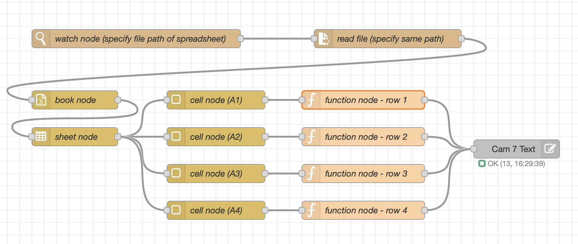

@zane - I attempted what you're wanting to do with node-red. It was a learning curve as I'm new to it but I got there in the end (after a lot of 'payload undefined' messages). This is the flow:
  1. node 1 (watch) looks for changes to the workbook at the specified file path. There are no settings other than the absolute path to the file.
  2. node 2 (read) also specifies the same file path and has one setting 'output' set to 'single buffer object'
  3. book node has no settings but is needed
  4. sheet node specifies 'sheet 1' of my workbook

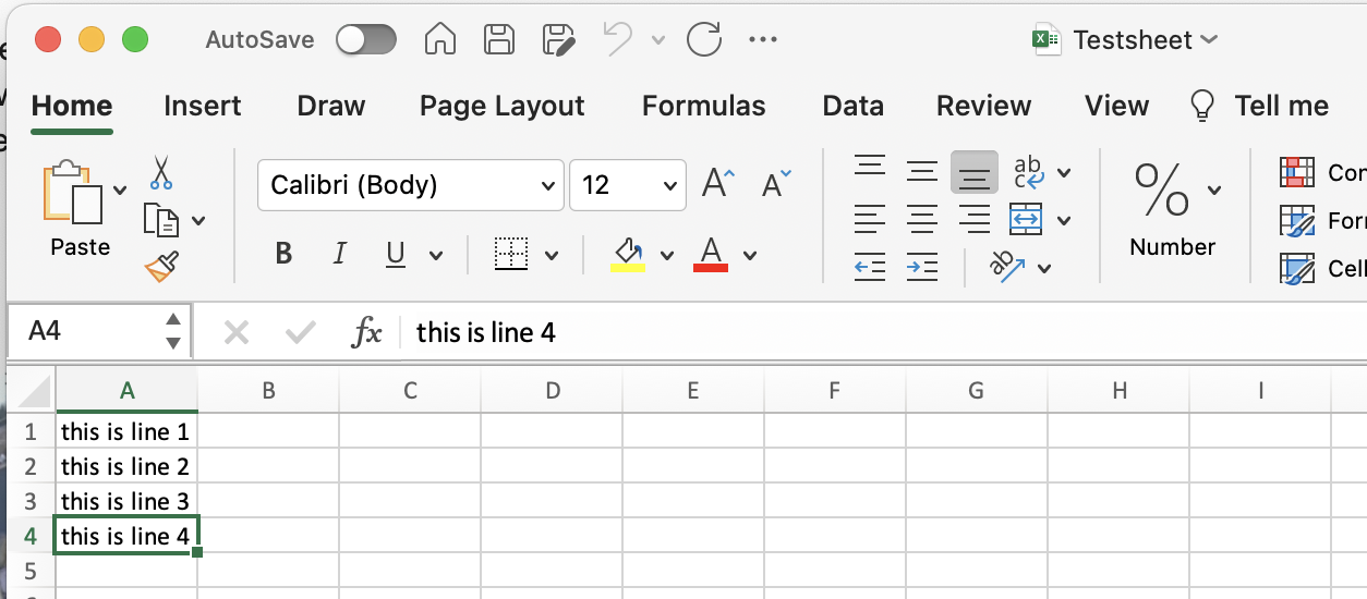

  5. the 4 cell nodes specify the 4 cell addresses that I want to output the values from (A1, A2, A3, and A4) They have a setting 'data type' which is set to 'raw value'
  6. the function nodes have some settings that specify the camera channel on my NVR, the row that will be used and optionally the x,y coordinates of the row if they are to be changed from default
  7. finally the 'Hikvision ultimate text node specifies the server (my NVR but could be a standalone camera) and the NVR channel

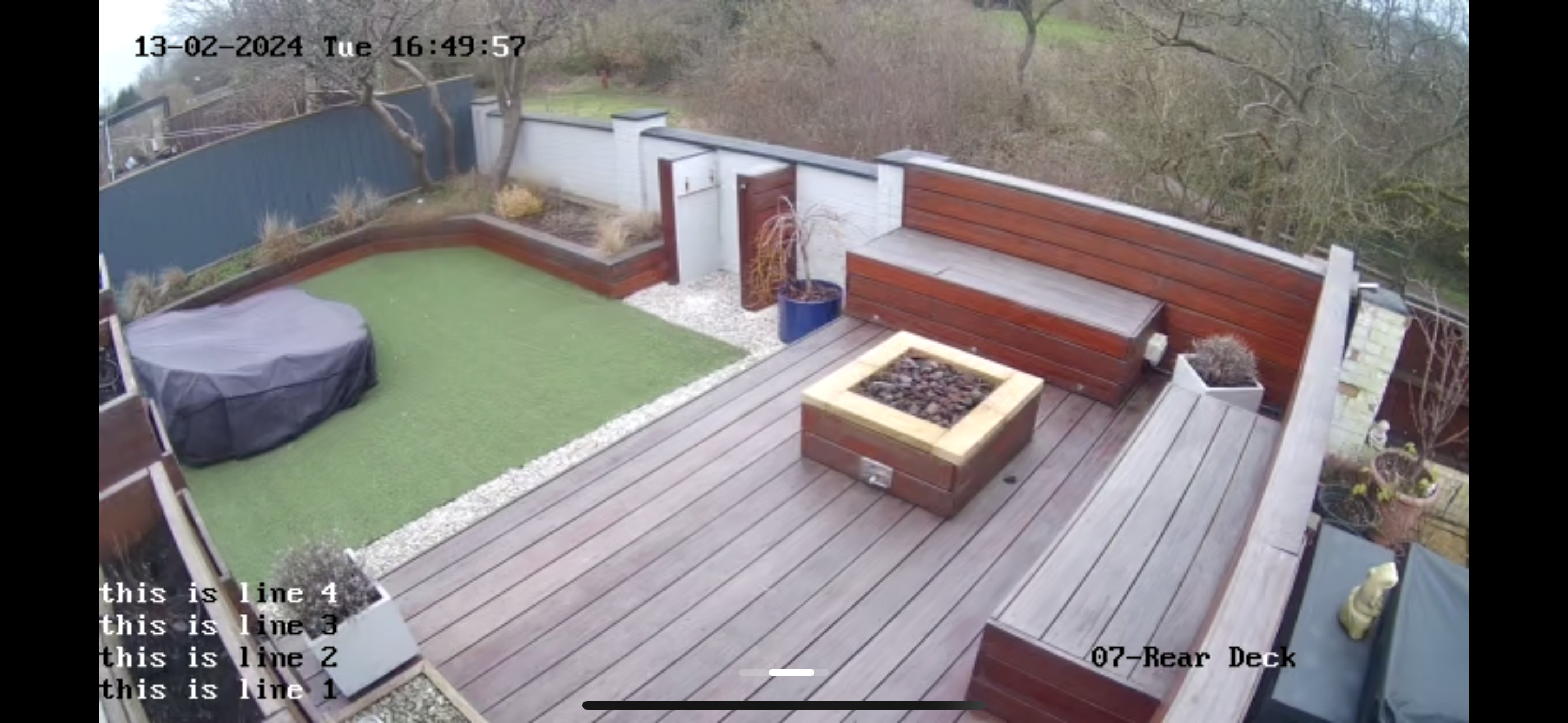

In my example the watch node at the start means that any time I make and save a change to the spreadsheet, the values from those 4 cells will be updated in lines 1 - 4 of my specified camera. I could easily have replaced that first node with a timer that forced the values to be resent every x minutes rather than looking for changes.
