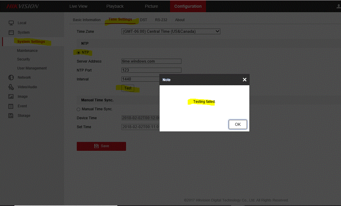

My Hikvision IP Camera DS-2CD2542FWD-IS is having problems with the NTP. I think the camera is having problems connecting to Internet.
Please help me out.
A few notes:
- all my 3 computers use time.windows.com:123 with no issues
- the camera is connected to the same home network through POE switch
- below is fragment of my computer '/ipconfig all' output where you can see the network settings
- below is export of the camera diagnostic
- I'm also attaching the screen captures
- the camera is not able to send emials either... I think due to the same connectivity problems.

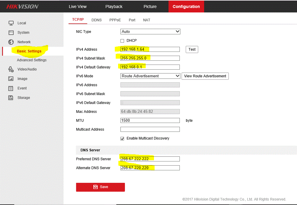

'/ipconfig all' fargment:
Ethernet adapter Ethernet:
Connection-specific DNS Suffix . : hsd1.il.comcast.net.
Description . . . . . . . . . . . : Qualcomm Atheros AR8161 PCI-E Gigabit Ethernet Controller (NDIS 6.30)
Physical Address. . . . . . . . . : 00-8C-FA-2B-30-C8
DHCP Enabled. . . . . . . . . . . : Yes
Autoconfiguration Enabled . . . . : Yes
Link-local IPv6 Address . . . . . : fe80::b06d:bed1:e864:198d%17(Preferred)
IPv4 Address. . . . . . . . . . . : 192.168.0.21(Preferred)
Subnet Mask . . . . . . . . . . . : 255.255.255.0
Lease Obtained. . . . . . . . . . : Thursday, February 1, 2018 10:27:48 PM
Lease Expires . . . . . . . . . . : Friday, February 2, 2018 10:29:05 PM
Default Gateway . . . . . . . . . : fe80::e298:61ff:fefb:2661%17
192.168.0.1
DHCP Server . . . . . . . . . . . : 192.168.0.1
DHCPv6 IAID . . . . . . . . . . . : 134253818
DHCPv6 Client DUID. . . . . . . . : 00-01-00-01-21-14-2A-6A-00-8C-FA-2B-30-C8
DNS Servers . . . . . . . . . . . : 208.67.222.222
208.67.220.220
NetBIOS over Tcpip. . . . . . . . : Enabled
camera diagnostic fragment:
