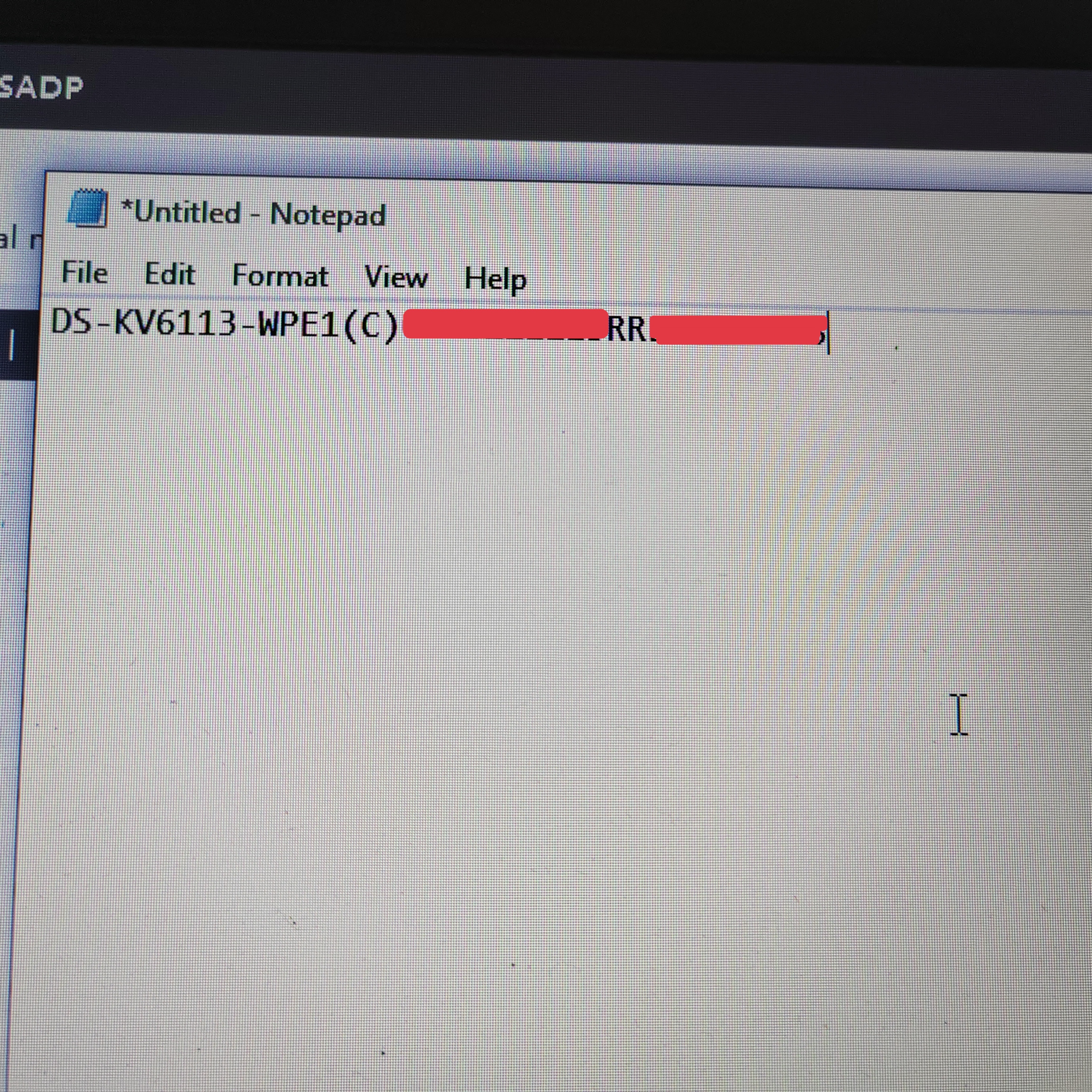

Hi there, thanks for the reply, yes it is the newest of this line, the C version... Whenever I try to upgrade it says "Upgrading Failed"
Can I ask what the serial number ends in... Mine consists of the serial number but has RR in it....?
Attached is my serial number...
Just to add success... I managed to upgrade it...
