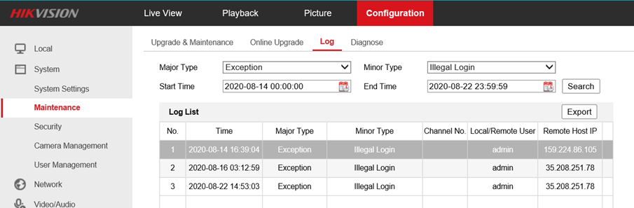

The problem happens every time after somebody tries to make a remote login using the admin username. Immedately after that the following starts happening:
Host Name for 35.208.251.78
Host Name: 78.251.208.35.bc.googleusercontent.com
Any idea how can I block such illegal login attempts? Does it help to change the default ports on the NVR? If so, then which ones? Any other ideas on how to block 'em from accessing my NVR? Could I block some specific ports in the TP Link router firewall? It is getting really annoying that some mom's hacker is just scanning the network for NVR's to attempt to access. Any other ideas on securing the network are very warmly welcomed.
Thanks!
Alex
- the continuous recording stops
- the cameras, connected to the NVR, continue to register the motion detection alarms, that are visible in Logs
- the NVR becomes unavailable via iVMS-4500 on my Android phone
- The whole setup gets back to life only after button restart on the NVR.
Thanks!
Alex
