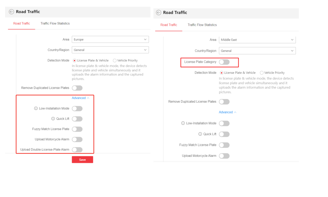

I know its quite an old post, but this might help with new firmware 5.8.60 having motorcycle alarm?
here is the link to complete release note and firmware download:
Cheers
Thanks trempa92, it's been a while since you posted that suggestion. I basically worked out the best way of obtaining motorcycle (or indeed any moving action) was to forgo trying to use the live 'analyze view' on the HIK web interface and now record Events which don't have much dead time between them and grab motorcycle plates from the short videos.
Regarding the new firmware and the function to upload a motorcycle alarm I am trying to see if this could be something i could use so thanks for that as i hadn't spotted that update as I was just using the HIK UK portal and not the global one which host different 'current' versions for whatever reason that may be.
Cheers. Sean
