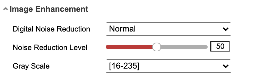

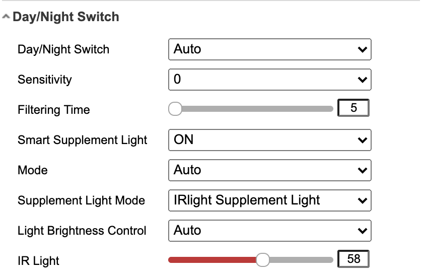

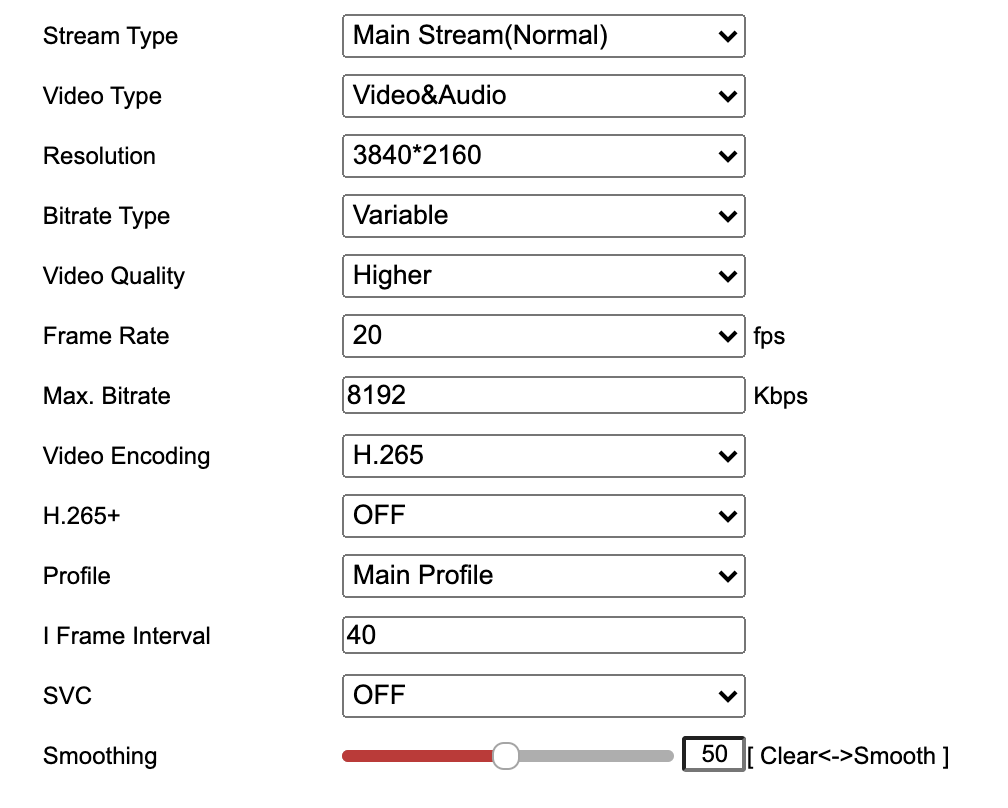

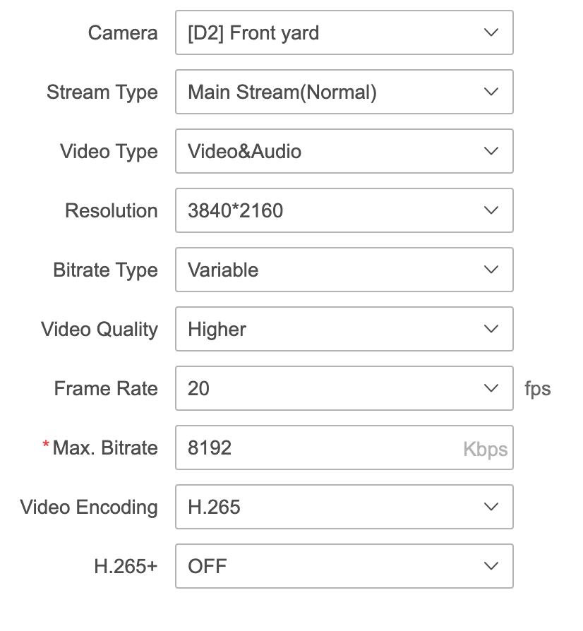

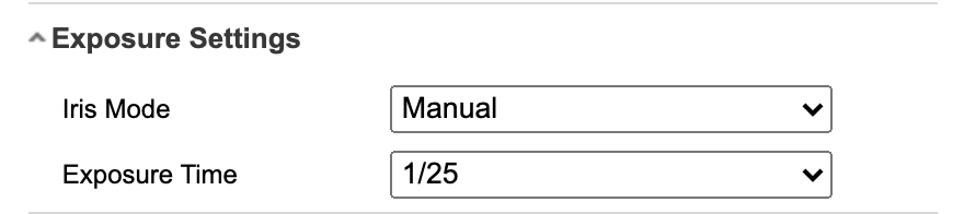

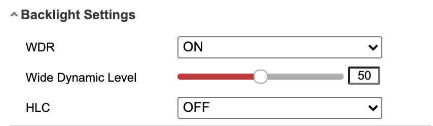

It's been about 3 months with a pair of DS-2CD2386G2-ISU/SL cameras. Overall they're great, but I'm having trouble getting the best out of them. NVR is an I-series 8ch. I have four cameras running, 2x 2386 & 2x 2346G2.
I'm experiencing the following:
- Stop/start play back — Rewatching recordings via the app on either WiFi or 4G - it's glitchy (DS-2CD2347G2-LU are slightly better in this regard)
- Day time motion — subjects appear to have doubled e.g. two heads, two dogs lol
- Night time motion — lots of ghosting (camera is set to switch to IR based on light, although we have a street lamp right outside the house (it's currently broken)
- This street light would ideally help with the ghosting.
I guess where i'm getting at is if there are certain settings that need to be tinkered with to mitigate these issues? I understand each environment is different, but I know that these cameras are capable. I'm thinking long-term plan is to replace the 2386 with 2347's.
Current settings:
NVR:
Camera:
Could anyone chime in? Any help is appreciated!
