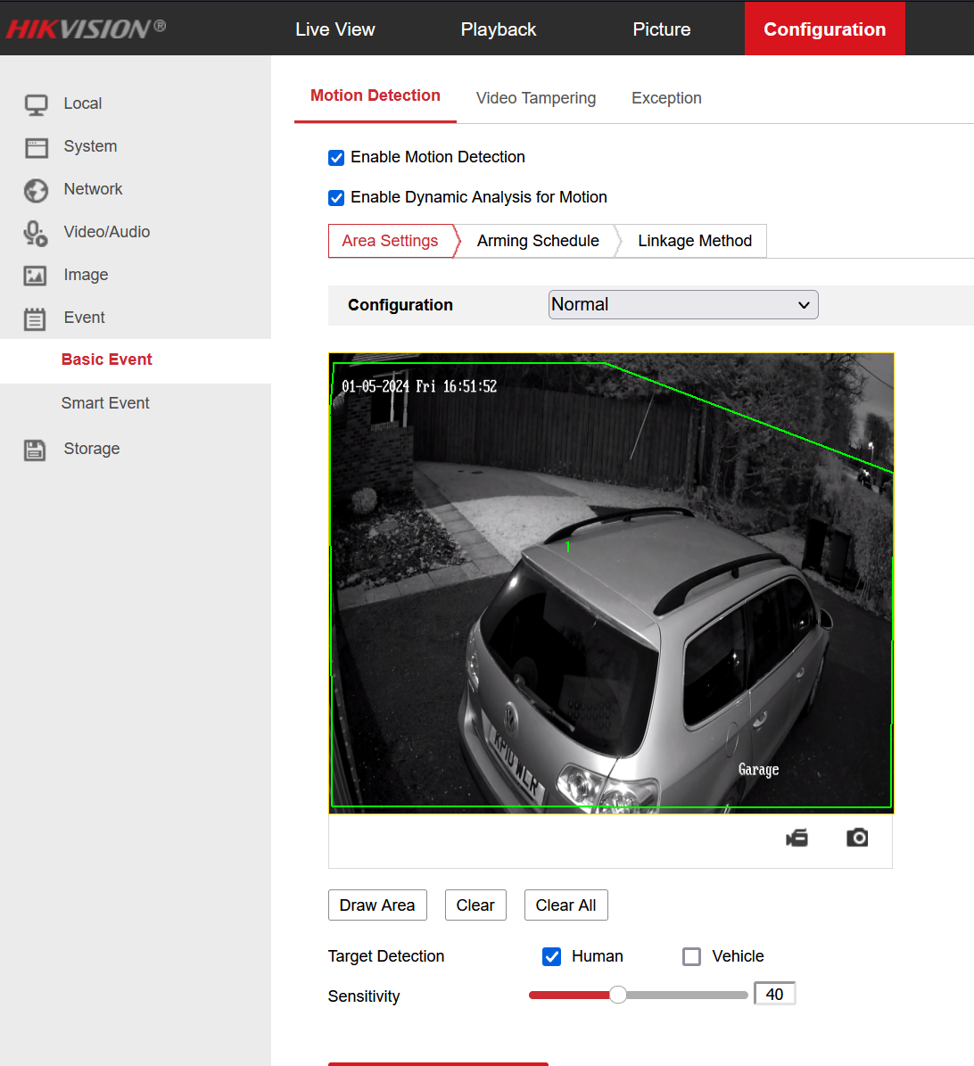

Really hoping I've done something stupid configuration-wise with my DS-2CD2346G2 - updated to the latest firmware.
I'm trying to get it to record (locally, no NVR) in response to ONLY humans & vehicles. See config screenshot below.
Originally, I had checked boxes for Human + Vehicle but the camera was still recording nearly everything e.g. reflections occurring in the windows of my parked car or headlights sweeping into the drive.
'Ok' I thought, it's clearly treating any movement on, or close to my parked car as a moving vehicle and therefore causing alarm events. I'll change it "human" only. Still, I get the same problem and there's nothing close to "human" in the scene. See
for a video of what it records configured per screenshot.
I'm very much hoping I've missed some configuration, otherwise this is garbage in terms of use - which is annoying as it was the main reason for spending on a more expensive camera!

@jfh82 The motion detection is very sensitive. You can safely drop it to 20. But more importantly...
Redraw your motion area so that the diagonal line cuts just below the top of the hedge. If I zoom in on your image to the area just above the bins I can see the road outside your property and there is enough within the area you've outlined that if someone walked down the road passed the parked car it could trigger - you'd be surprised just how sensitive it is.
