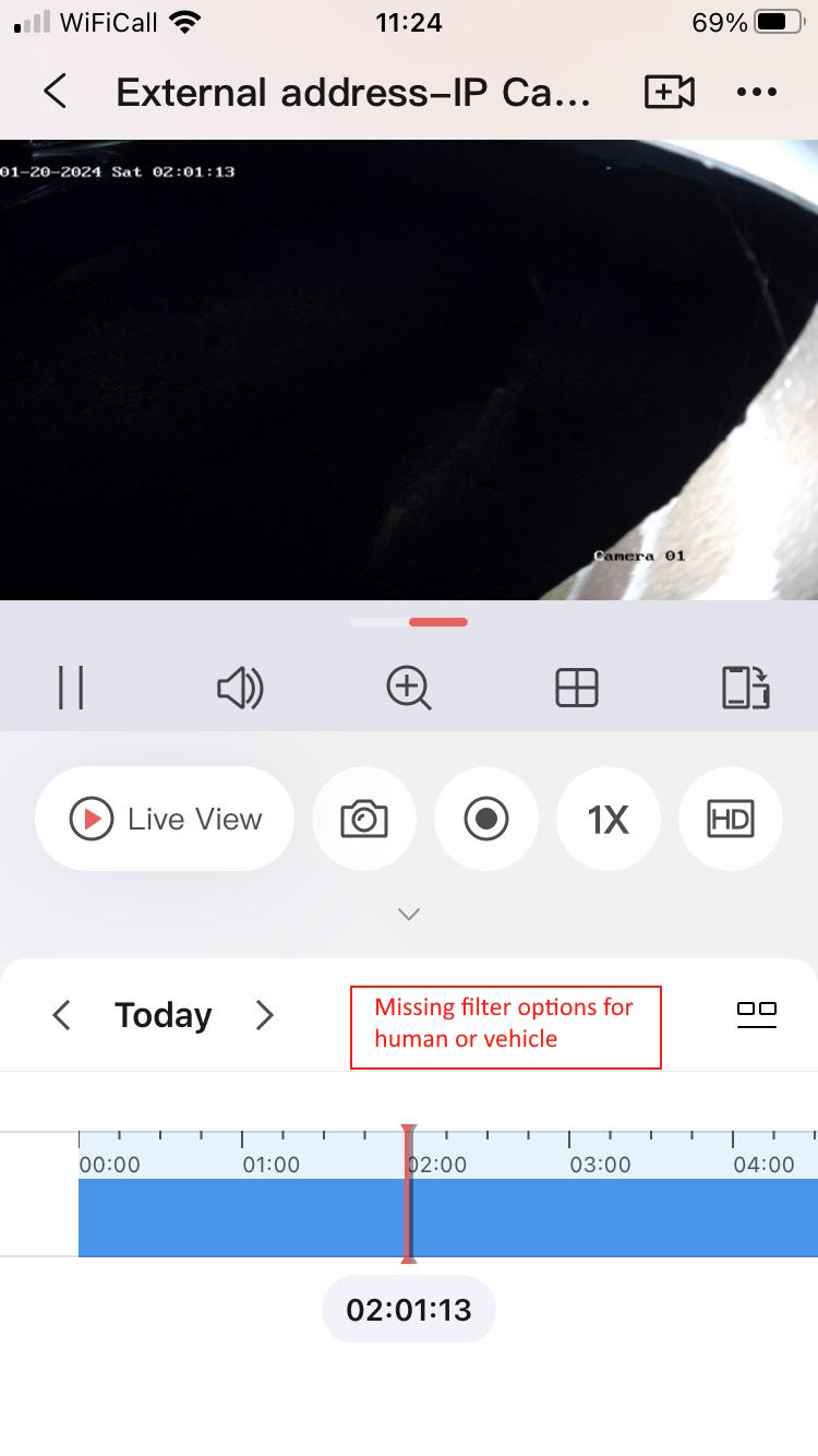

ps. attached image is of the ColorVu camera at night where you can see that the orientation and white light renders it useless at night (hence why I want to turn down/off the white light at night). It also doesnt show any options to filter by human or vehicle.
