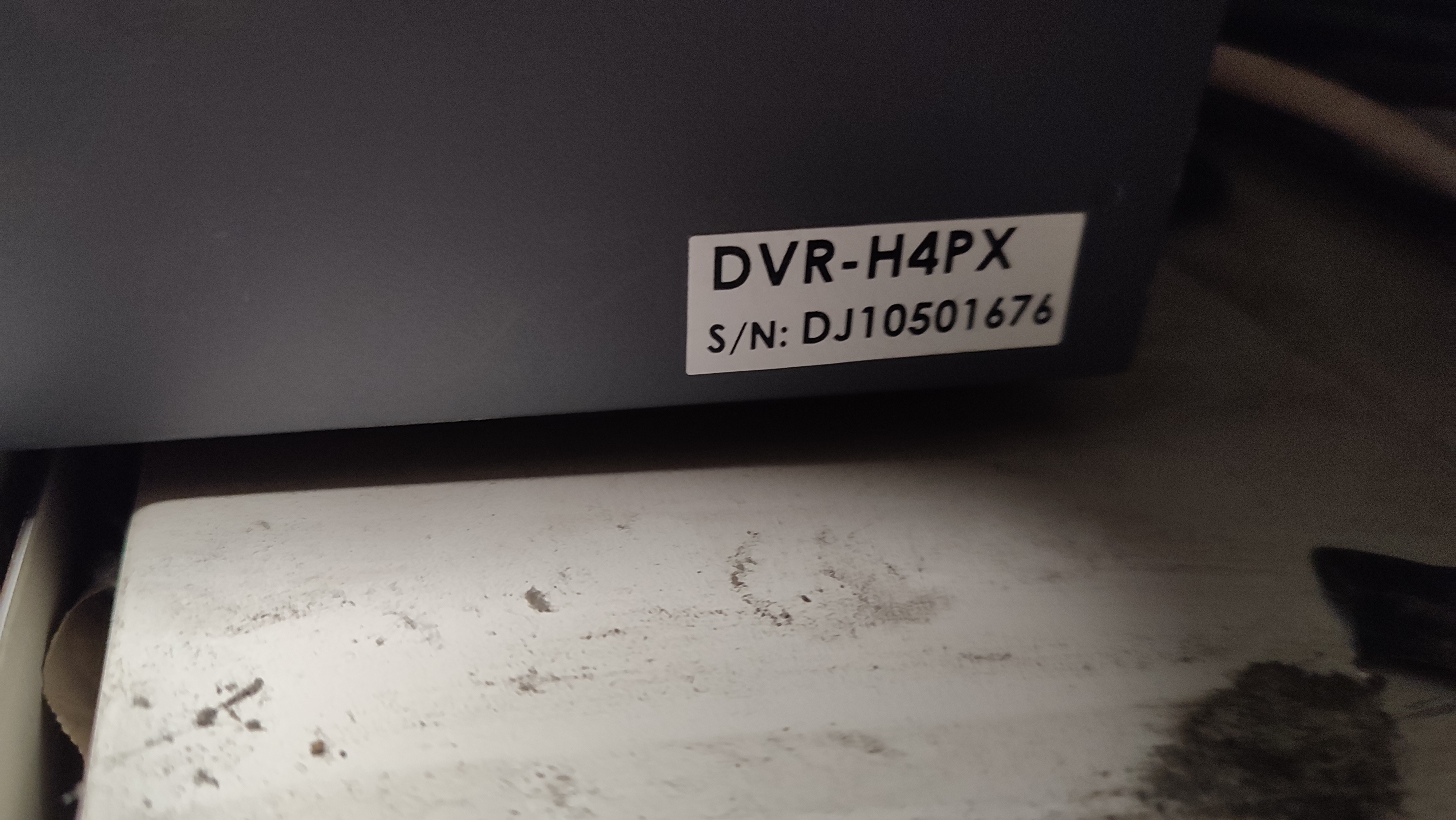

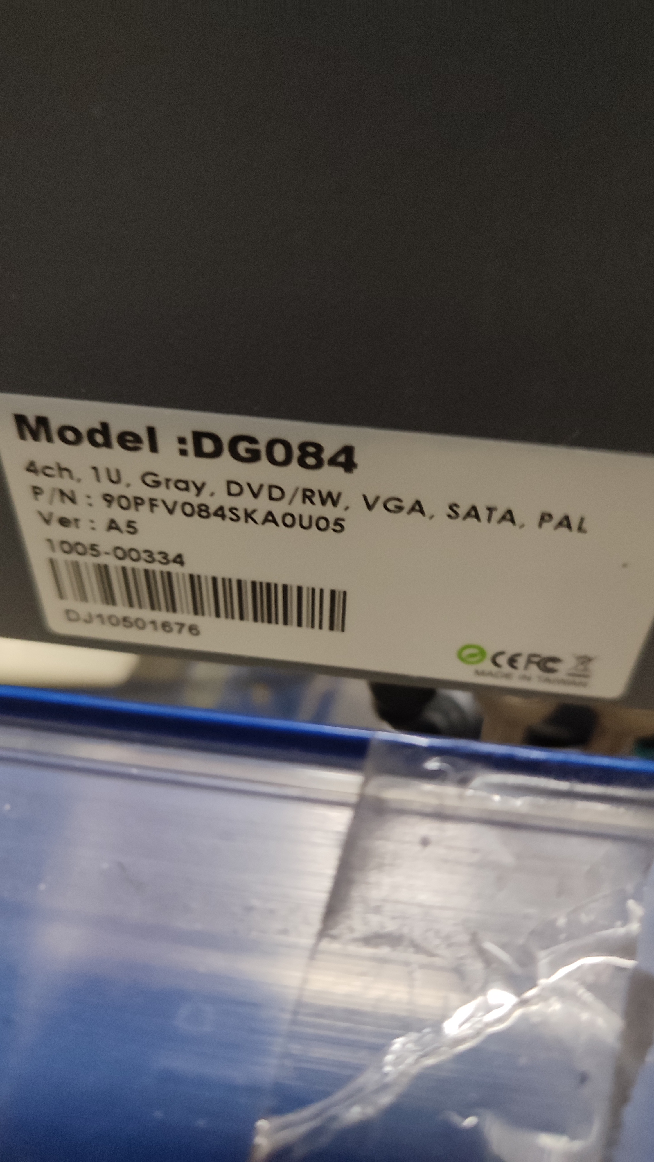

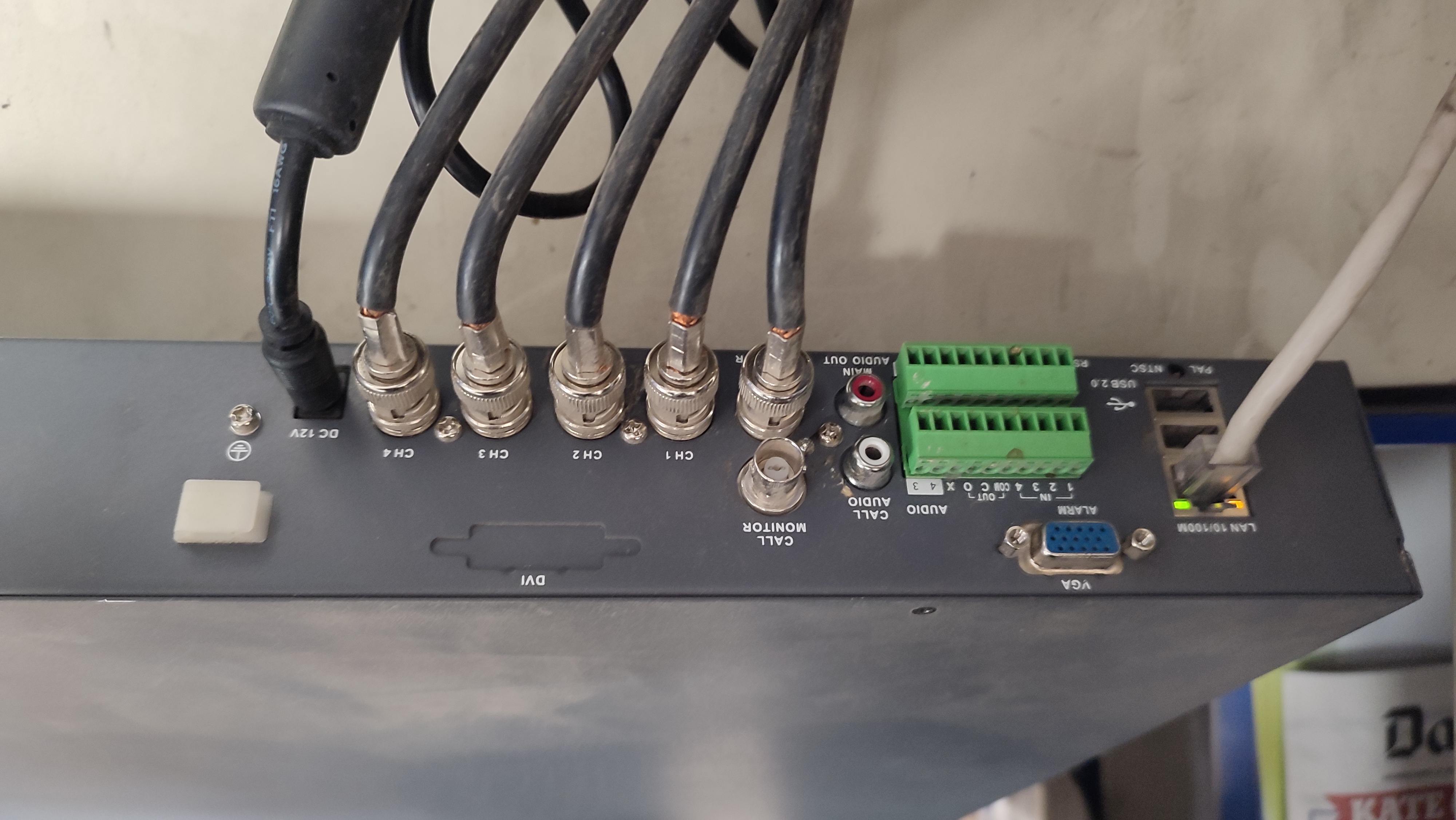

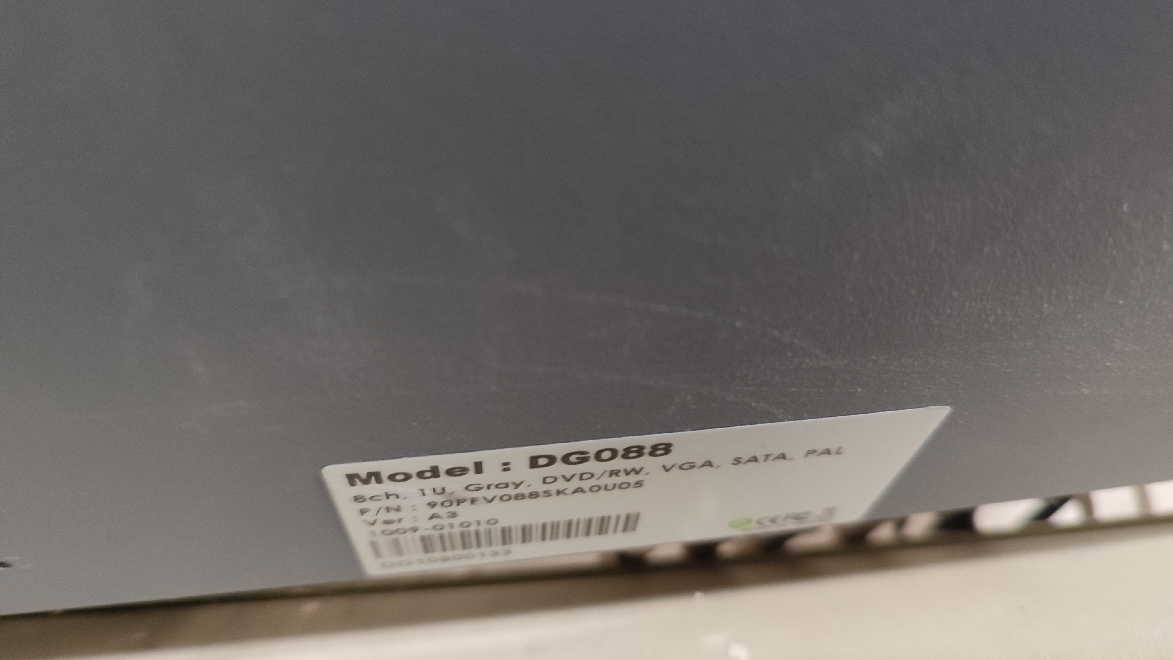

Hi David,
Thanks for the prompt reply. I have attached the pictures of all the sides.
I have the administrator username and password. Router is from Virgin media and the model number is vmdg505. DVR is connected to the router using LAN cable. Yes, the cameras are directly connected to DVR and I am using windows. However, I don't have any PC connected to DVR.
Hope this would help.
Thanks for your help once again.

Hi David,
