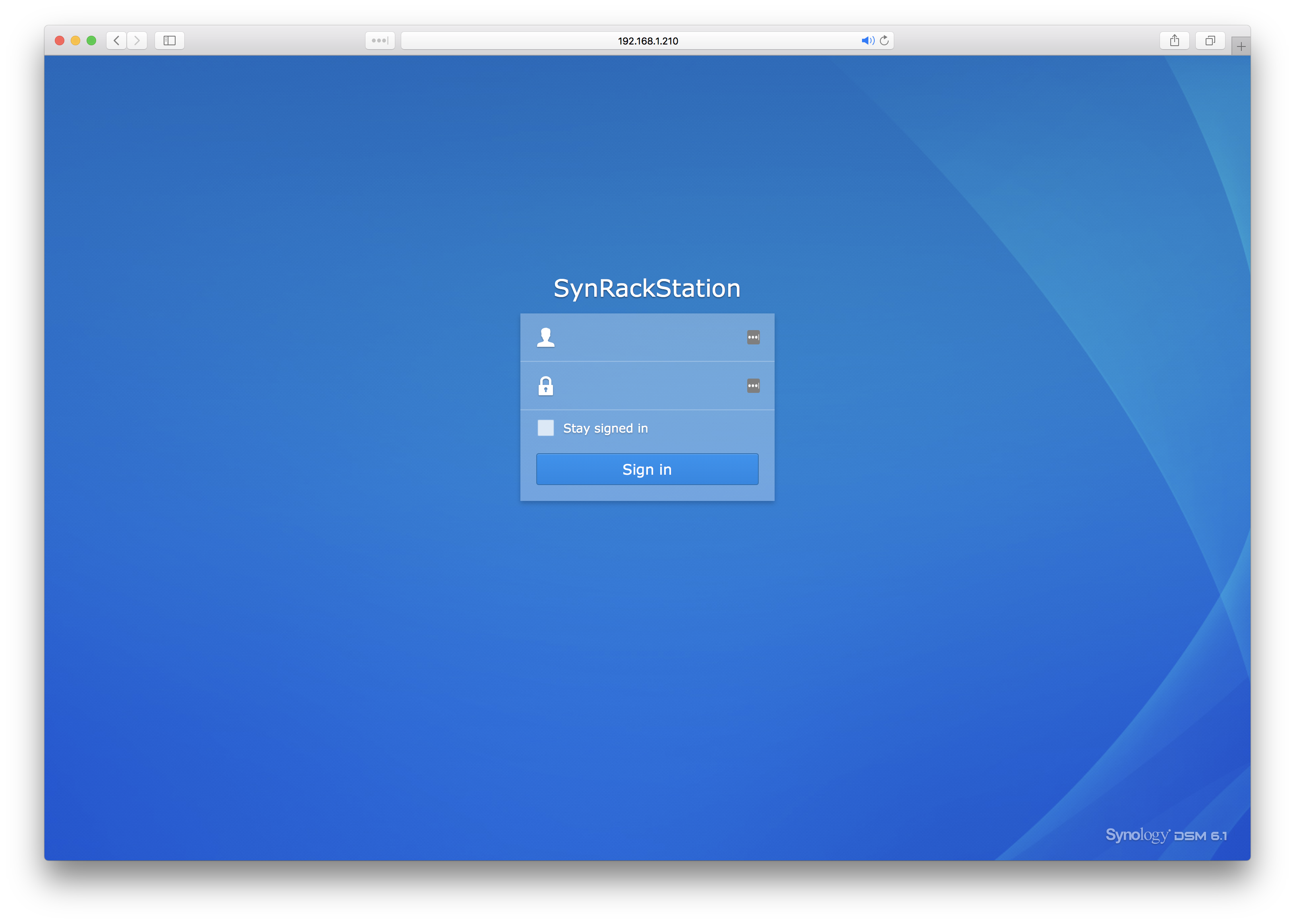

Step 1: Login to your Synology NAS via a browser​

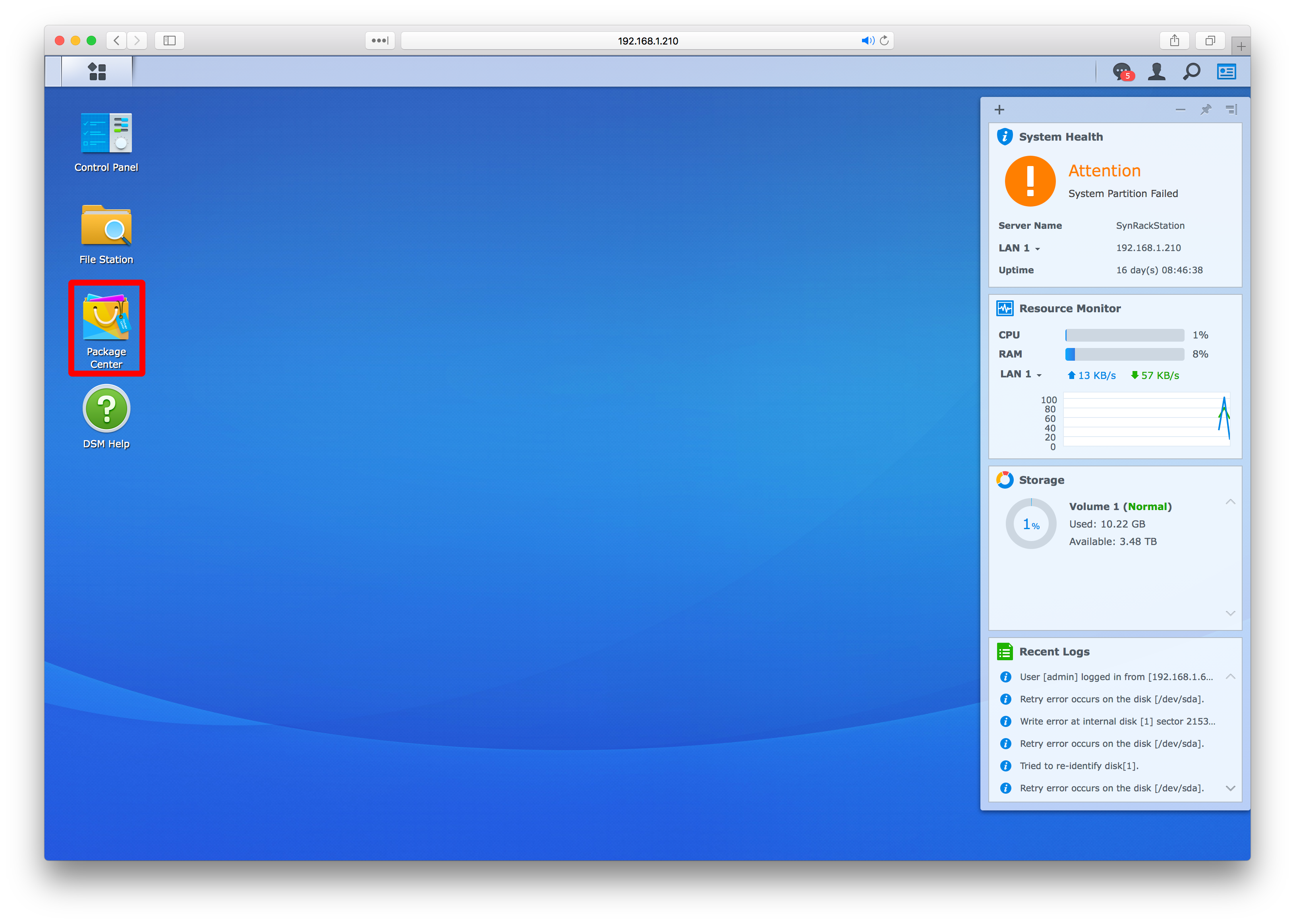

Step 2: Click the Package Center icon​

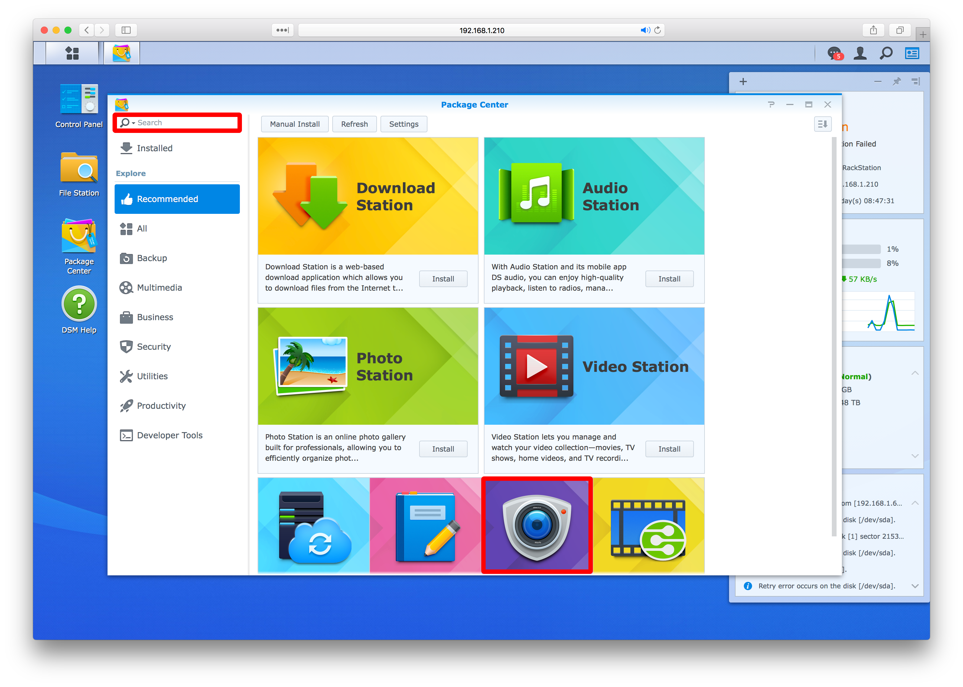

Step 3: Search for and install the Surveillance Station software (it should be on the home page of the package center, if not you can use the search bar to find it)​

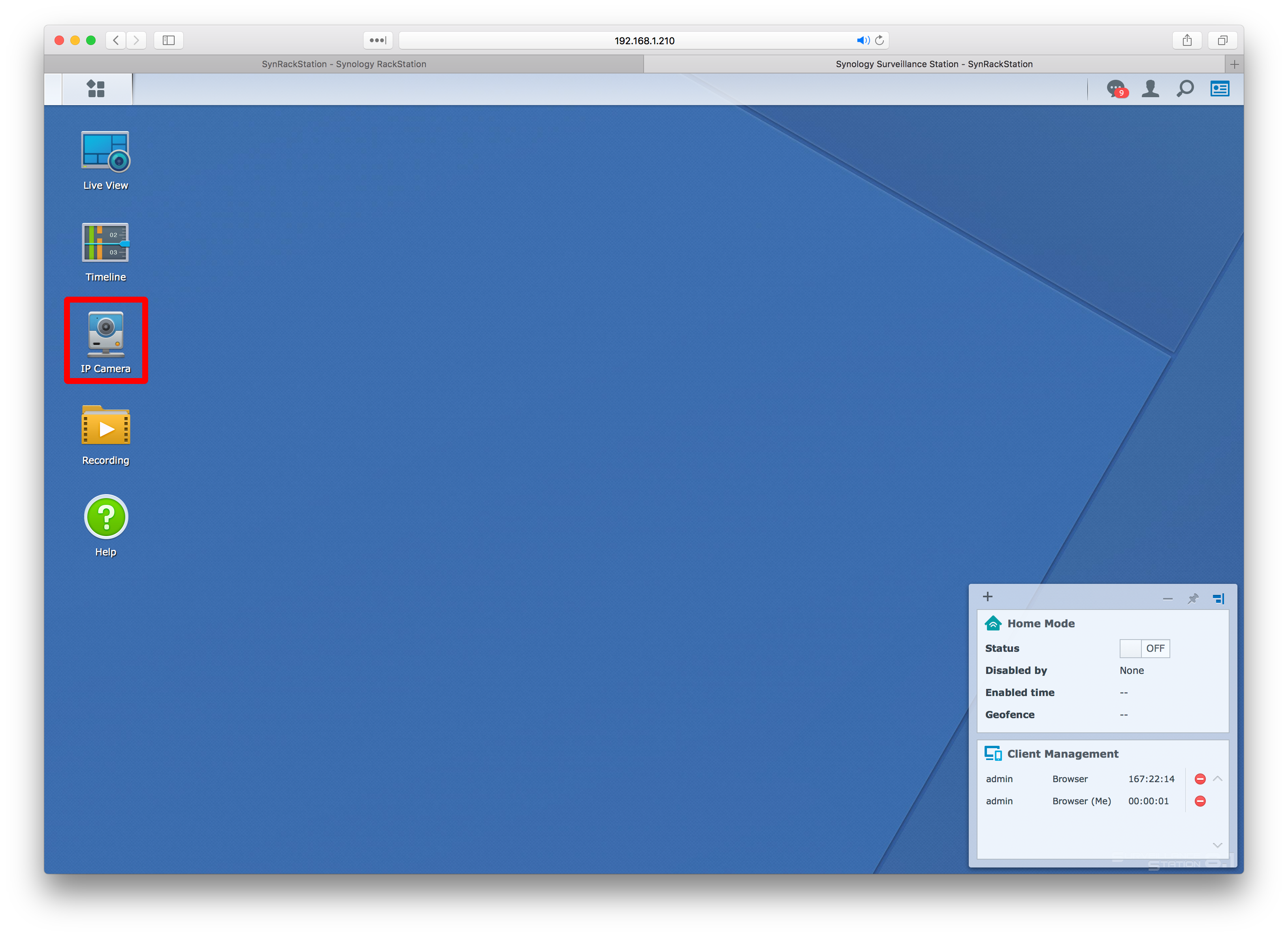

Step 5: Click the IP Camera icon​

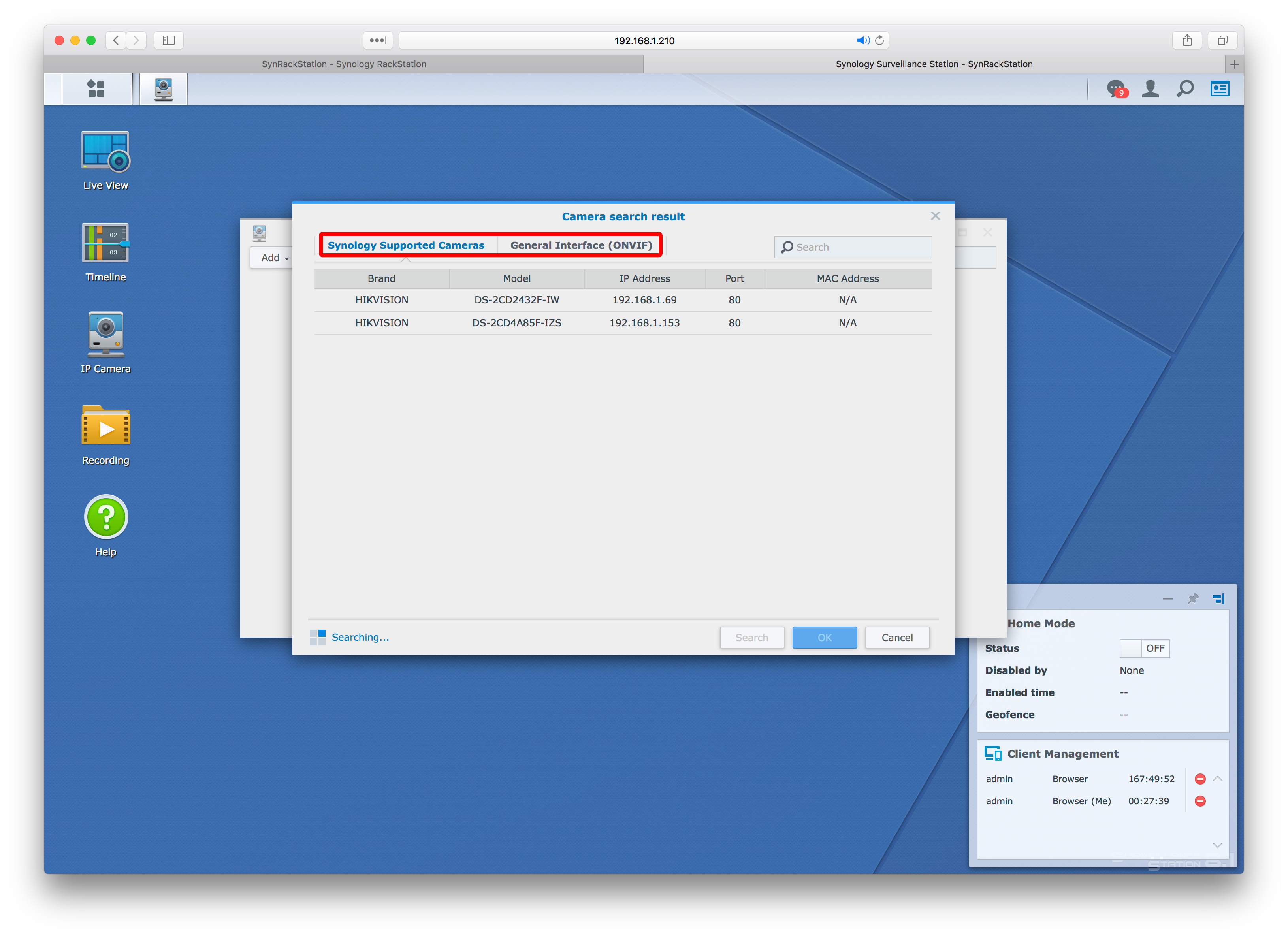

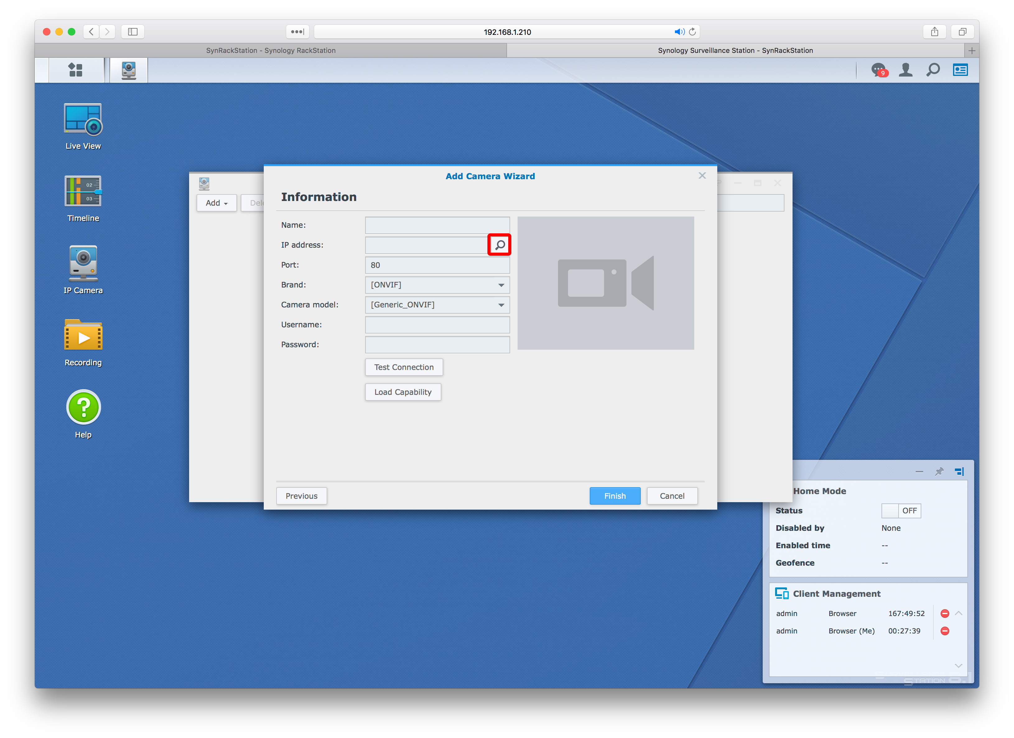

Step 8: Enter the camera details manually or click the Search icon next the IP Address box​

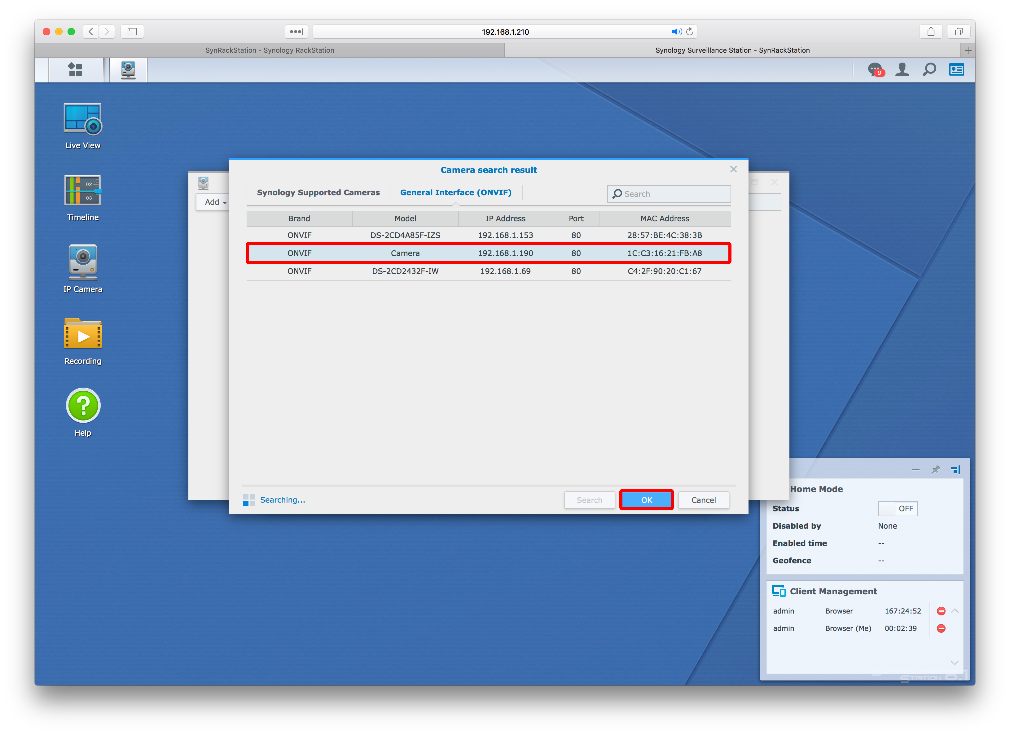

Step 9: Check both the Synology Supported Cameras and ONVIF lists (some camera models are not directly supported by Synology, but as long as the camera is ONVIF compliant you should be able to add it to the Surveillance Station software)​
Step 10: Select the camera you want to add from one of the lists and click OK

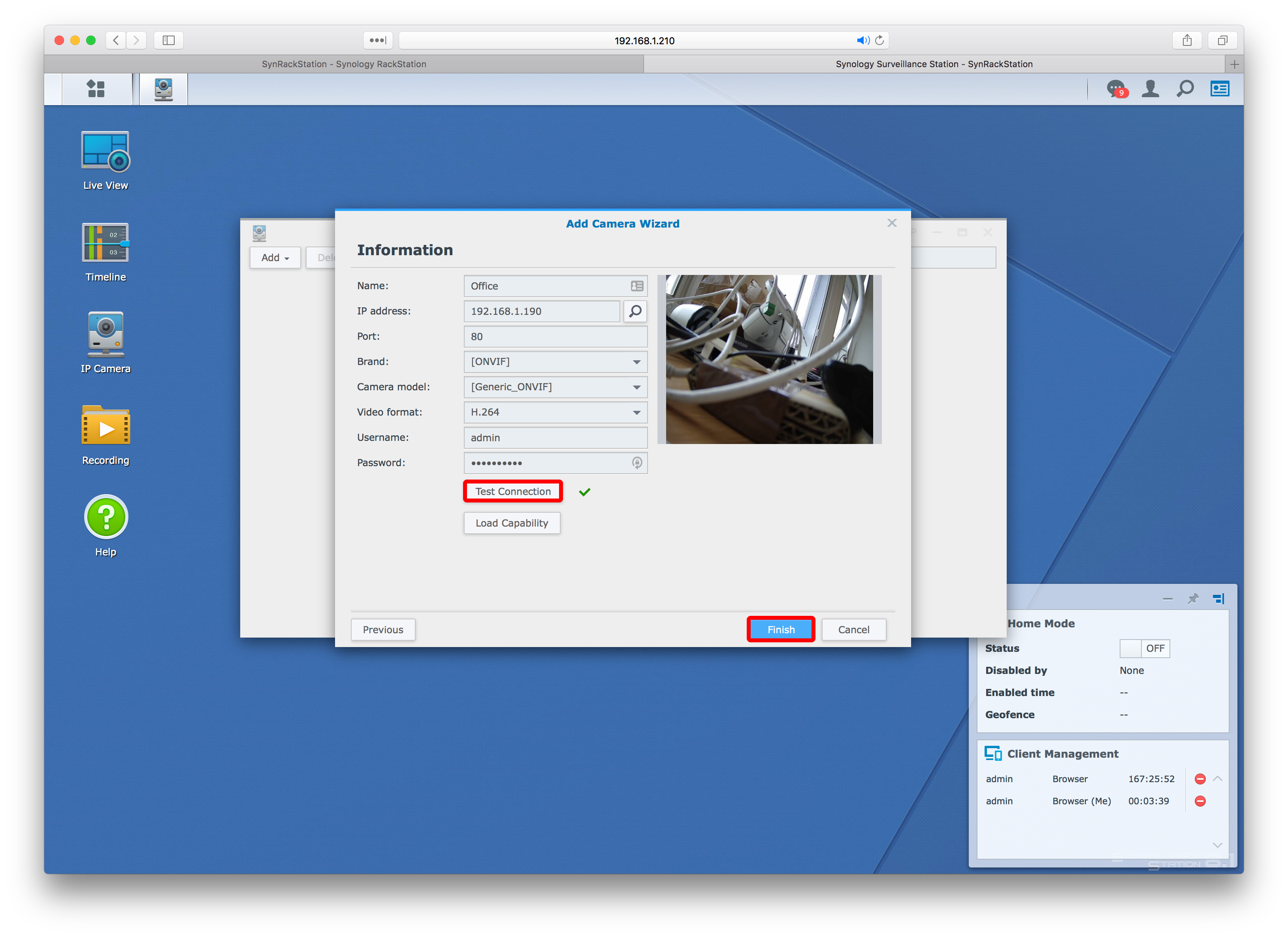

Step 11: Check that all the camera details are filled in, including the cameras username & password (also give the camera a unique name to help you identify it from other cameras)​
Step 12: Click the Test Connection button and if the test is successful you'll get a green tick and a live shot from the camera, you can then click Finish and the camera will be added to your Synology NAS​
If the test is not successful you will have to go back and check the camera's settings are correct, the most common problem is that the camera has an IP address that is not on your network, after you have followed our instructions from a previous video on how to change the IP address you should get a successful connection and be able to add the camera
