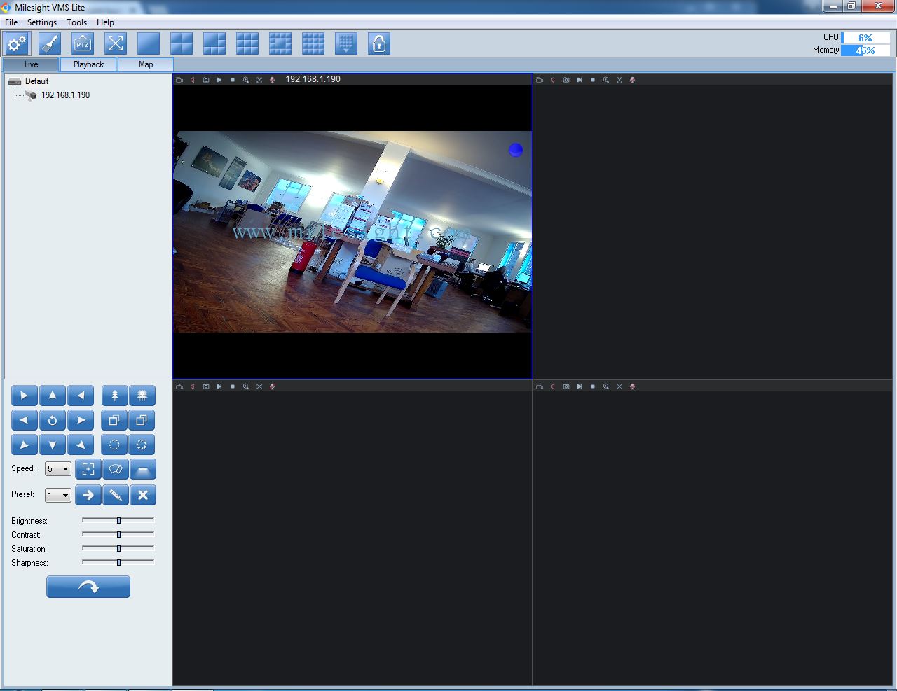

Step 4: Login to the VMS software (both VMS Lite & Pro come with their username & password set to the default - user: admin / password: password)
After logging in to the software we would recommend changing the default username & password to something unique to you, this then keeps the software secure

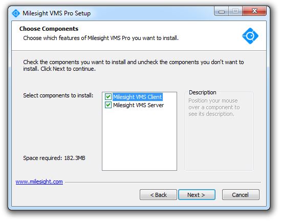

That brings us nicely on to VMS Pro, VMS Pro has a very similar structure to Lite, the main difference being that Pro comes in 2 parts, server software and client software, and you will be prompted during the installation process as to whether or not you want to install both the client & server or just one of them. If this is the beginning of your VMS Pro system you will want to install both (see below)
The Server/Client structure of VMS Pro allows you to create a much larger IP camera network as you can install the server software on multiple servers/rack PCs/NAS devices and have groups of cameras storing their footage to different servers, and the Client software can then be used multiple PCs to access all the storage devices with the server software installed, thus allowing you access to a much larger network of cameras (up to 256 cameras) than is possible with VMS Lite which can only store footage locally to the PC you have it installed on.

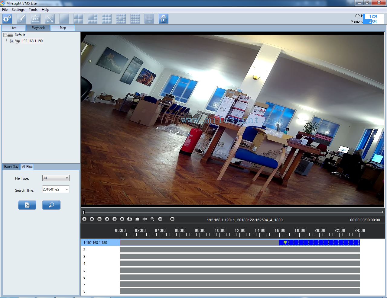

And finally, a feature of both VMS Lite and VMS Pro that you should be aware of is that although both versions of the software are free you will still need to activate the software with an activation code (which you can get from use-IP - see bottom of this post for more information on how to do this), if you don't activate the software the live view and recorded files created by the software will be stamped with a Milesight watermark. (see below)
