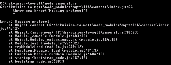

What is wrong? Is your script works with current nodeJS version?
