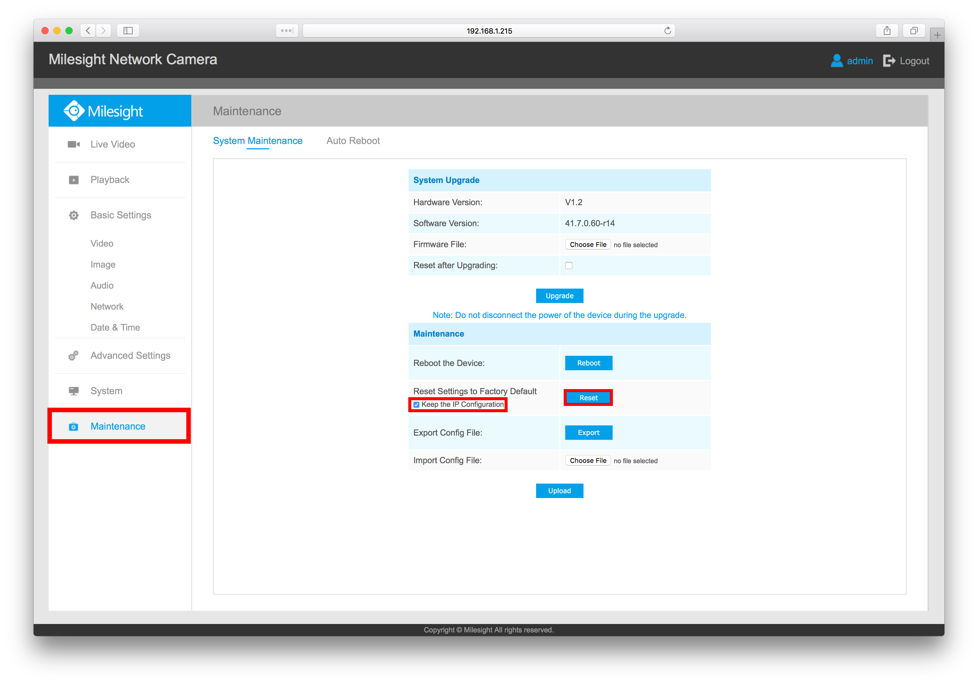

Factory Reset using a Browser
If you are having problems with your camera but are still able to login to the camera then you can reset or factory reset the camera from its settings using a browser.
All you have to do is log in to the camera and click Configuration, you can then click the Maintenance tab from the back-end menu and you will be taken to a page like the one below
On this page you will see a table labeled Maintenance with 3 buttons, the 2nd of these buttons is labeled Reset, clicking this will reset the camera's settings to factory default. If you want to completely factory reset the camera (e.g. change the IP address back to the factory default - 192.168.5.190) you will need to untick the box marked Keep the IP Configuration before you click the reset button, a couple of minutes after you click the reset button the camera should reboot and reappear on your network.
