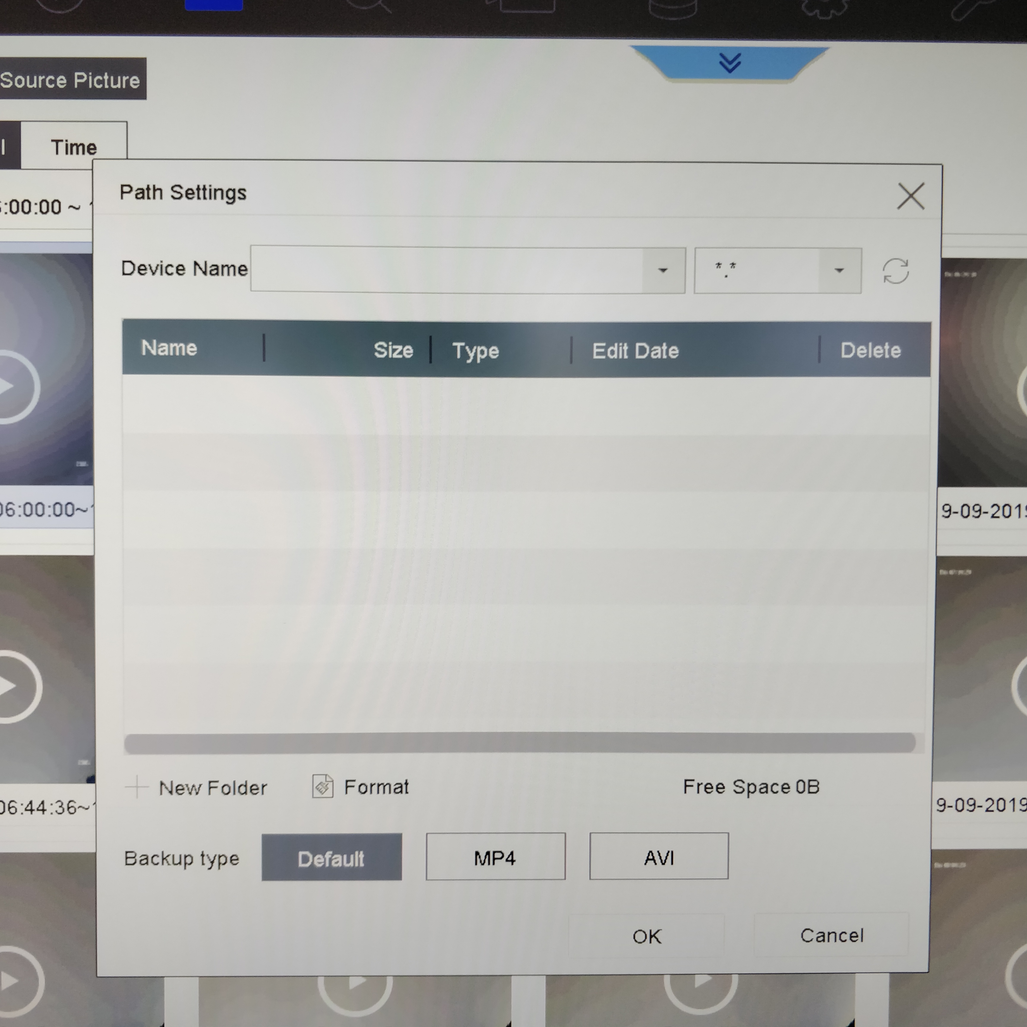

Step 8: Select your storage device from the drop-down
If it is a brand new storage device we would recommend clicking Format just to make sure the device is using the partitioning that Hikvison likes, if it is an older drive with files already on it you can try exporting as is but you may be prompted that the partitioning is incorrect and will have to format to complete the Export. Also on this pop-up, you can create a new folder if you want to keep your files organised and select the file format you want the footage exported as. (default will export the files in the format they are saved as on the NVR which by default is usually .avi)
Once all these settings are in place you can click OK and the Export will begin.

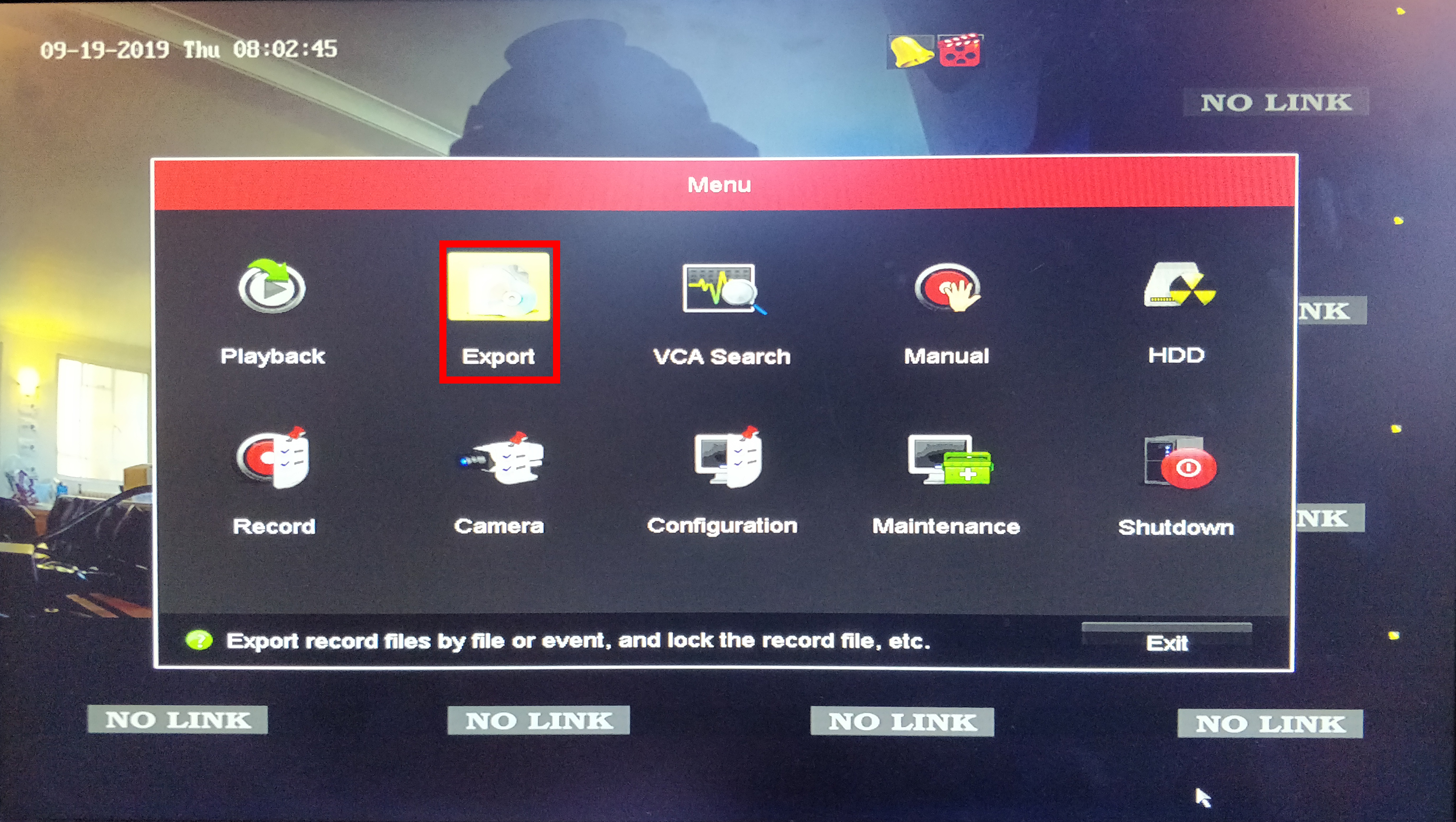

K-series

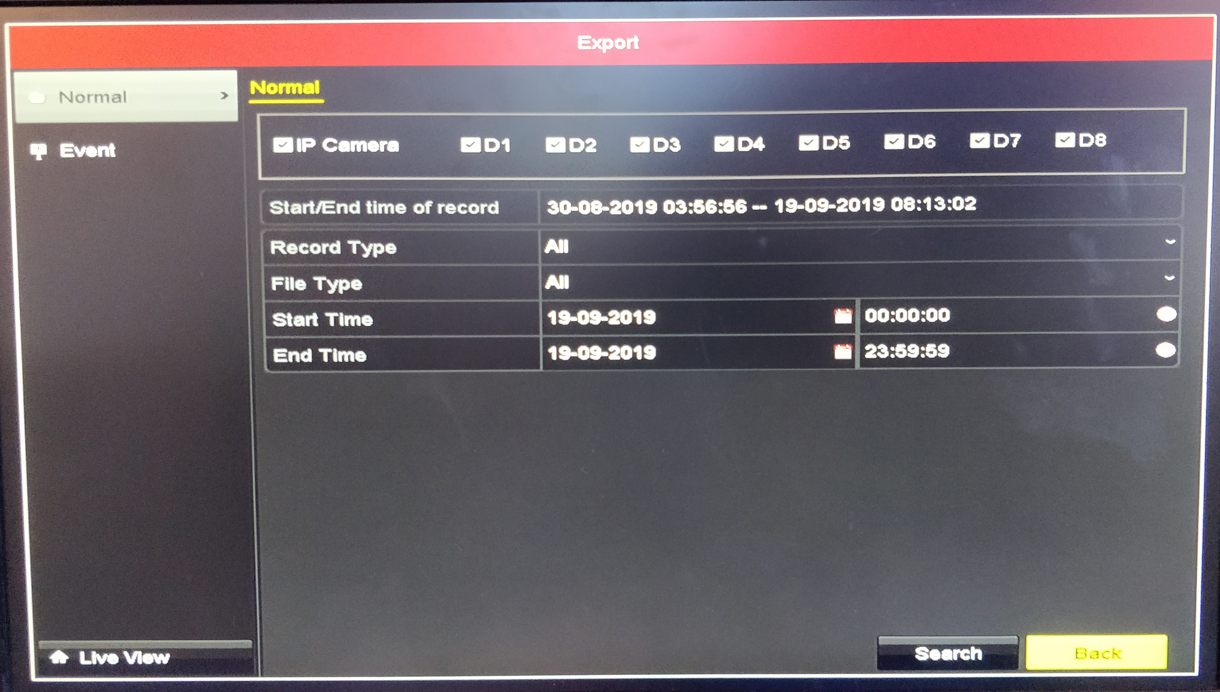

For the K-series NVR the process is similar but the menus are laid out slightly different, so instead of file management you will see a dedicated Export menu (see below) which will take you to a similar search page but on the K-series the search is split into 2 pages - Normal and Event.
Normal Export will let you search by how you had your recording schedule set, so if you had it set to continuous from 09:00 to 17:00 then you can select continuous as the record type and just be shown files from when you had continuous recording set within your chosen search window. (e.g. last 7 days) If you select All as the record type you will be shown all the recorded files within your search window, whether they be continuous, motion, event, or one of the other options.

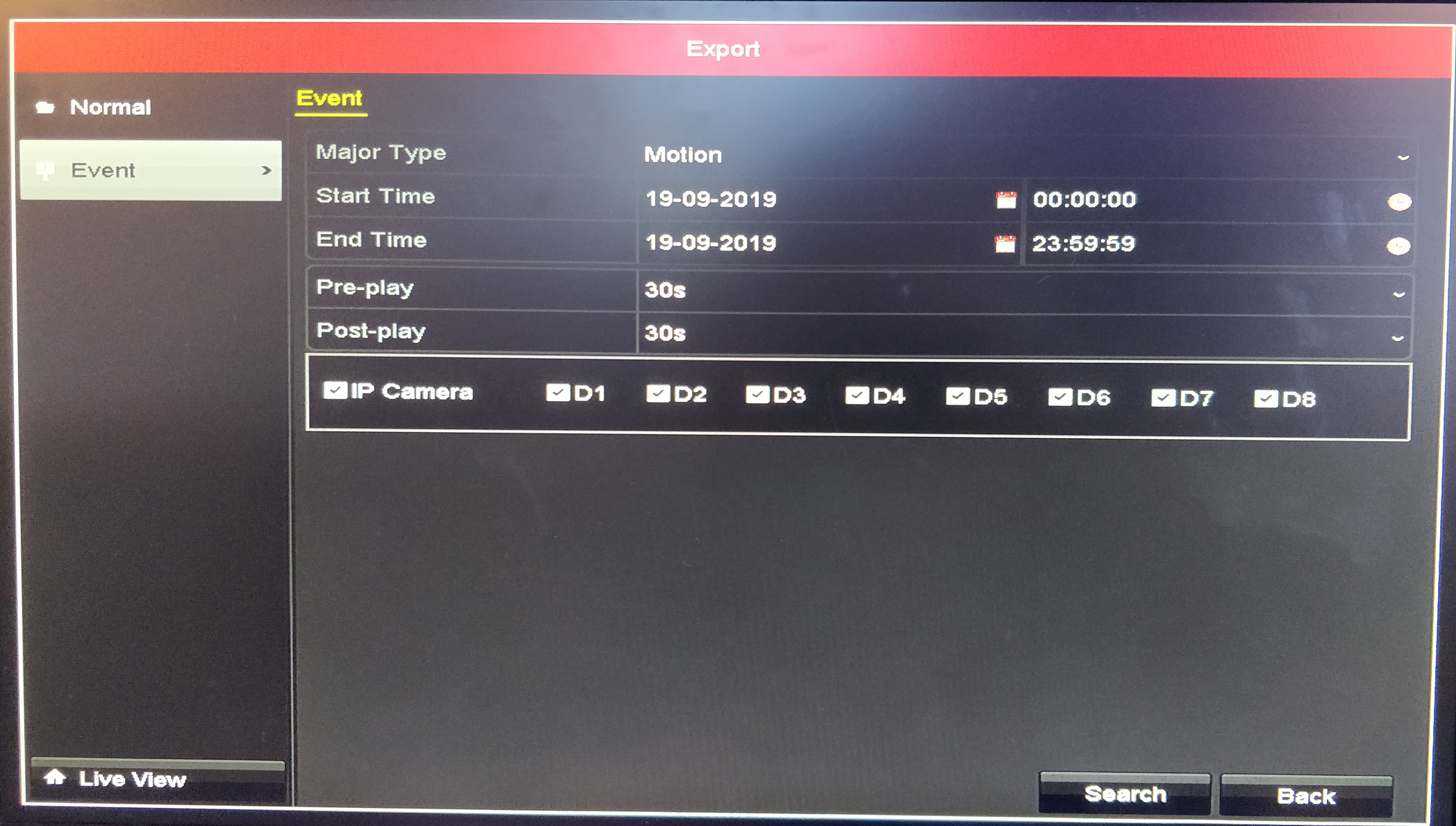

Event Export is like the Event Type drop-down on the I-series NVR and lets you search for Event triggers of any Smart Event that you have enabled on your cameras.
After you have set the parameters and clicked search the menus and steps after are pretty much the same as the I-series NVRs, select your files, click Export, Select your Storage Device, select your Export Option (logs/Player), and then start your Export.
K-series
