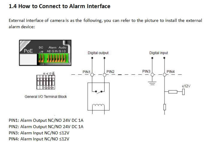

Dan Administrator Staff member Messages 4,366 Points 113 Nov 26, 2018 #1 Milesight have shared the below diagram of how to wire an external alarm device to a Milesight camera: Last edited by a moderator: Nov 29, 2018
