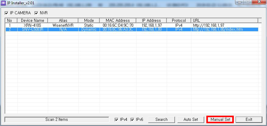

Step 2: Open the IP Installer Tool and select the Wisenet camera from the list and then click the Manual Set button

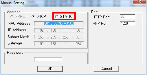

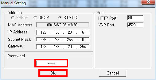

Step 3: When the 2nd window opens you will see all the details of the camera you selected, you will first want to click the Static tick box to allow you manually adjust the network details of the camera

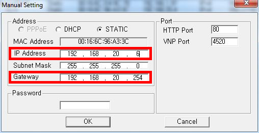

Step 4: Change both the cameras IP address and Gateway address to the same PoE segment as the Milesight NVR (e.g. IP - 192.168.20.6 / Gateway - 192.168.20.254)
Step 5: Enter the password for the camera and then click OK

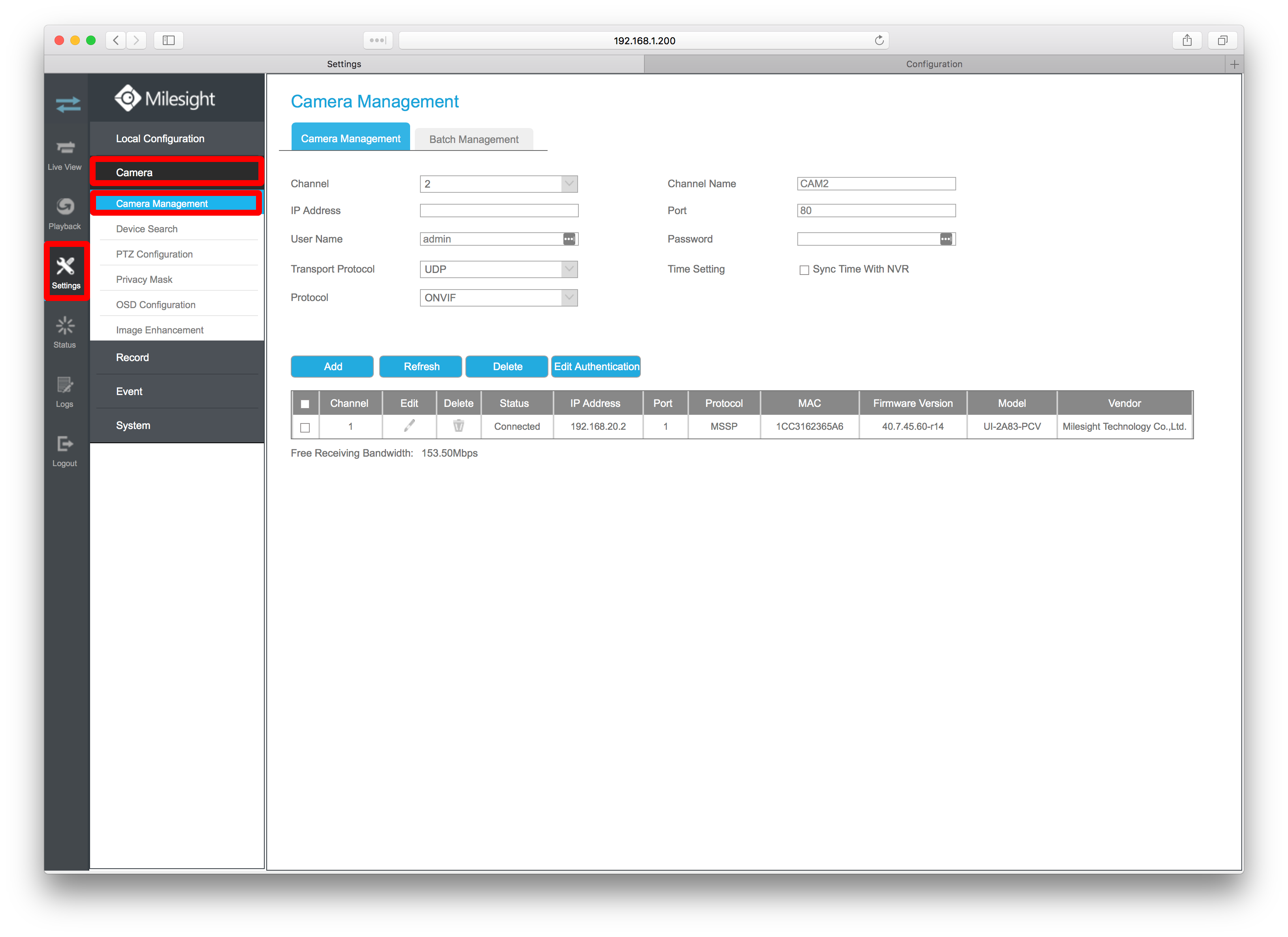

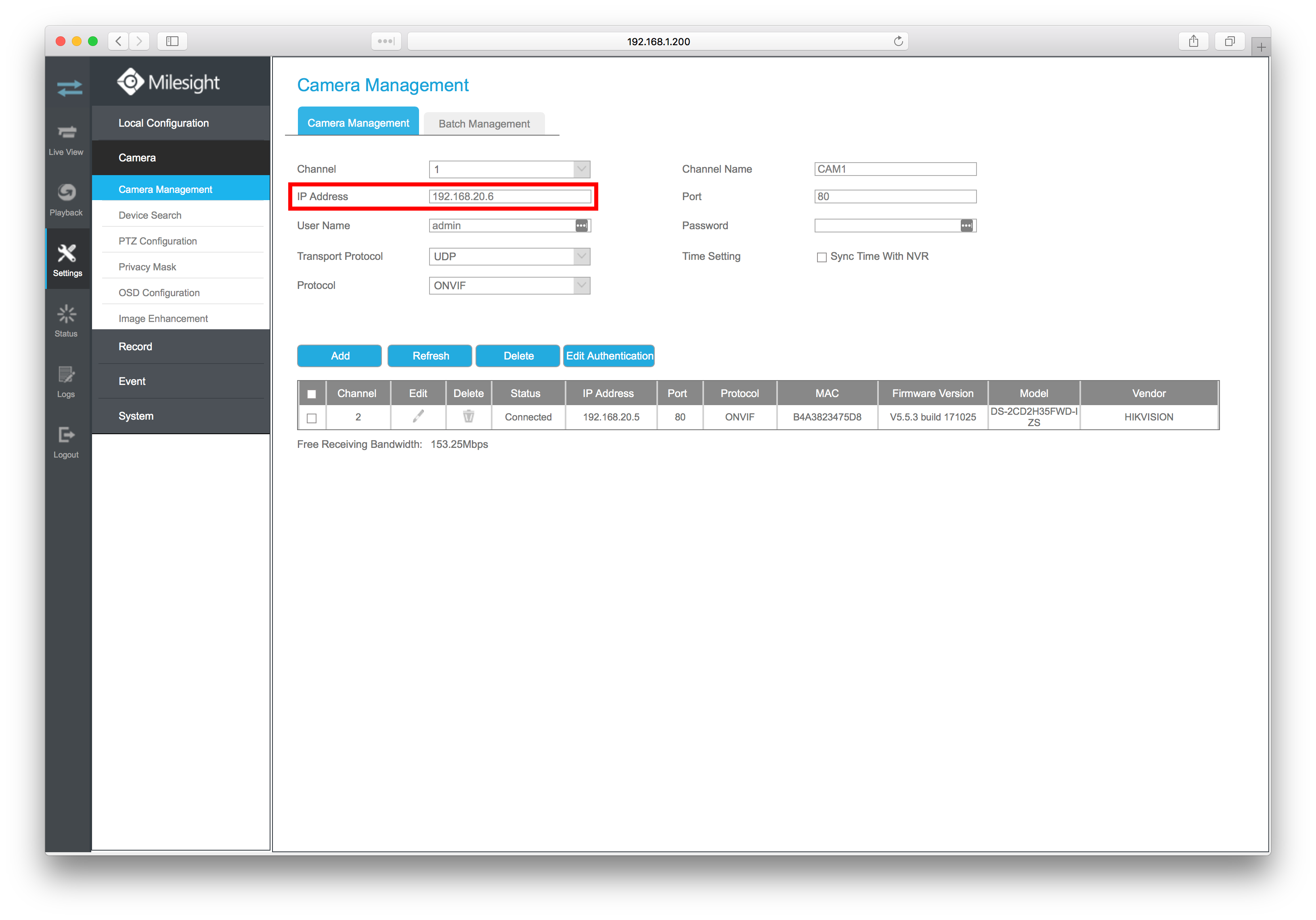

Step 7: Login to the Milesight NVR using a browser and click Settings and then click Camera from the menu, then select Camera Management from the drop-down

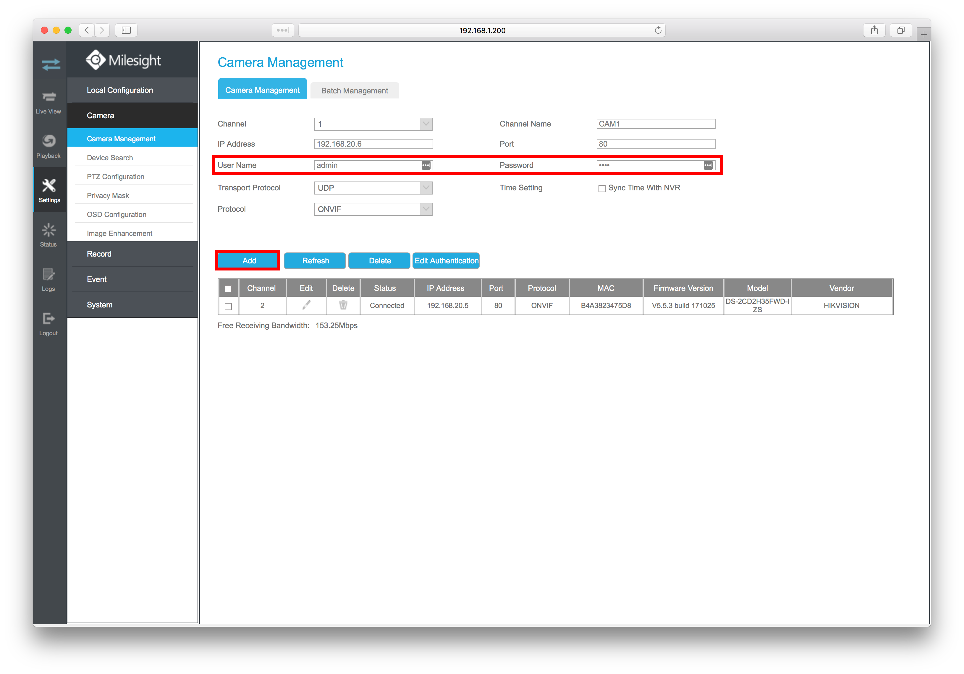

Step 8: Enter the cameras NEW segmented IP address (e.g. 192.168.20.6) into the box labeled IP Address
Step 9: Enter the username and password of the Wisenet camera and then click Add

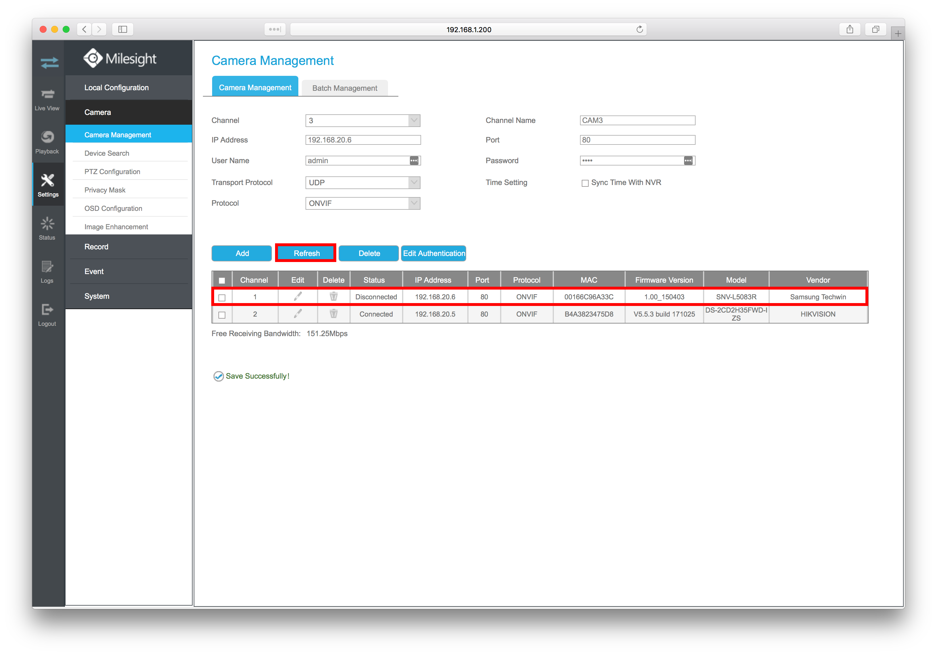

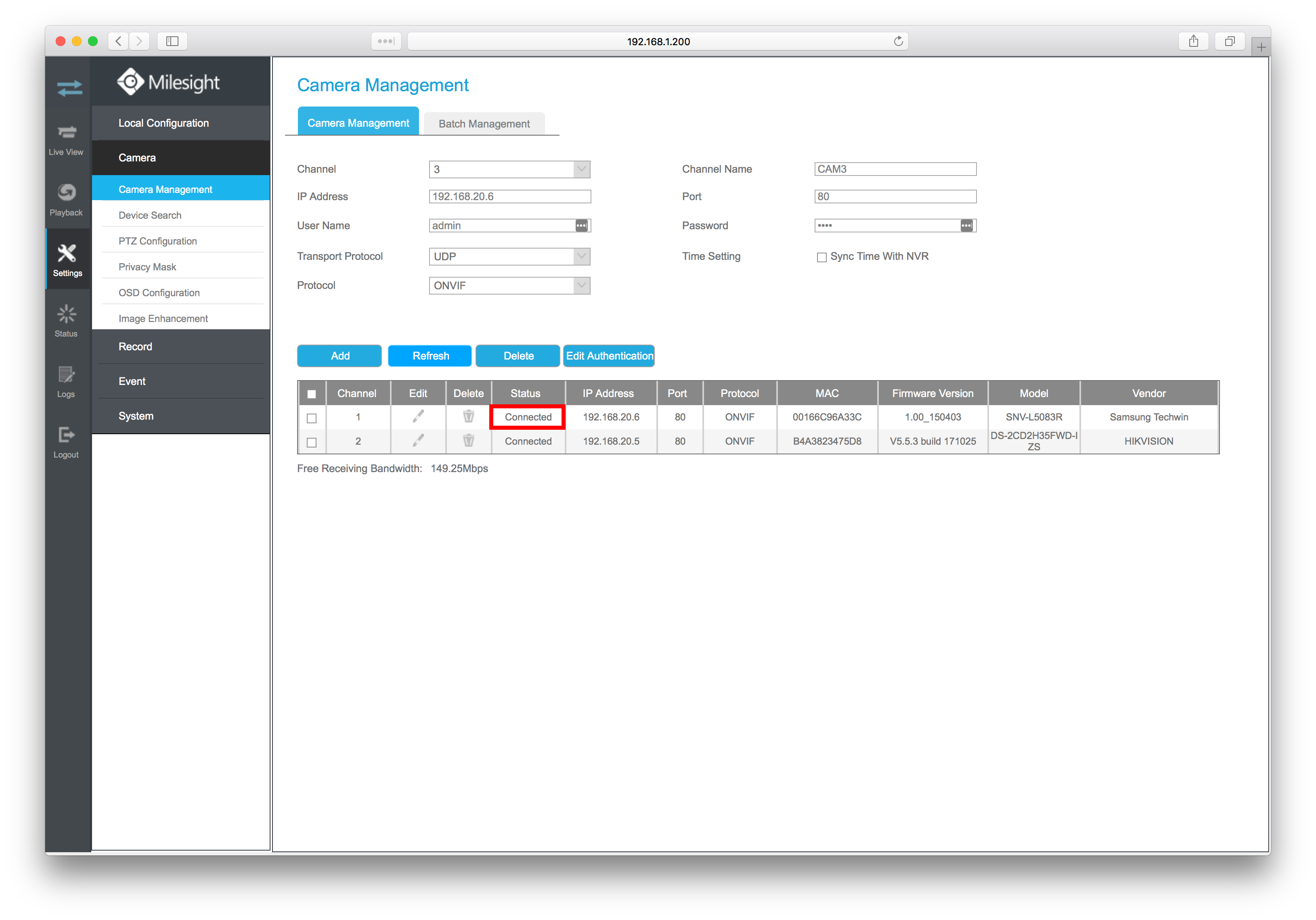

Step 10: If the camera appears on the list it is likely to say Disconnected, if so simply click the Refresh button and camera should reappear saying that it is now Connected
