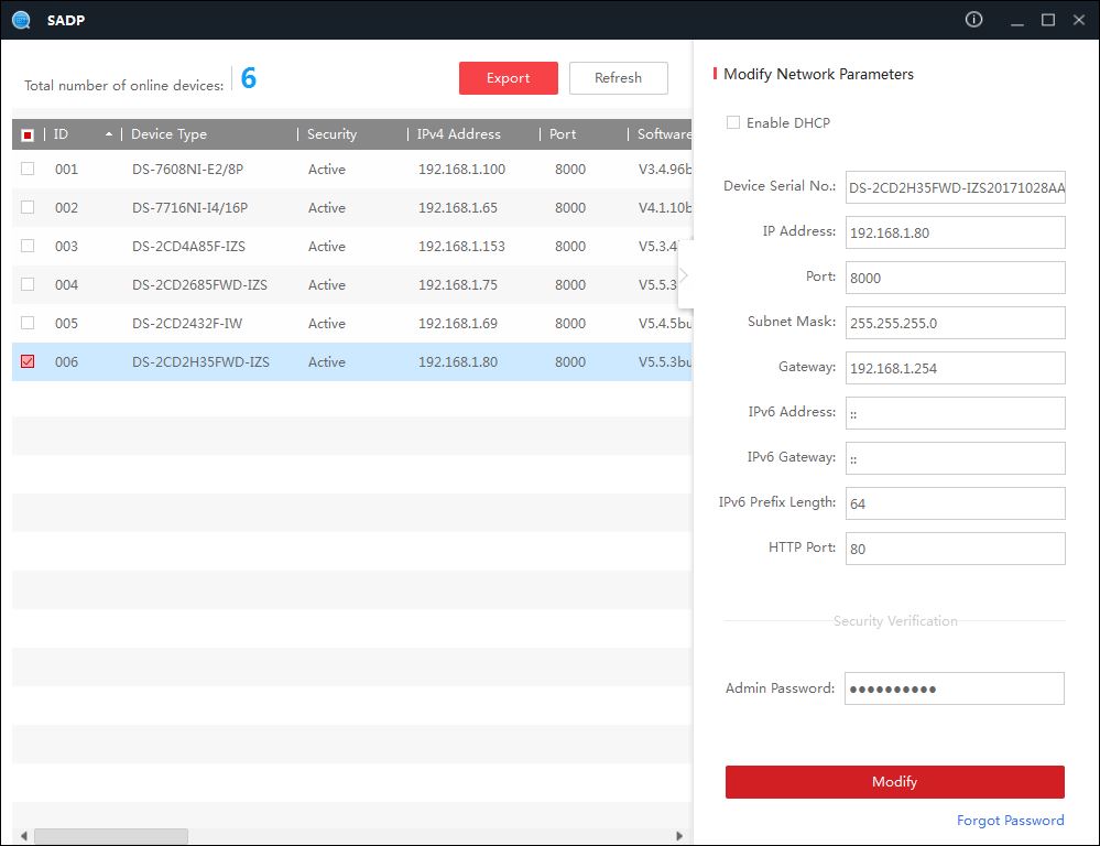

Step 2: Open SADP and select the camera (tick the box on the left of the list) then change the IP address of the camera to Milesight's default PoE segment (192.168.20.xxx), enter the admin password and click Modify

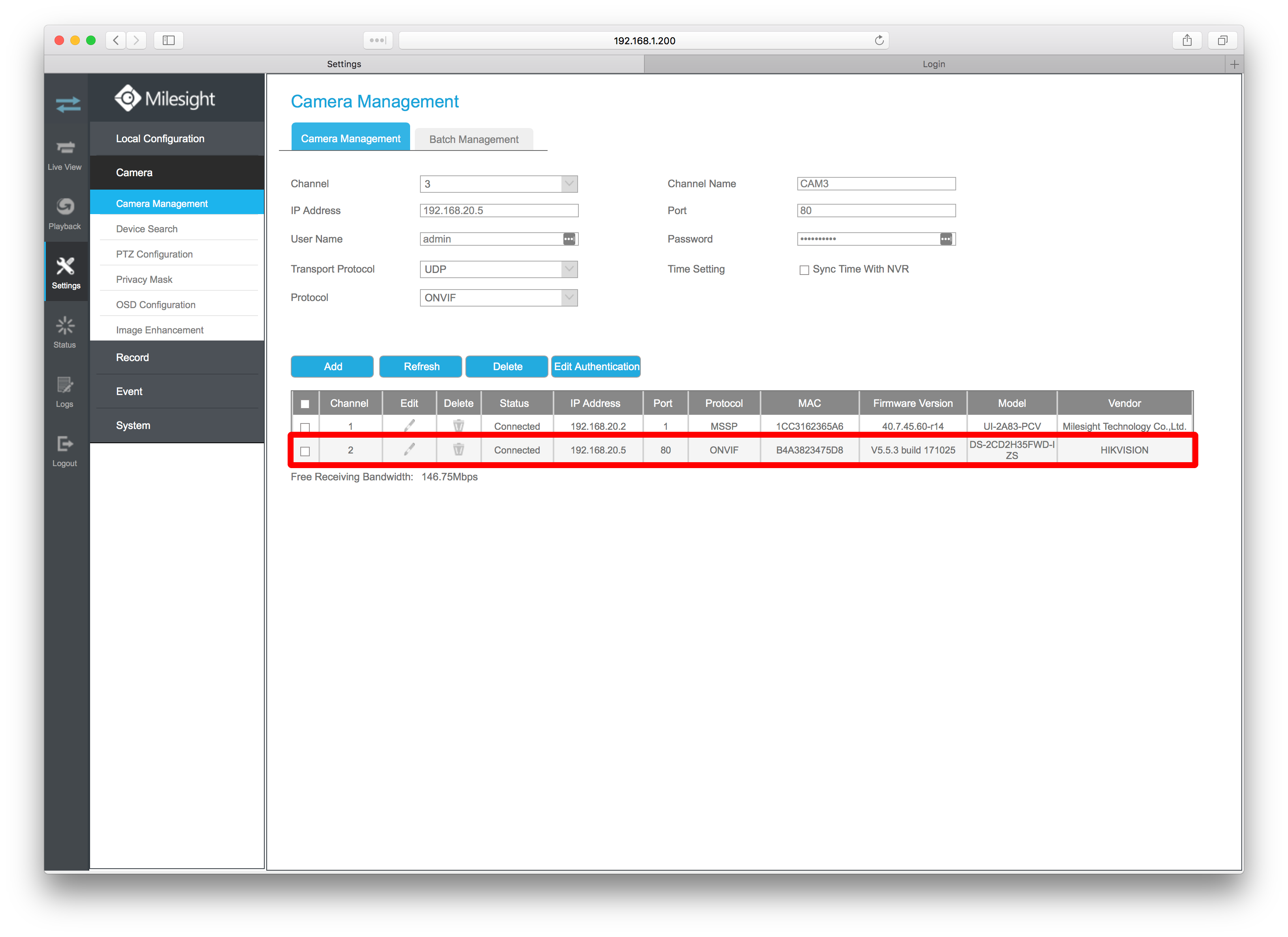

Step 4: Login to the NVR and click Settings and then click Camera from the menu, then select Camera Management from the drop-down

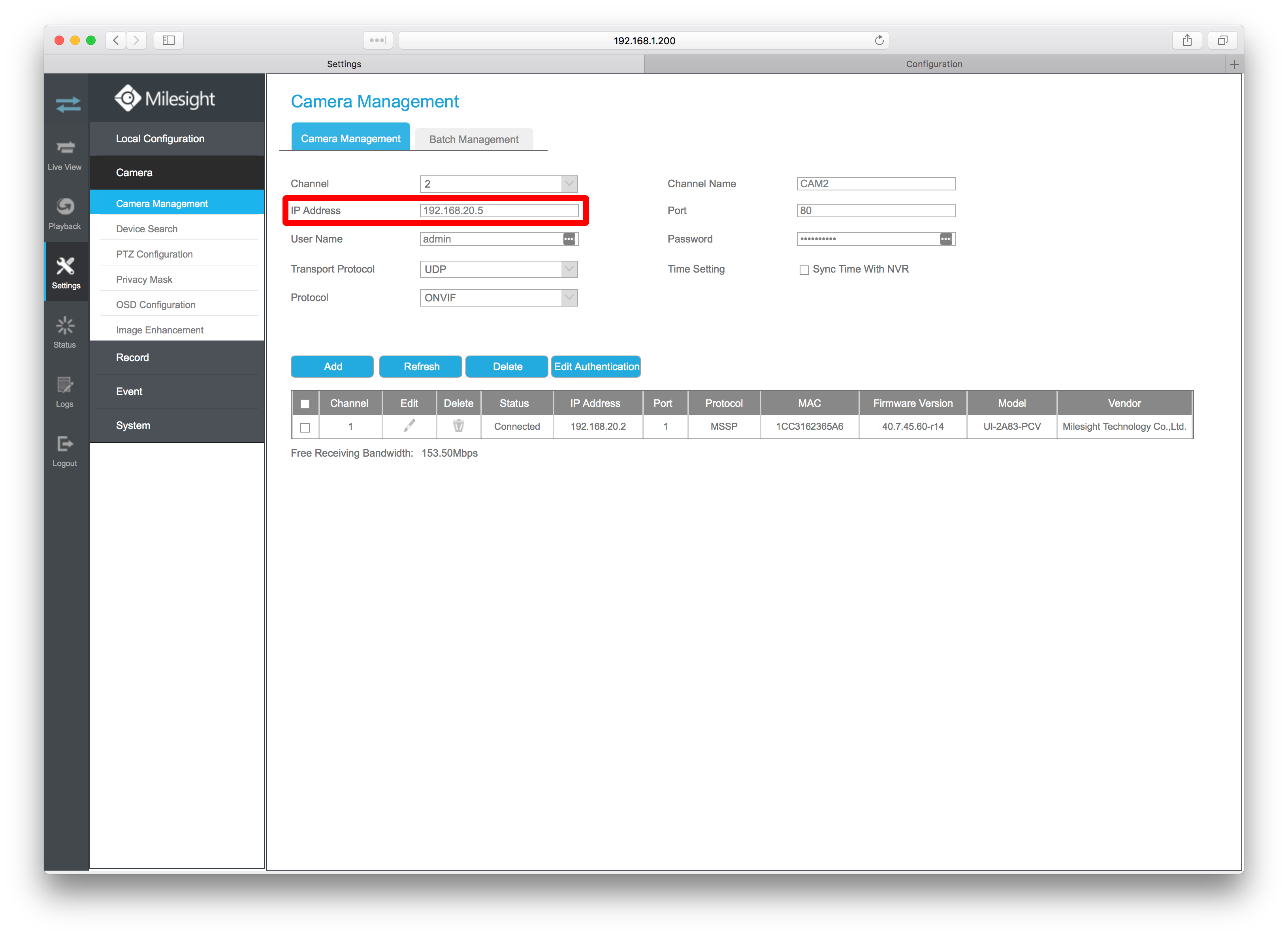

Step 5: Enter the cameras NEW segmented IP address (e.g. 192.168.20.5) into the box labeled IP Address

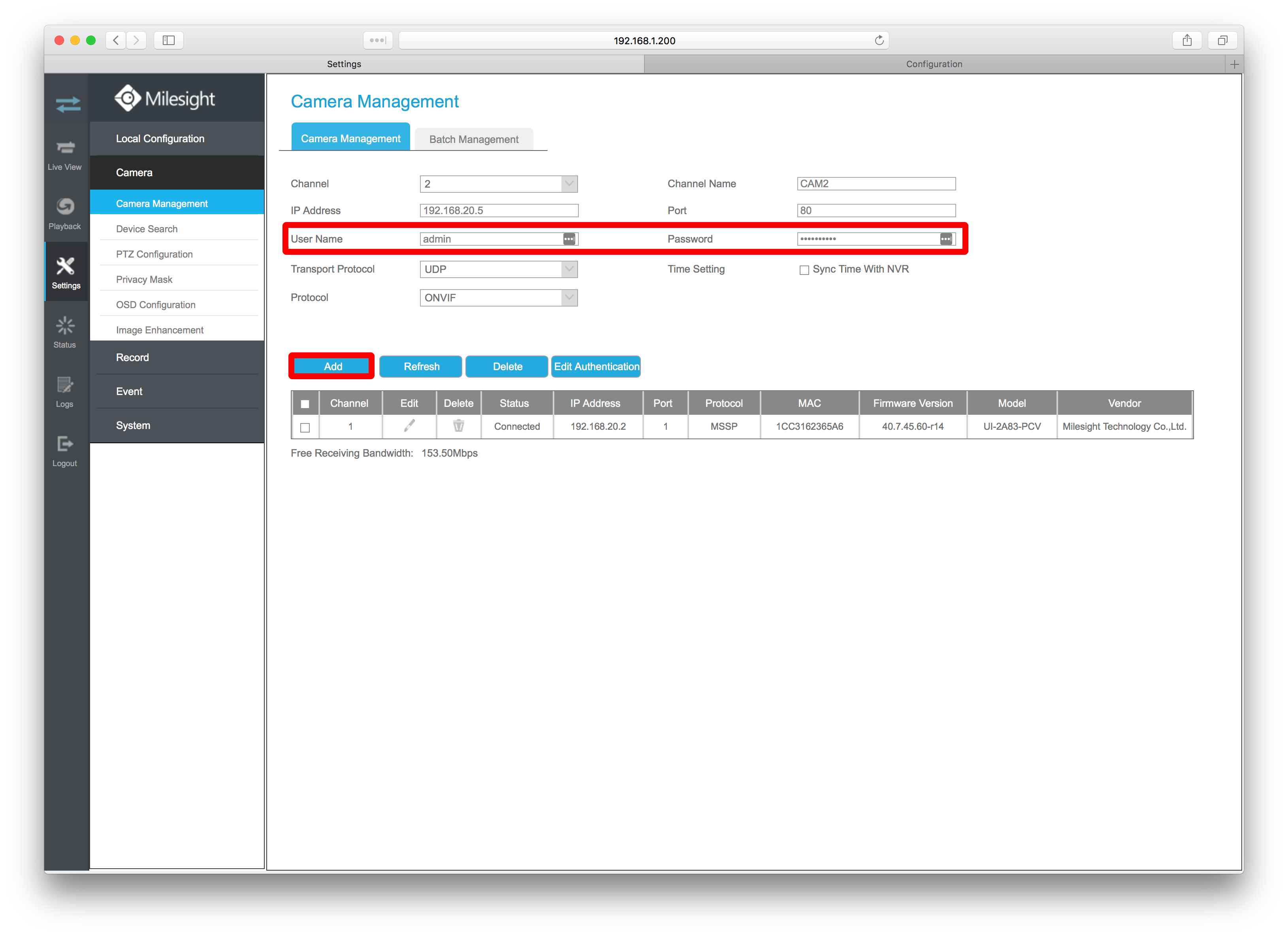

Step 6: Enter the username and password of the camera (this is the ONVIF user & password you just created, that is if they are different from the actual camera log in details) and then click Add
Step 7: If the camera appears on the list it is likely to say Disconnected, if so simply click the Refresh button and camera should reappear saying that it is now Connected

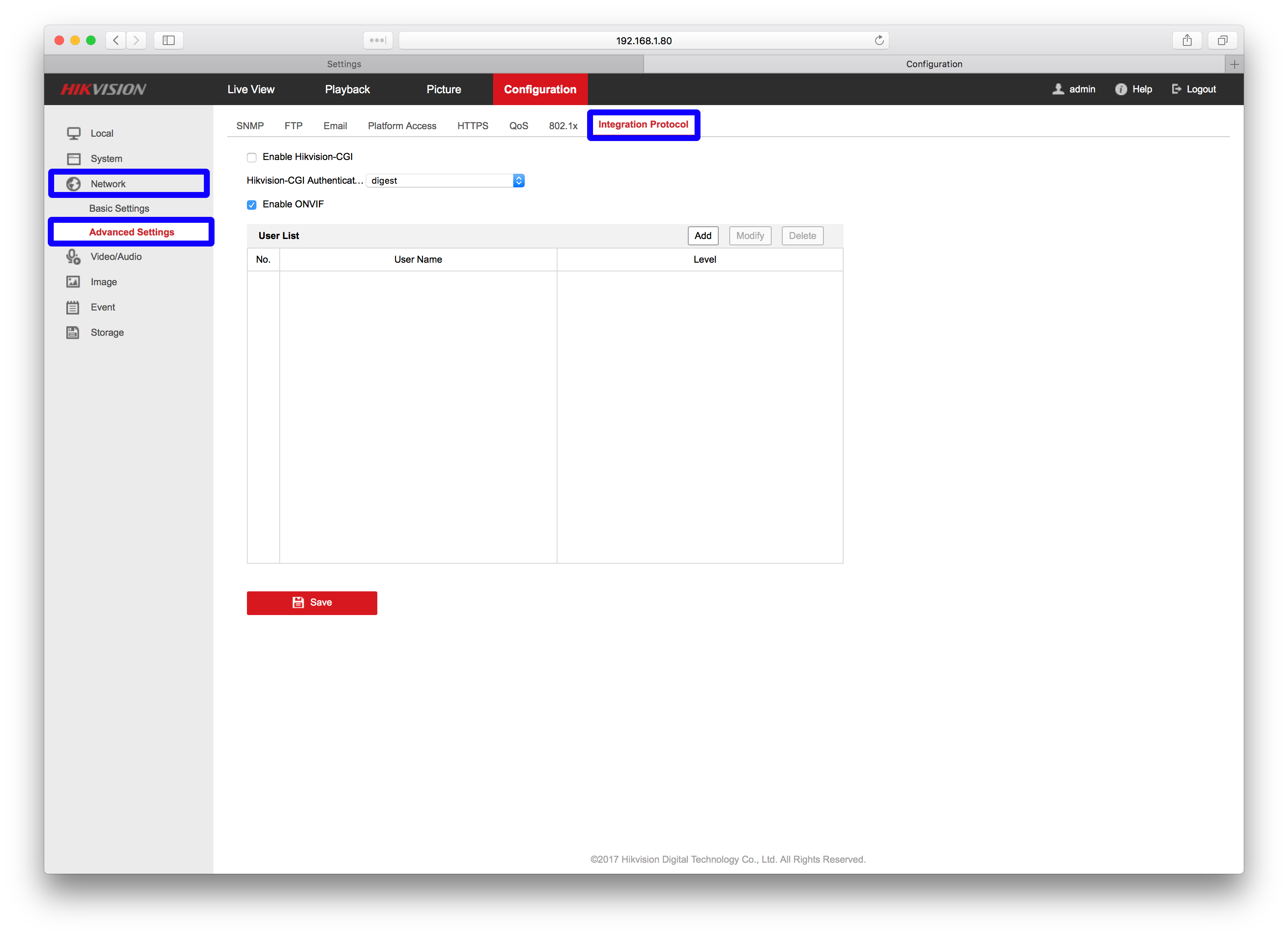

Step 1b: Click Configuration and then click Network from the menu, then from the drop-down select Advanced Settings and then select the Integration Protocol tab

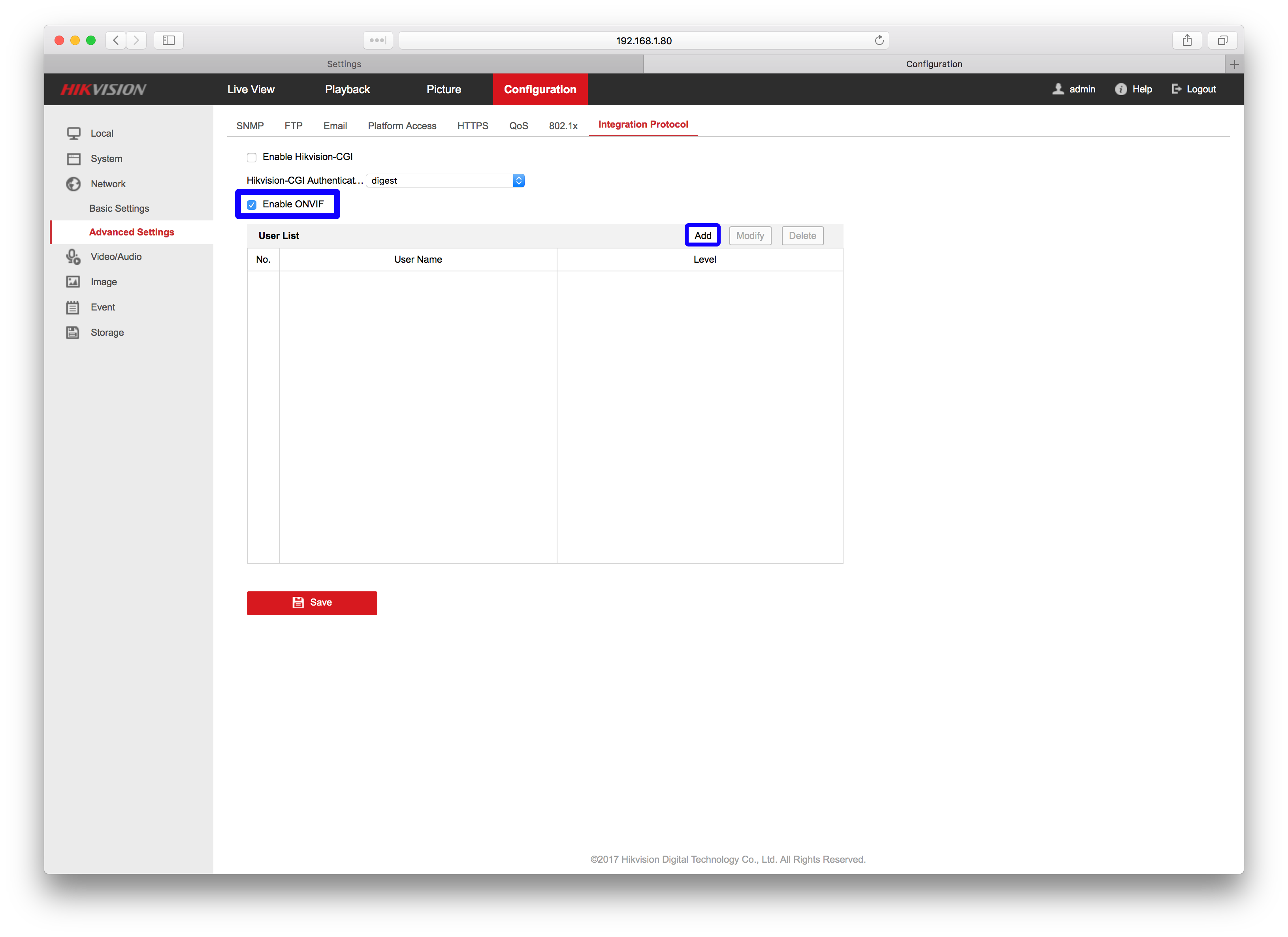

Step 1c: Tick the enable ONVIF box and then go to the table just below the tick box and click the add button

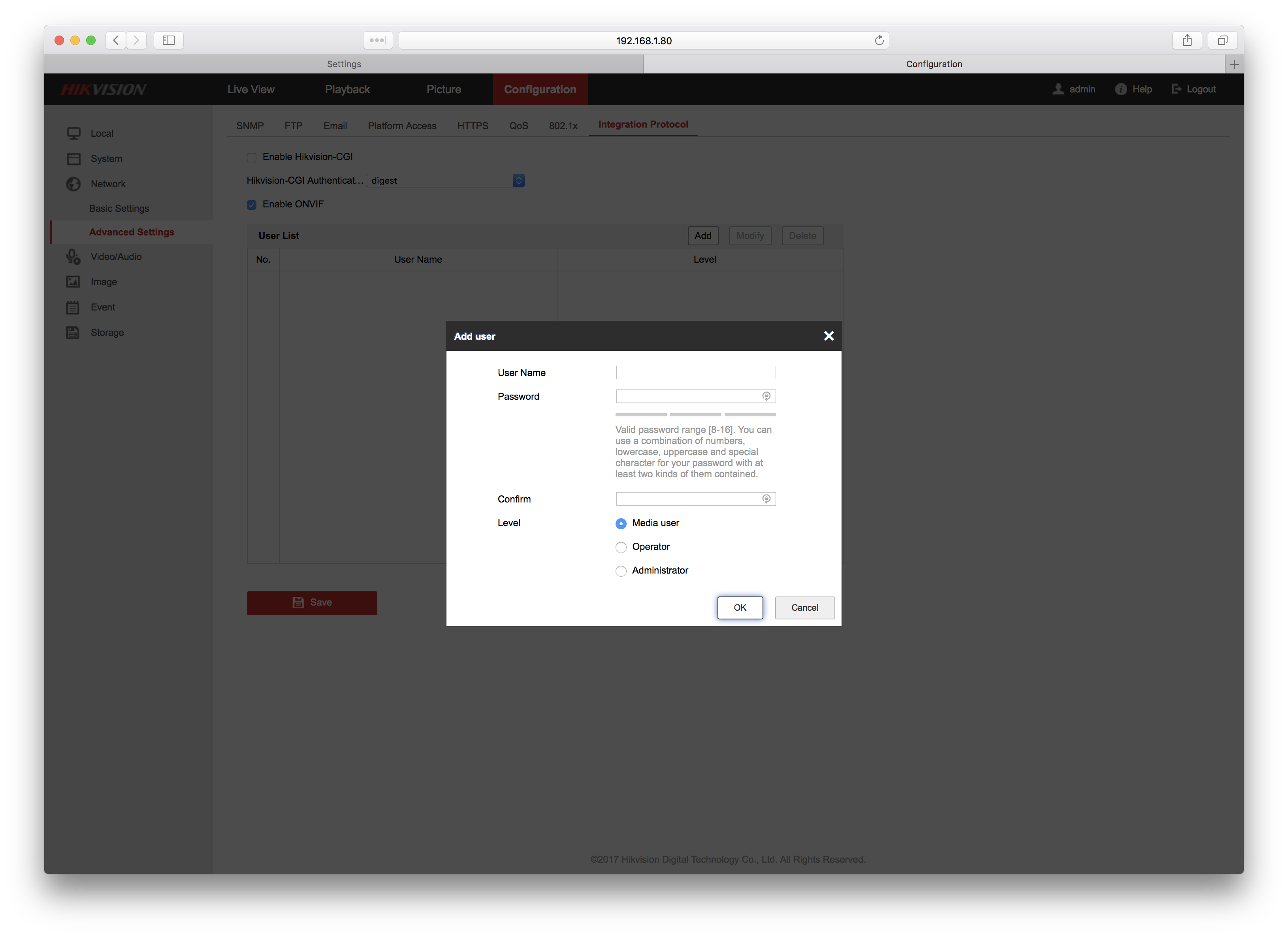

Step 1d: A pop-up will appear asking you to enter a new username and password for your ONVIF user account, enter these details and select administrator if you are the 1st user, add the new user by clicking OK (the username & password can be completely original or the same as the one you gave the camera, it is up to you)

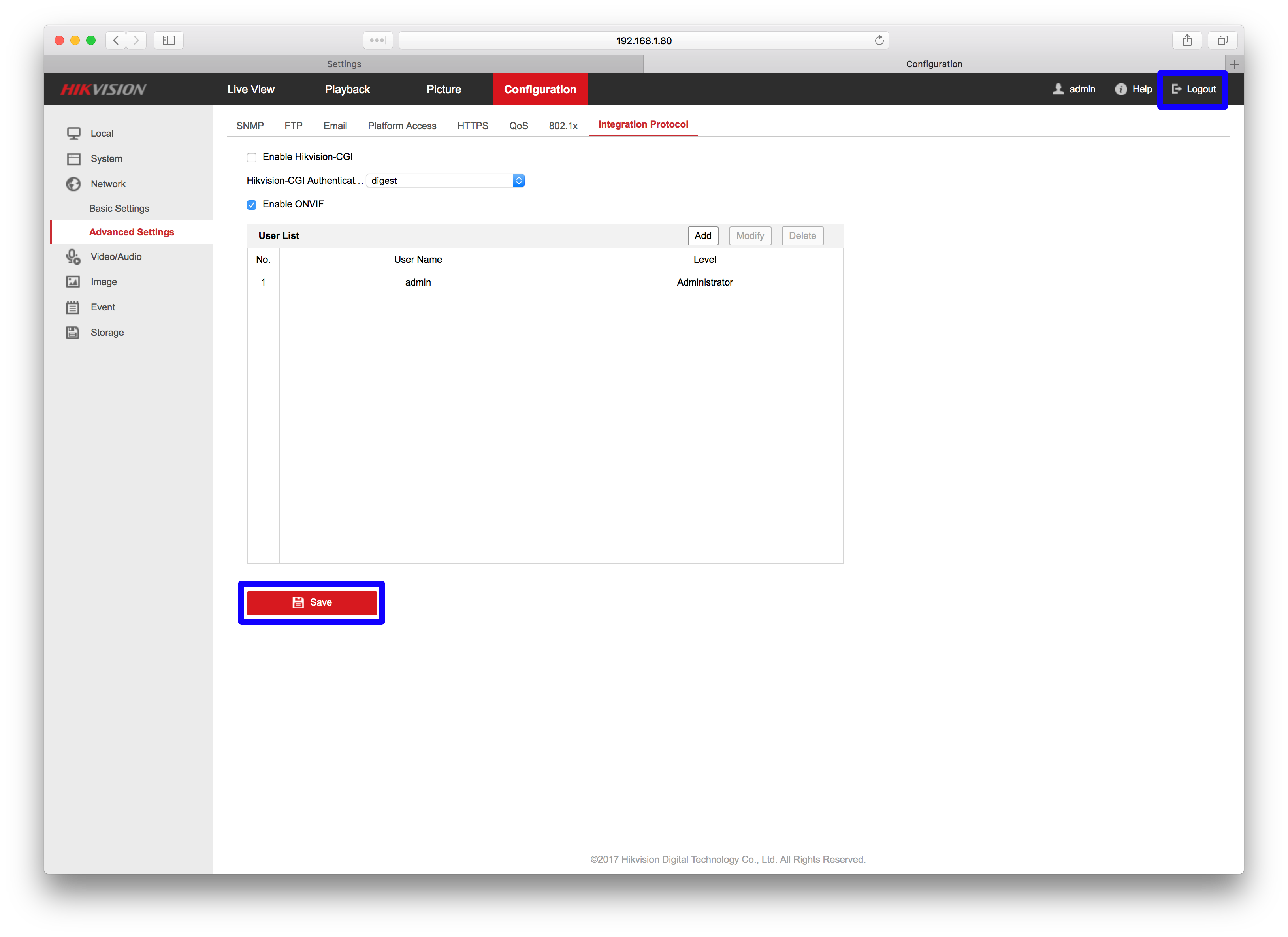

Step 1e: Finish by clicking Save and logging out of the camera
