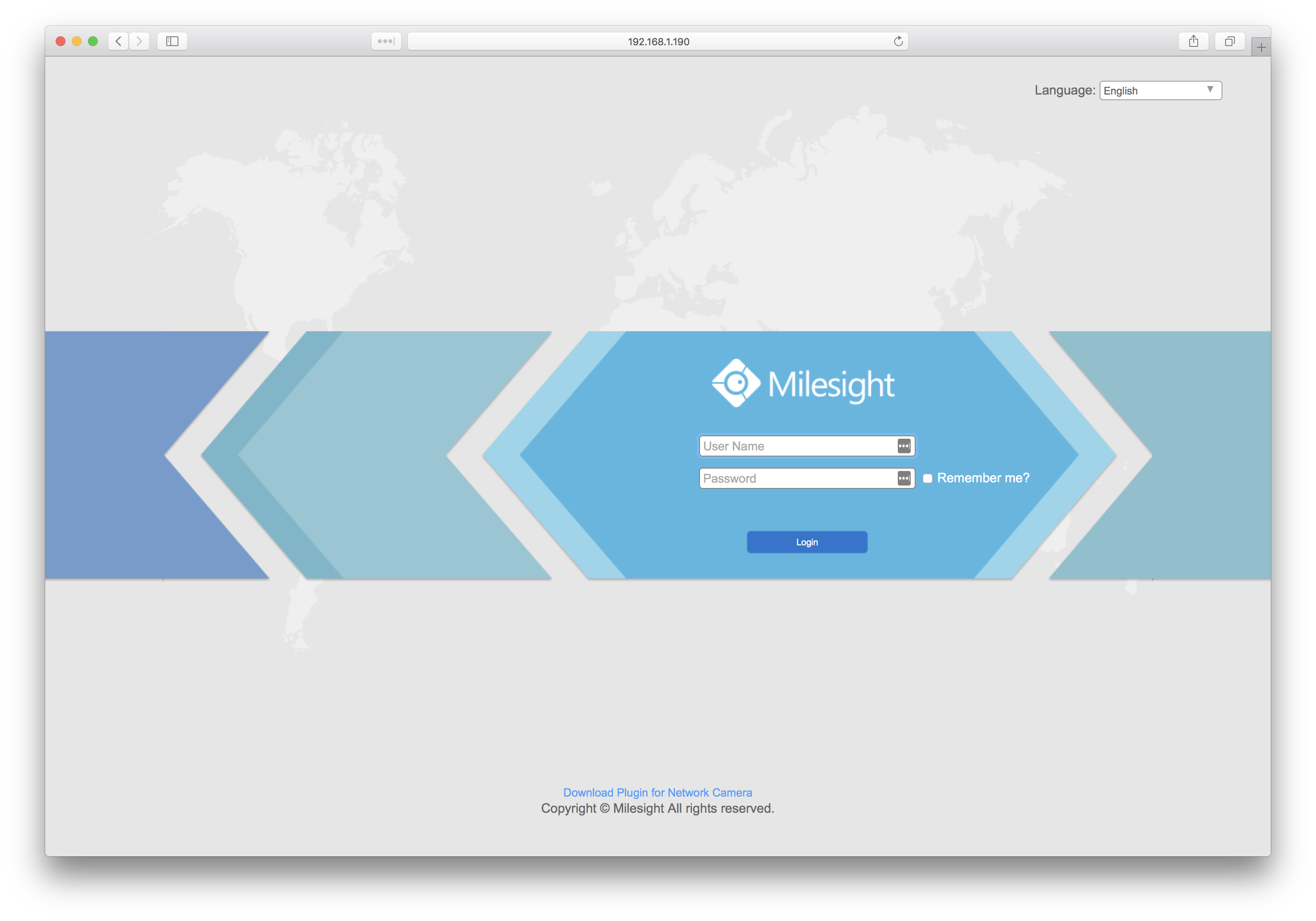

Step 1: Login to the Milesight camera using a browser (either IE or Safari)

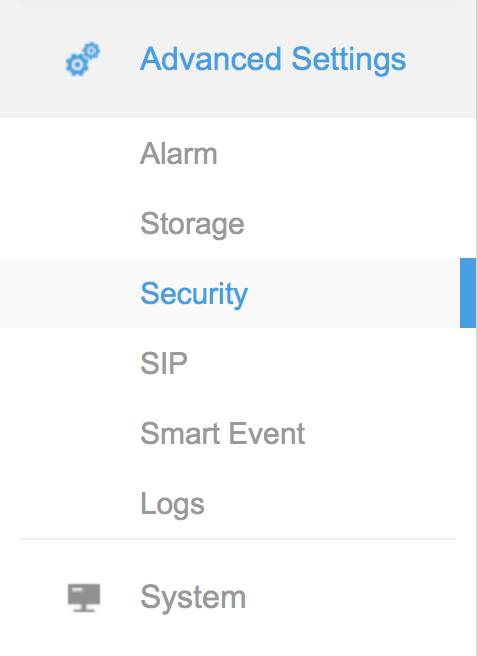

Step 3: Click the Advanced Settings tab in the left menu and then select Security menu from the drop-down

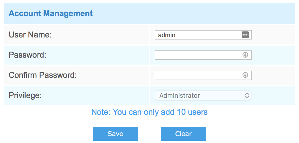

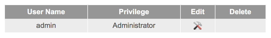

Step 4: When the page opens you will see a table with the camera's users listed (see below) and you will want to click the tool symbol under the edit column
Step 5: The boxes above this table will then fill with the same details (see below) and then you can enter a new unique password and then re-enter it in the 2nd box to confirm the new password and then finally click save
After saving the new password you can log out of the camera and log back in with the new login details - ***Above we have told you how to change the password but we didn't mention the username, this is because if you are the administrator (e.g. 1st user) you have to keep the username as admin but if you add any other users, we would advise changing the username to something unique as well as the password***
