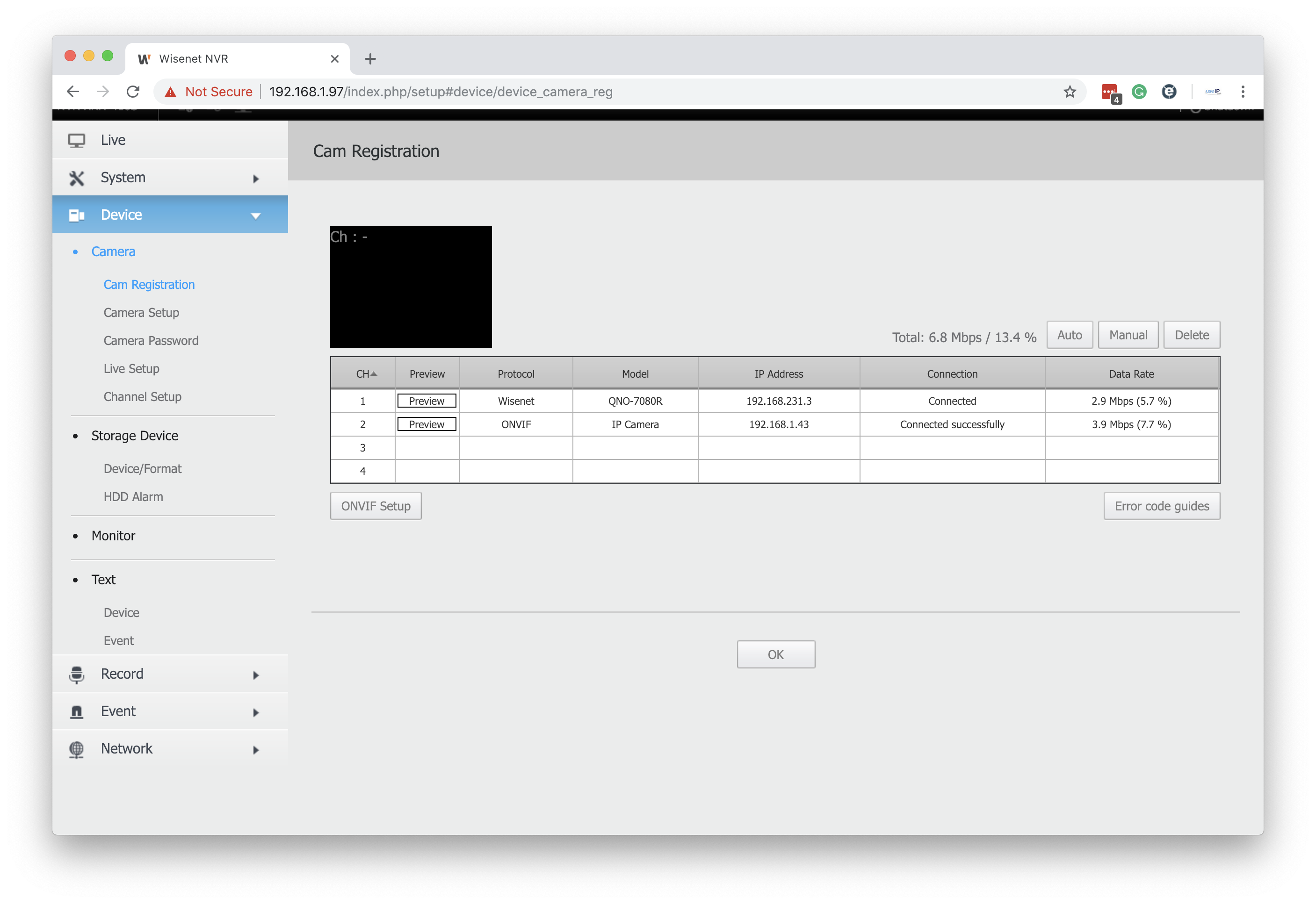

Adding an Optio camera that is on your network
Step 1. Login to the Samsung Wisenet NVR and go to Setup > Device > Camera > Cam Registration

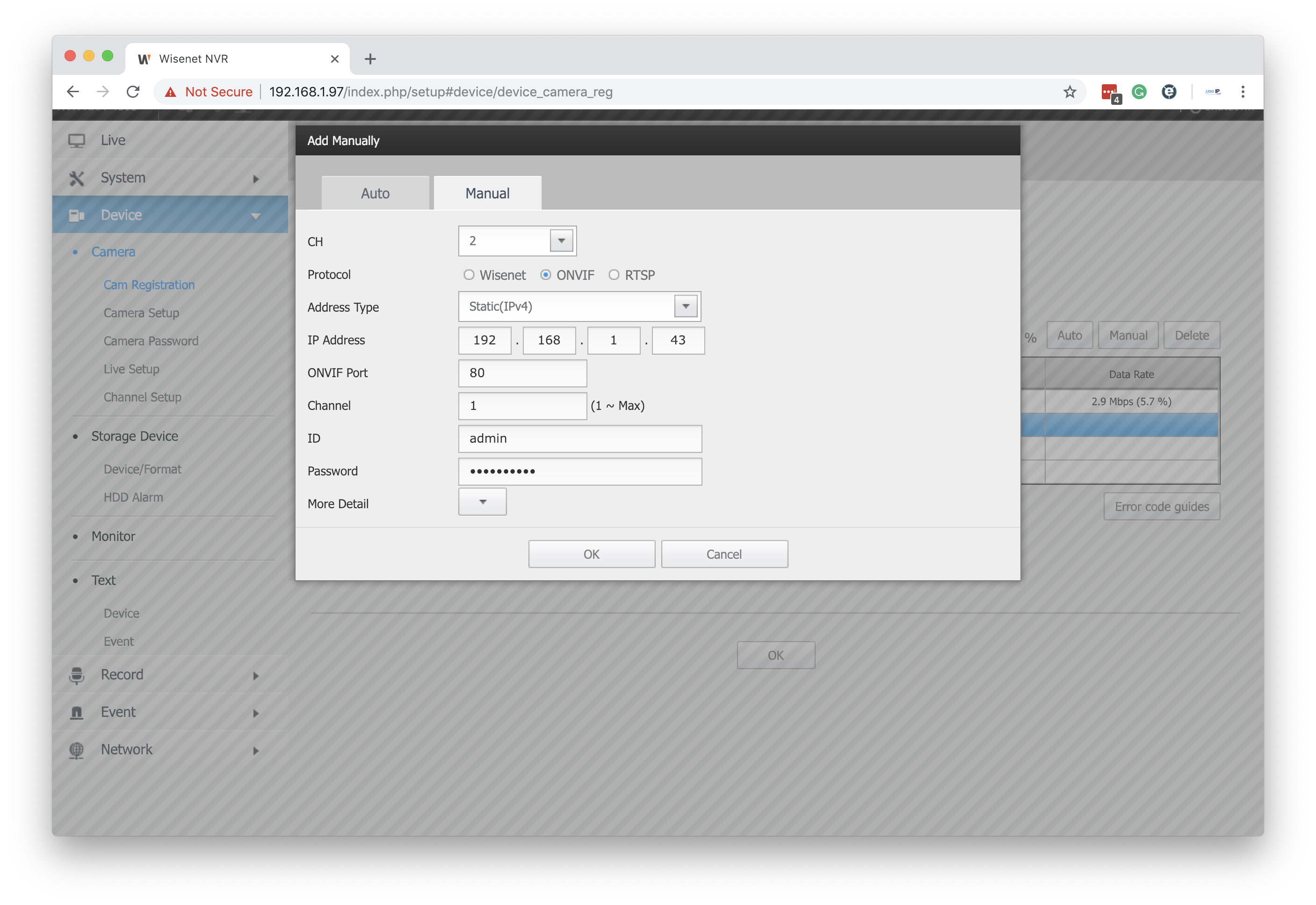

Step 2. Select an empty channel from the table and click the manual button at the top of the page, a popup will appear asking for the details of the camera
Step 3. Set the channel to ONVIF and then enter the IP address, username(ID), password, and finally enter the ONVIF/HTTP port (which is port 80 by default on Optio cameras) then click OK
Step 4. Once a successful connection has been made with the camera a popup will appear asking if want to register the camera, simply click OK and in the table it will say connected successfully
One final important thing to do to save the camera to the NVR is to click OK at the bottom of the page, once you have done this you can click Live View and select the Optio camera from the channel dropdown at the top of the page.

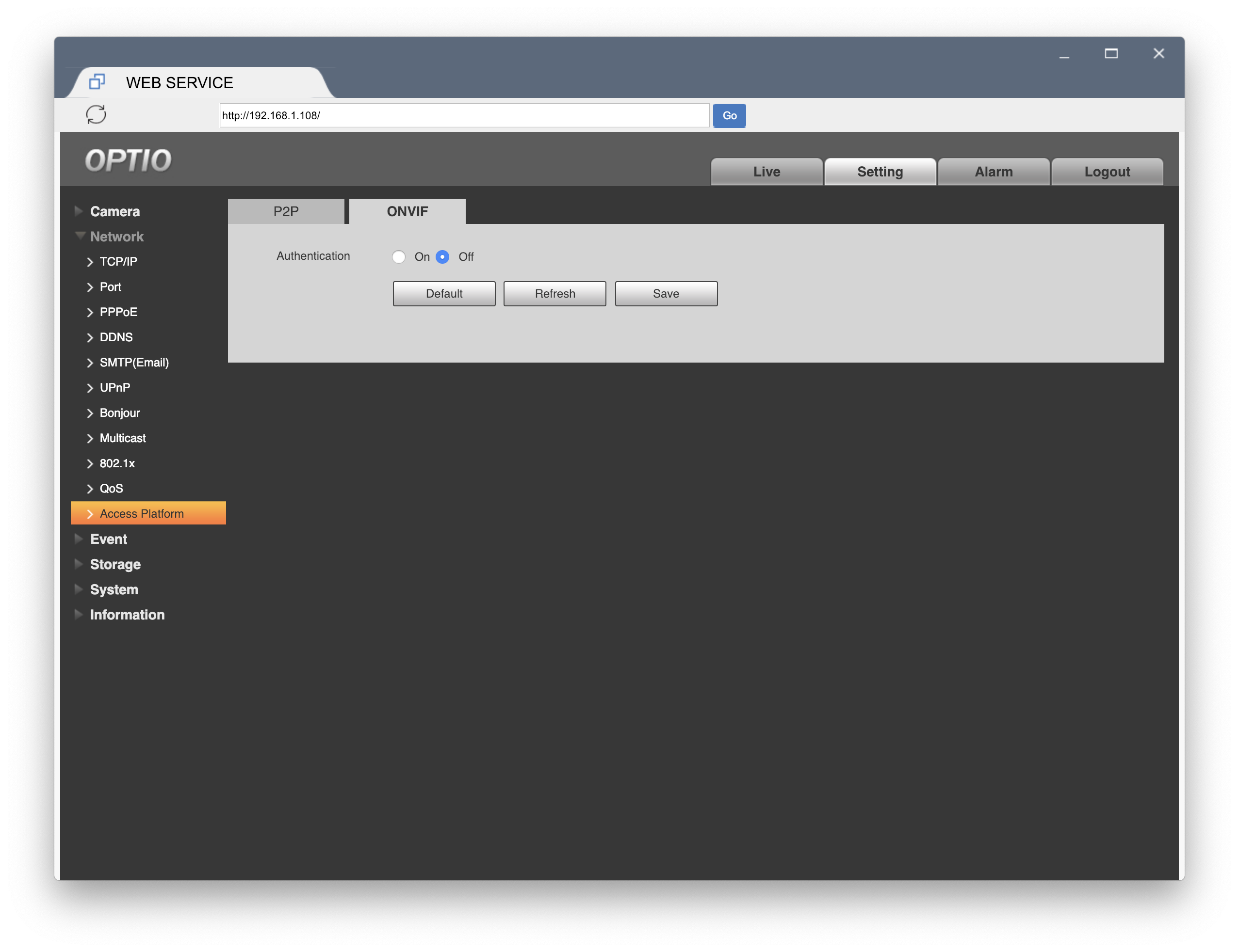

Step 1. Login to the Optio Camera using EasyViewer and go to Settings > Network > Access Platform > ONVIF and turn Authentication OFF and click Save

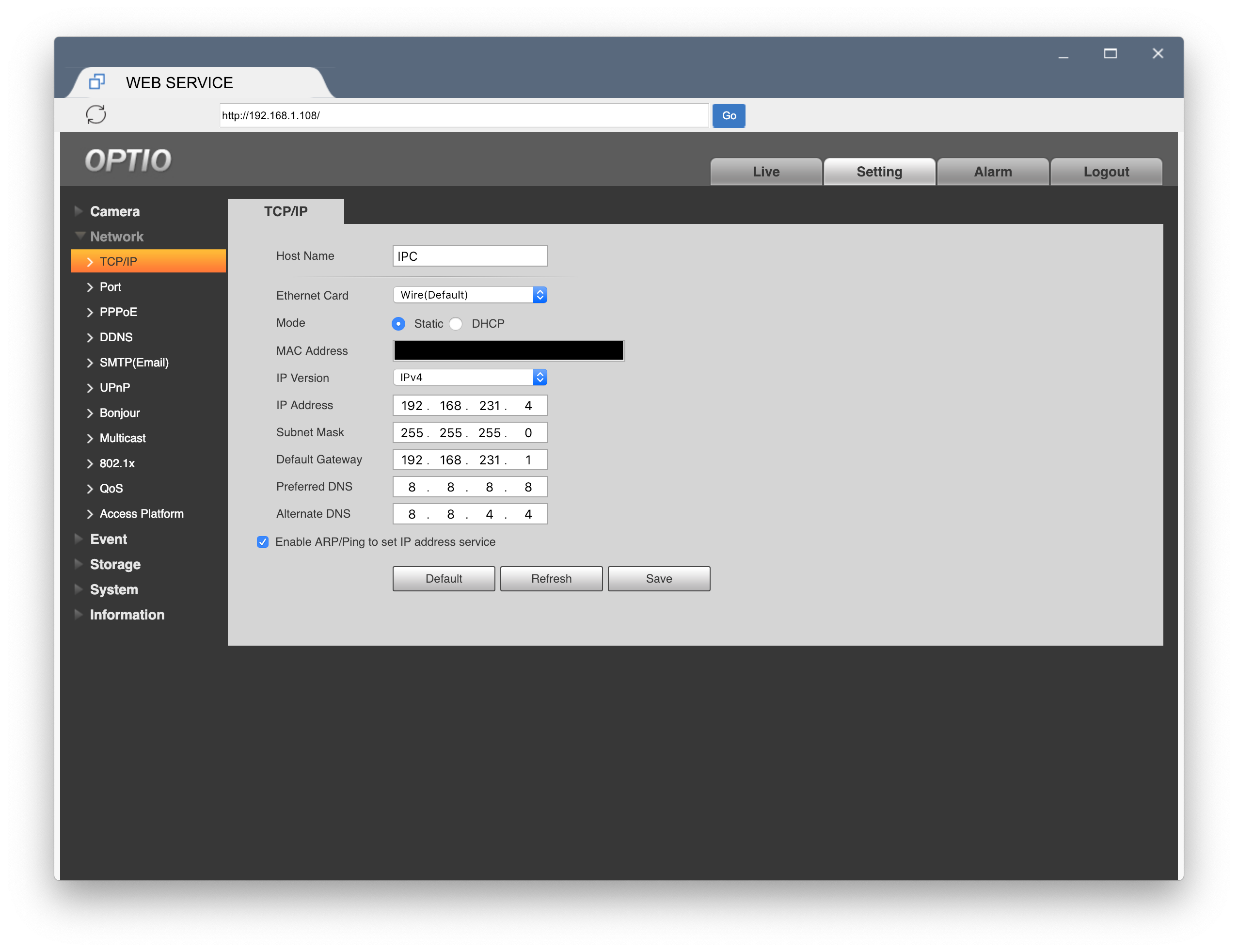

Step 2. Go to Settings > Network > TCP/IP and change the IP address and Gateway of the camera to match the Subnet range of the Hikvision NVR and click Save (IP address - 192.168.231.xxx - make sure you set this as an address that doesn’t clash with any other cameras already attached to the NVR / Gateway - 192.168.231.1)
Step 3. Disconnect the Optio camera from your Local network and connect it to a free PoE port on the NVR

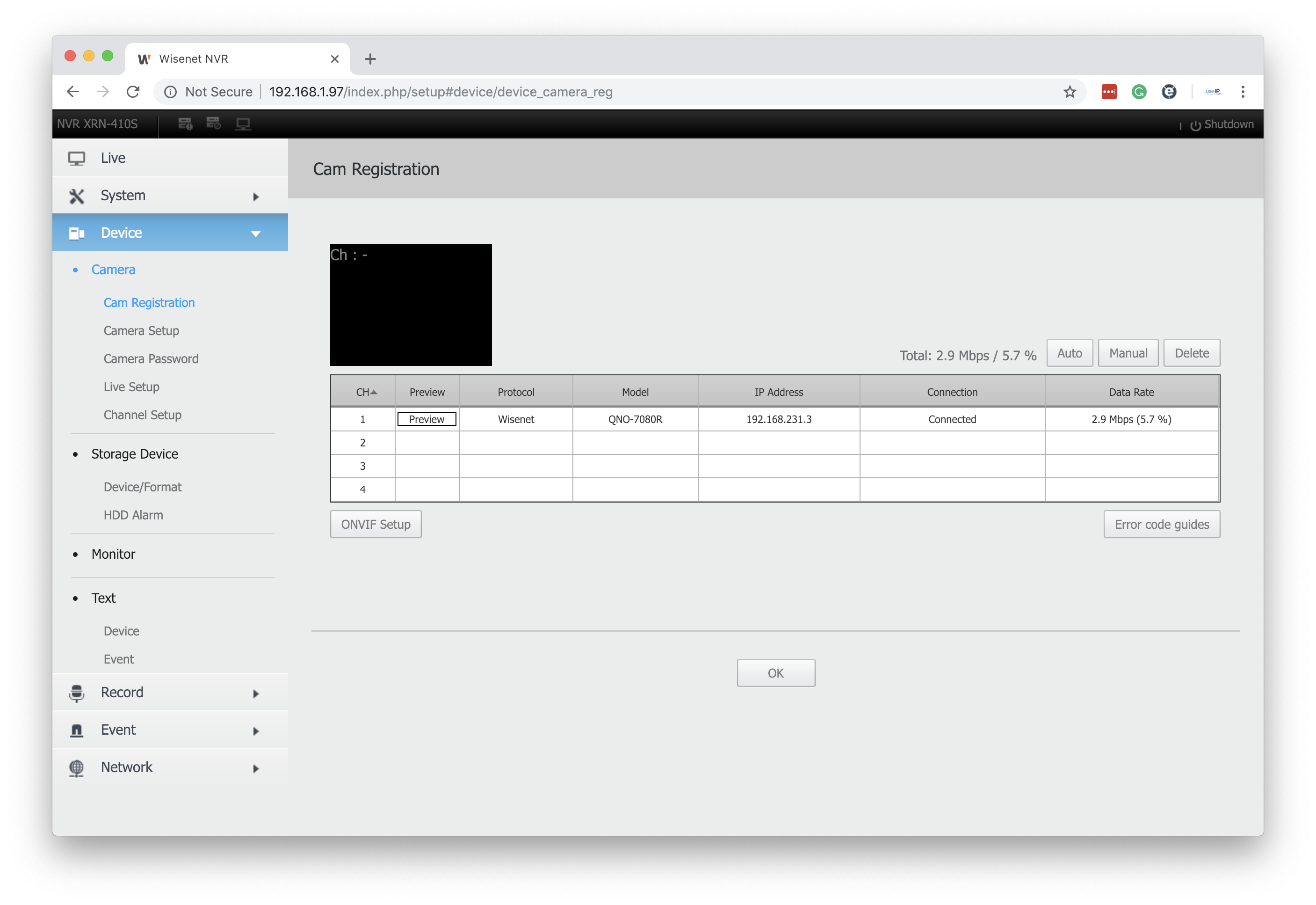

Step 4. Login to your Samsung Wisenet NVR and go to Setup > Camera > Camera Registration and then do steps 2-4 of the network adding method above but enter the subnet address that you just changed the Optio camera too.
(also like with the network adding method make sure that once you have the camera connected successfully you then click OK at the bottom of the page to save the camera)
