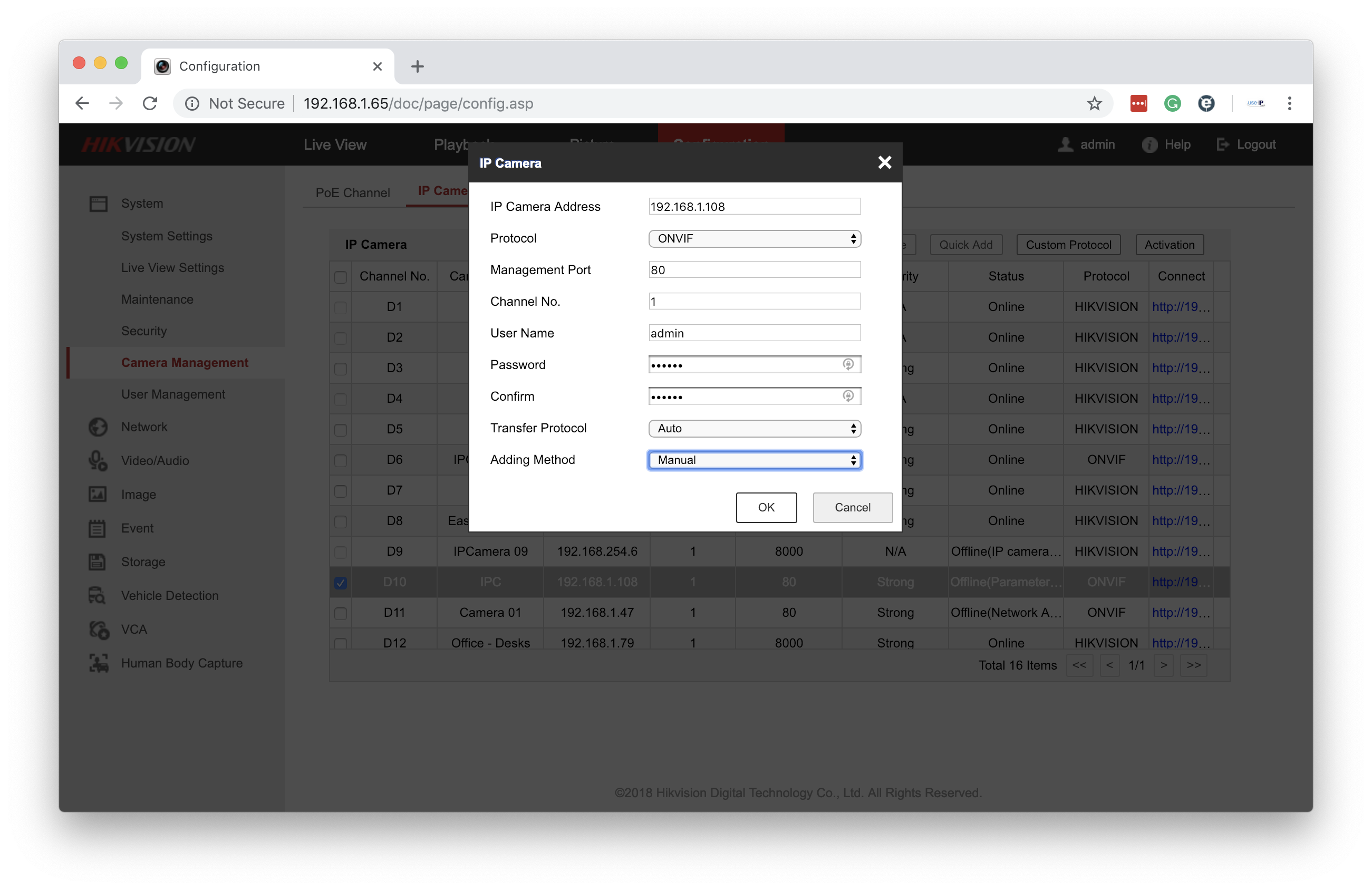

Step 2. Select an empty channel and click Modify and a popup will appear with the channel details
Step 3. Enter the IP address, the username, and password of the Optio camera and set the protocol to ONVIF then click ok

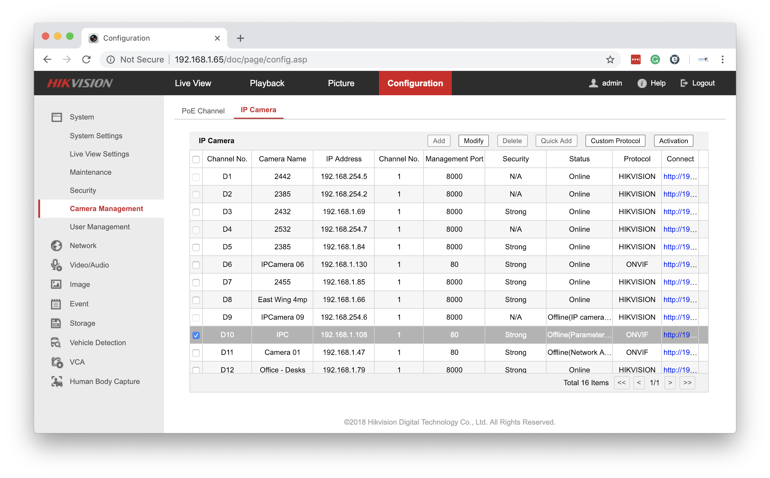

You will then be returned to the camera management list and it is likely the channel you have just added the camera to will still display as offline but if you click back to the Live View page the cameras live view should appear.

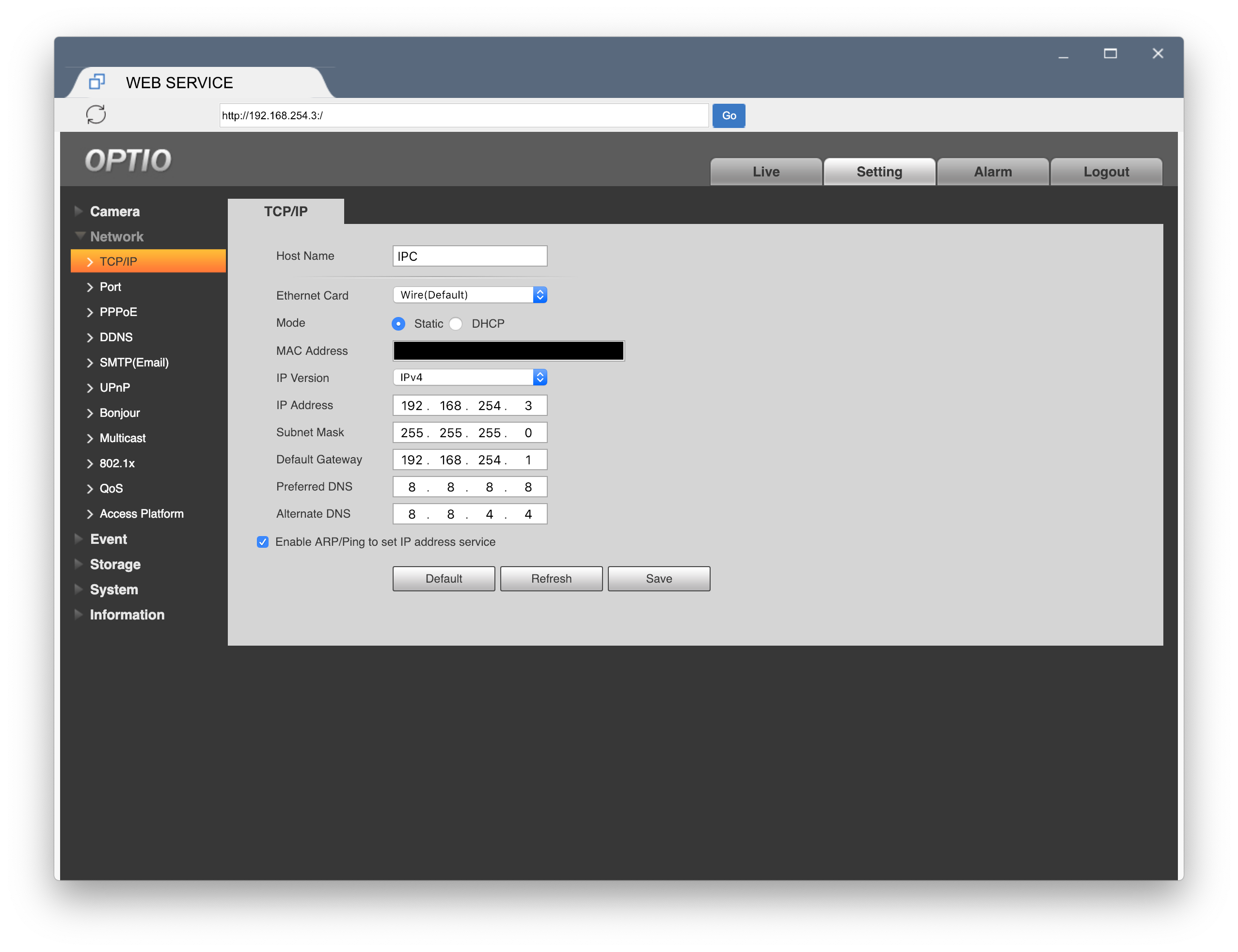

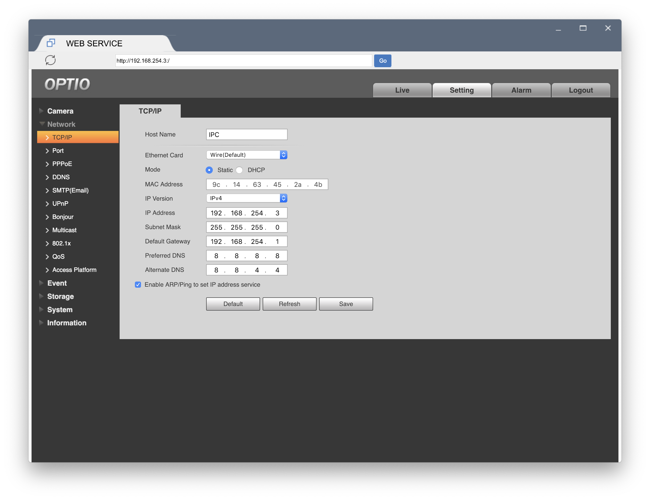

Step 1. Login to the Optio Camera using EasyViewer and go to Settings > Network > TCP/IP
Step 2. Change the IP address and Gateway of the camera to match the Subnet range of the Hikvision NVR and click Save (IP address - 192.168.254.xxx - make sure you set this as an address that doesn’t clash with any other cameras already attached to the NVR / Gateway - 192.168.254.1)
Step 3. Disconnect the Optio camera from your Local network and connect it to a free PoE port on the NVR
Step 4. Follow steps 1-3 from the previous adding method but this time change the IP address of the channel to match the subnet address you just gave the Optio camera
(make sure that you choose the empty channel that corresponds to the port you are connected to - e.g. port 2 is connected to channel D2)
Once you’ve clicked ok you will have to wait around 30 seconds for the connection to be made and then when you return to Live View you should see the camera.

Step 1. Login to the Hikvision NVR and go to Configuration > System > Camera Management > IP Camera
