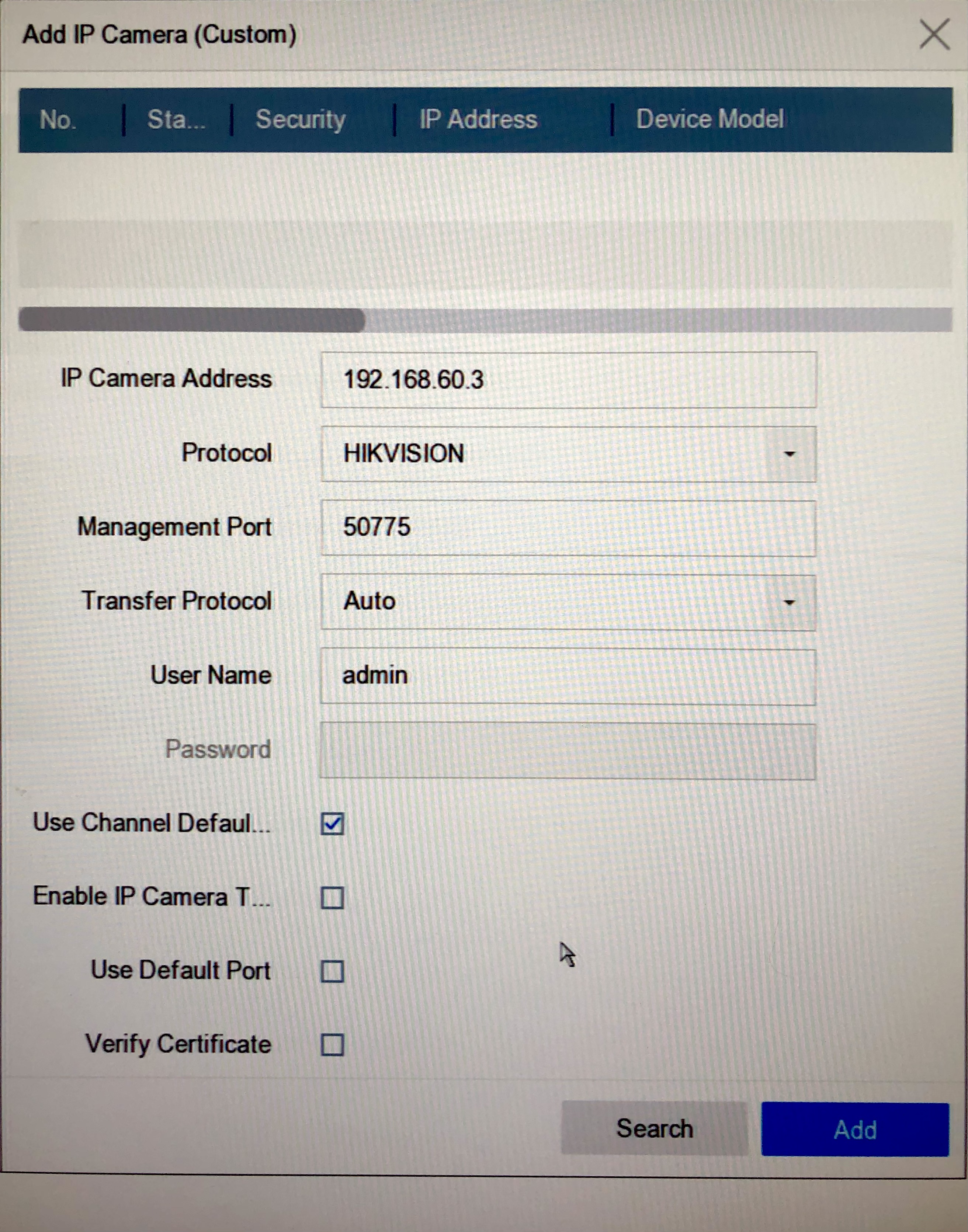

  • Go into the camera menu item at the top of the screen, and then select the next available slot/channel or the slot/channel you want to add the camera into on your NVR
  • In the camera IP address field, enter the IP address of your current DVR
  • Protocol stays as HIKVISION
  • Management port I changed from the default, so set this as 8000 or press the use default port button, or change to whatever you have your management port set to on your DVR
  • Transfer protocol leave as AUTO
  • Username/password as set on the DVR
  • Don't bother with Enable IP camera time sync, or verifying certificate - you can use the default channel password if you like/need to

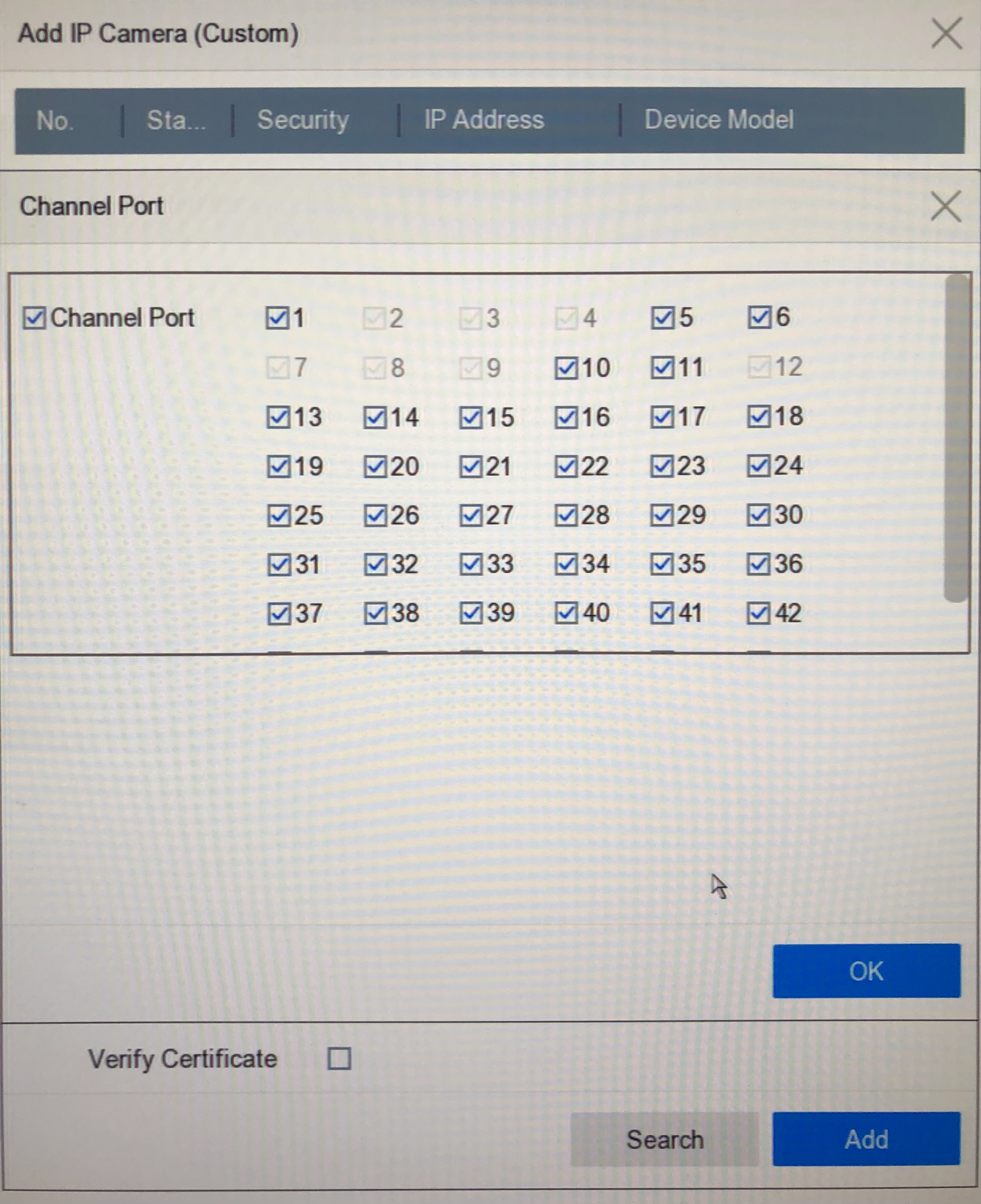

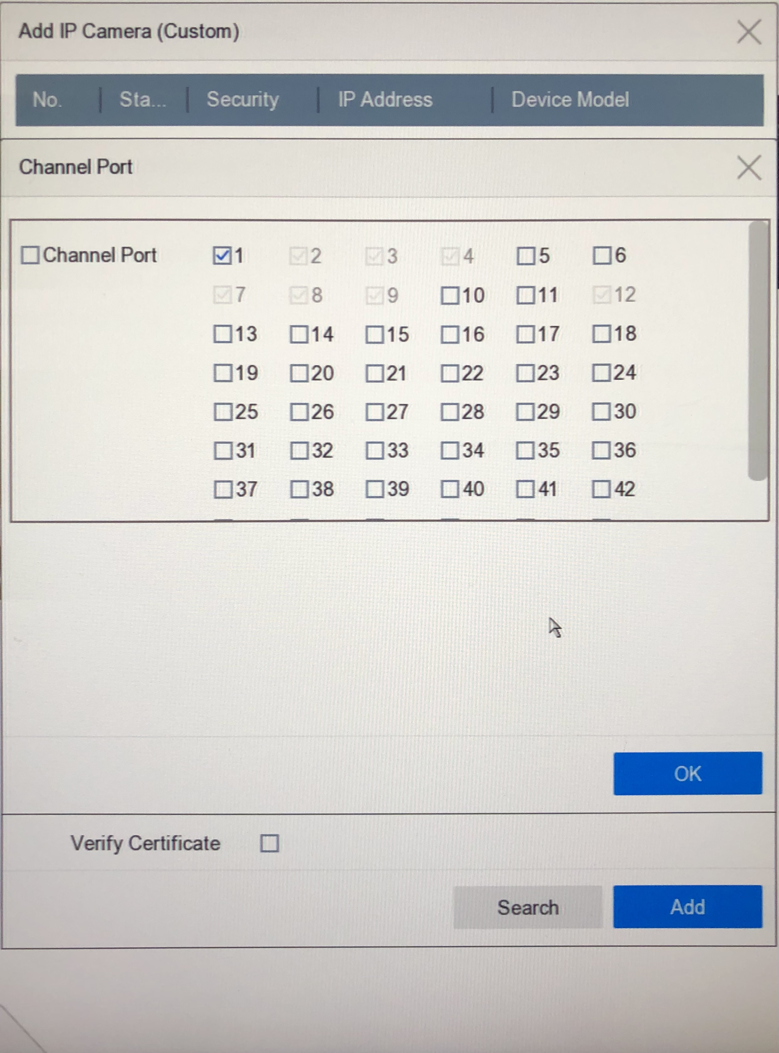

  • Press add, and a new box will popup showing all the available channels on the DVR
  • Just select one of the channels you want to add (if you have many cameras, you have to do this process multiple times to add each camera to a separate channel on the NVR) in my example. the NVR had 16 analogue channels, and 32 IP channels - im not interested in the IP channels, as I'm adding the IP cameras direct to the NVR, so I'm just interested in channels 1-16 which are the TVI/Analogue channels. Just need to work out which channel you want to add and ensure only that one is ticked
  • Press add, and the channel will be added to the NVR in the channel/slot you chose
