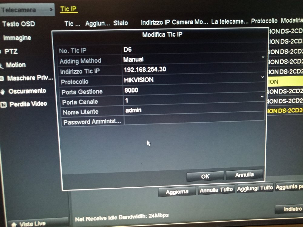

6) Click edit on that channel, switch the channel from Plug & Play to Manual, and then enter the new IP address you set for that camera and the camera's password

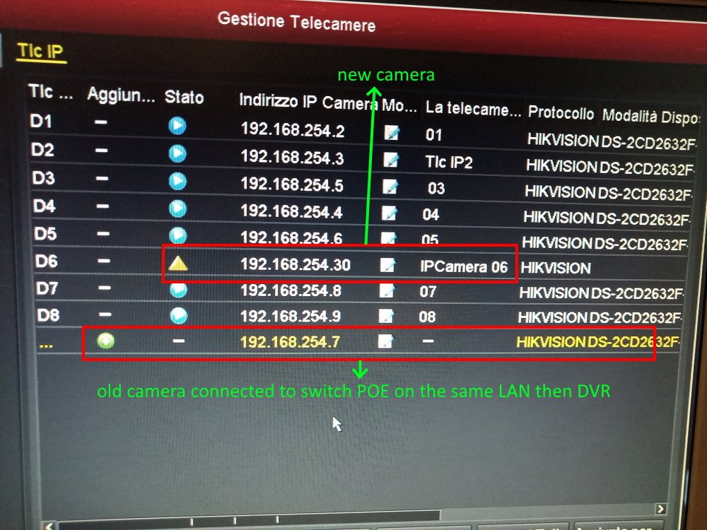

Then in the dvr on channel 6 (where I connect the new camera) I change the Adding Method to Manual to set the IP and also the password.
Unfortunately all this did not change the result: "Network not reachable".
So I connected the old camera to the dvr on channel 6 setting the Adding Method to Plug&Play: I was sure that the camera would be recognized and connected but I was wrong.
The first message was "camera non present" so I set Adding Method to Manual and I changed the IP to 192.168.254.7, the old camera IP.
Other error message: "Wrong user or password", so I changed manually the password to the old one to get again the message "Network not reachable".
So now it seems that also the old camera can not be connected to the dvr.
Perhaps the problem is in the dvr; I'm not sure if I can "reset" the dvr port in some way, it is strange to me that I can't connect the old camera...

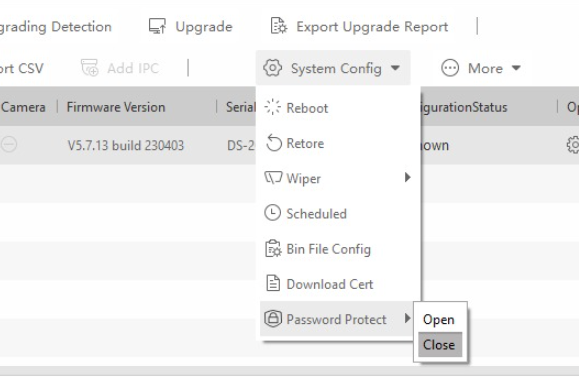

Here. Do this with Batch Configuration tool on camera. It will disable modern security and it will use old security protocols.
