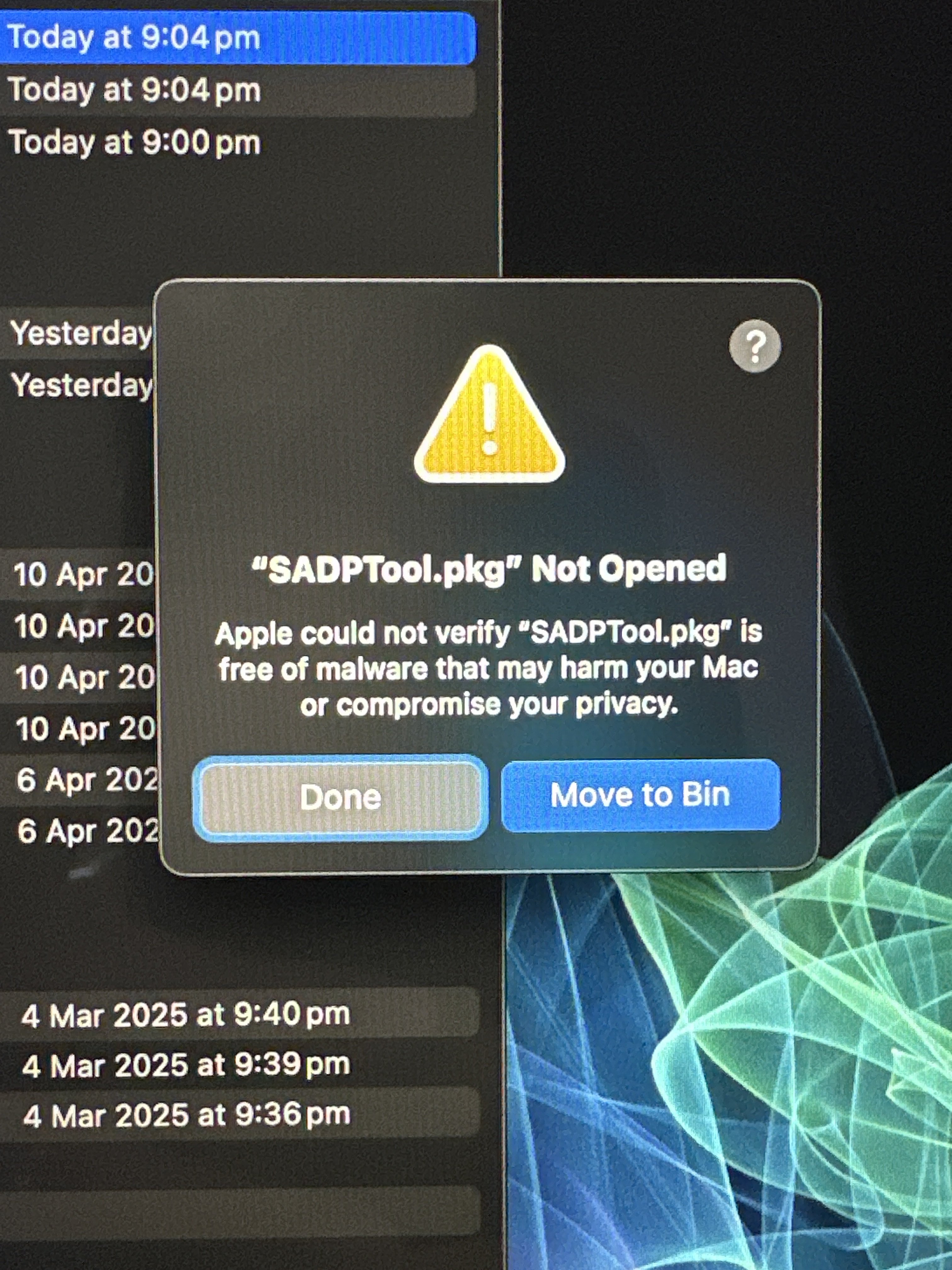

D Dondon09 New Member Messages 4 Points 1 Monday at 12:12 PM Thread starter #5 Yes still unable to open. Attachments image.jpg 1.5 MB · Views: 5

Dan Administrator Staff member Messages 4,790 Points 113 Monday at 12:38 PM #7 Hikvision Mac compatibility is not great and some of the Hikvision software doesn't work with certain MacOS versions. Please try using Hikvision's free VMS instead - iVMS-4200 - which has an SADP Tool built-in for finding the HiLook NVR on your network. We cannot offer 1-to-1 phone support to non-customers.
