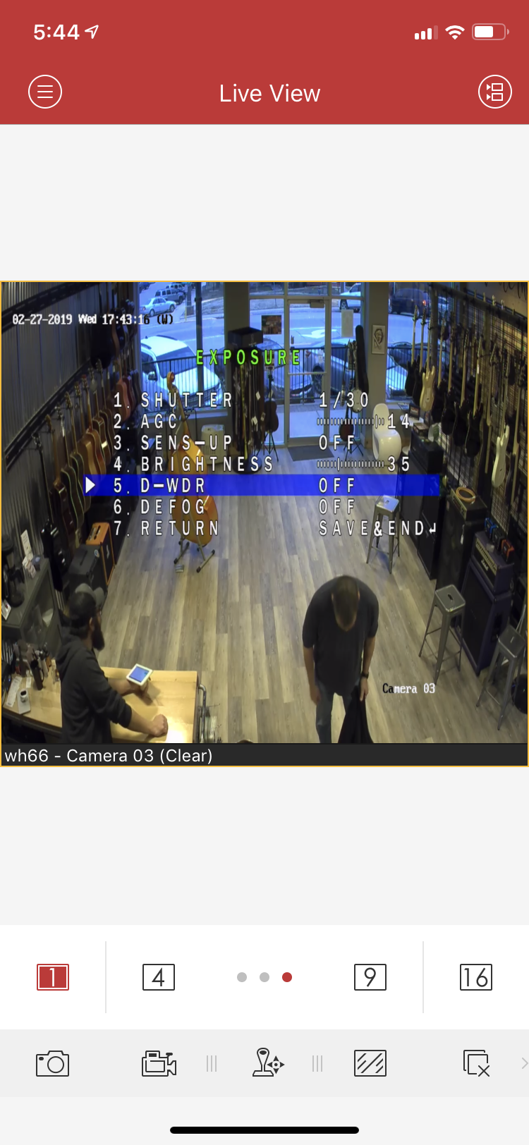

W Warehouse66music New Member Messages 2 Points 1 Feb 27, 2019 #1 I can’t seem to get the menu options to go away on my mobile device
Phil Administrator Staff member Messages 5,170 Points 113 Feb 28, 2019 #2 Is this the menu of a CCTV App? Which App please? What device?
W Warehouse66music New Member Messages 2 Points 1 Feb 28, 2019 Thread starter #3 It is...it’s the iVMS-4500. It’s on one screen on mi iPhone. I was looking at cameras yesterday and I must have clicked on something that opened the menu and now I can’t get it to go away.
P pyrotenax Active Member Messages 33 Points 8 Apr 8, 2019 #4 That looks like the "menu" of a particular camera you were viewing. Use PTZ zoom controls to navigate (ie. Up an down) and "iris +" as enter
