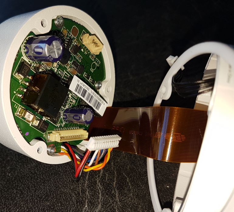

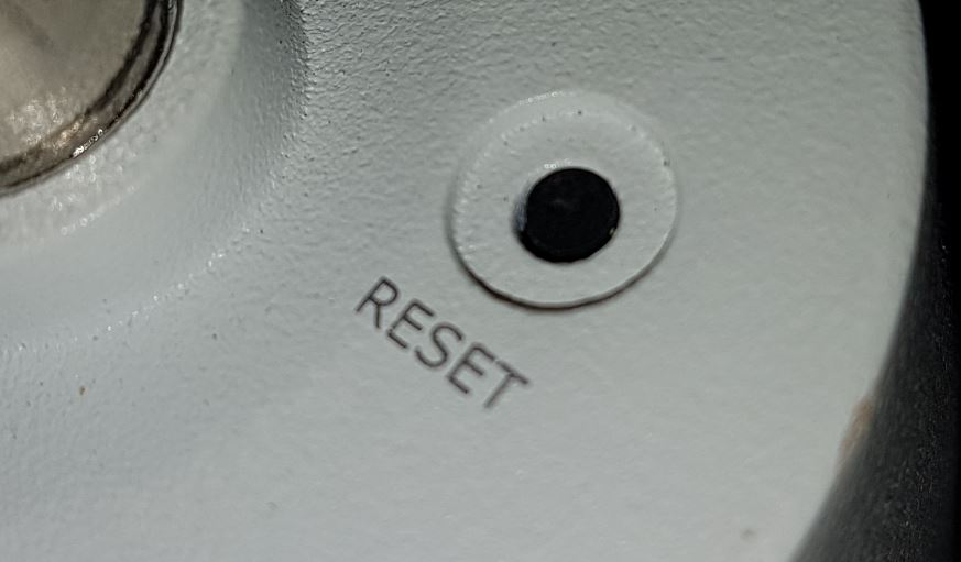

This what I found when I pulled it apart. Same as the previous one with the same issue.
Reset button appears normal, but when you press it you cant feel it click.
Opened it up & disconnected the two cables. Didn't bother with the flat ribbon.
Did disconnect it last time though.

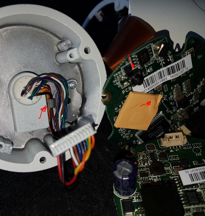

Removed the 3 screws & the first PCB. Need to prise it out as it's plugged into the one below.
Removed the second PCB, which reveals that the wires aren't retained properly and are jamming the reset button down.
The green wire showed an indent & it can also be seen in the yellow thermal transfer pad.
Re-posisitioned the wires under the metal plate where they should be & reassembled the whole unit.
All working perfectly now with no defaulting on reboot.
