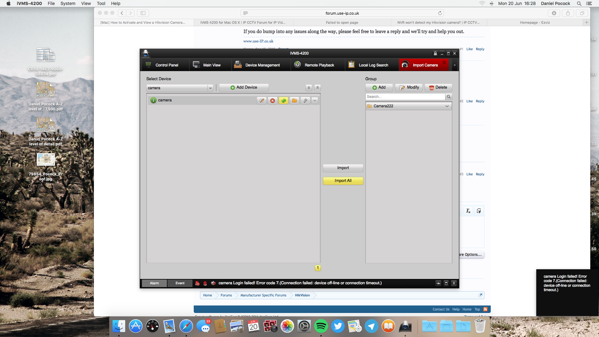

There's just a couple of easy steps after this point to view your camera. Go back to the Control Panel tab (the screen you're greeted with when you first open the application) and select Main View this time.
You should be greeted with a large blank grey screen and a column to the left which contains any groups of devices you might have set, such as External Cameras for example. In the column will be a folder with the same name as the nickname you set for the camera previously. Click it, and a dropdown menu will appear.
Your camera will be contained within. Select the camera from the list and hit play, or simply drag it from the list into the grey space to view a live feed. You can do this to view a number of cameras simultaneously.
![qprmXcs.jpg](/forum/proxy.php?image=http%3A%2F%2Fi.imgur.com%2FqprmXcs.jpg&hash=345ade34d27183c537a75744232c5464)
![R6tZCdI.jpg](/forum/proxy.php?image=http%3A%2F%2Fi.imgur.com%2FR6tZCdI.jpg&hash=f2a2698ecea382379919c37f71ce58af)
You'll now be able to view and configure your cameras in the same manner as you would on a Windows machine, either via iVMS 4200 or through a web browser.
