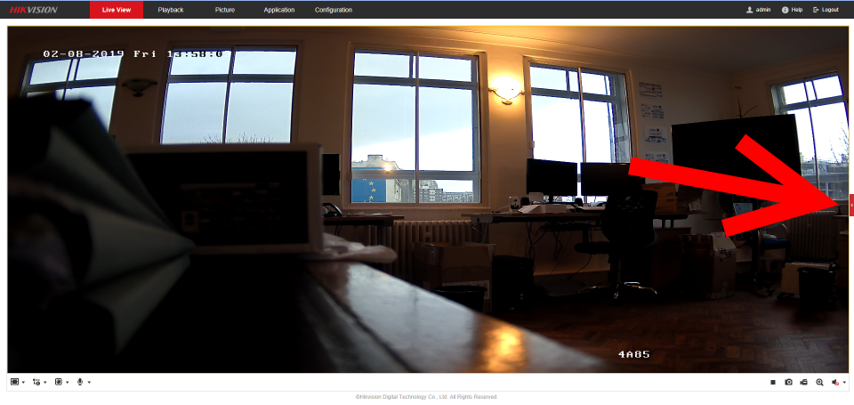

At the right hand side of the Live view screen you will see a small arrow:

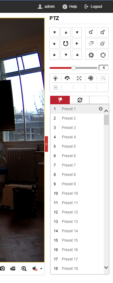

Click on that and a fly-out will appear from the right revealing all of your zoom, focus, and preset controls:

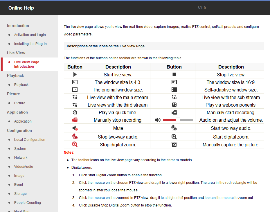

Click on the Help button at the top right of any page for further help and information contextually appropriate to the page you are currently on e.g.:
For the icons on the Live view page:

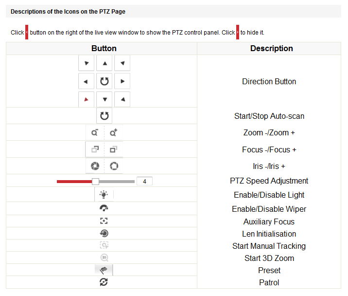

And for the PTZ controls panel:
