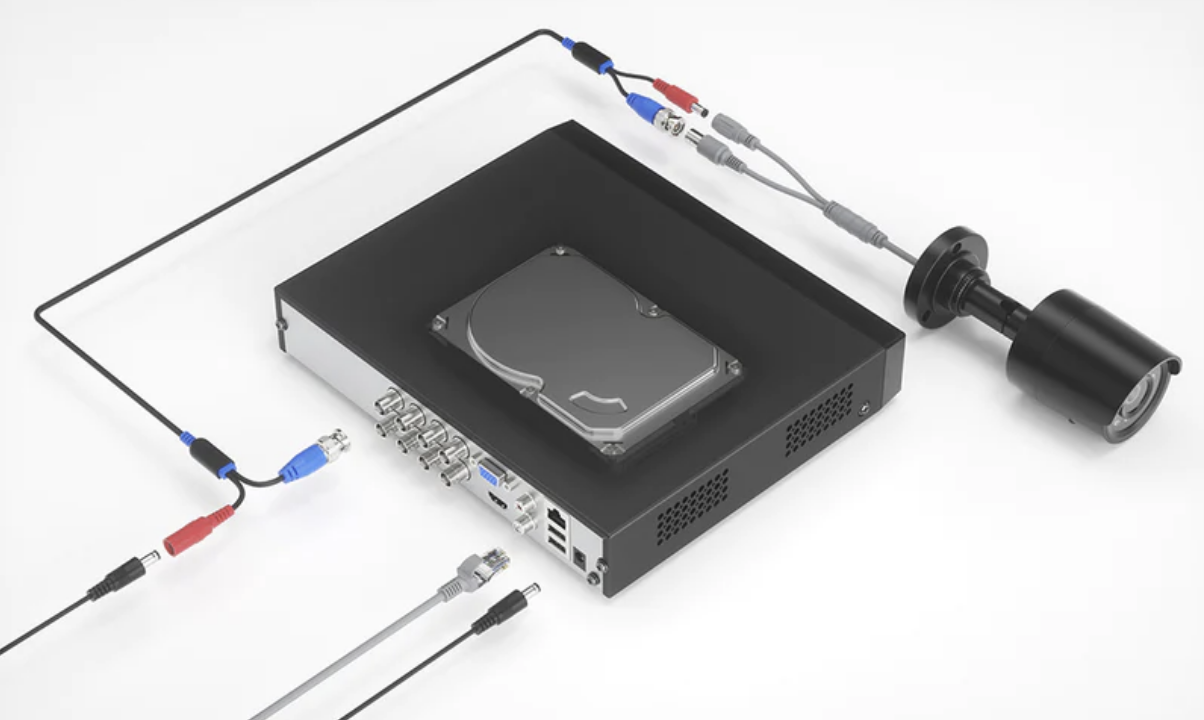

We don't have a huge amount of experience with analog kit, but looking at the below diagram from the Annke website for your DVR model it looks like the analog cameras need to receive power from a separate PSU.
I think this is pretty standard for most modern DVRs/Hybrid DVRs as most current analog cameras support either PoC (Power over COAX) or powering via a separate PSU.
I don't know anything about whether or not it is possible to wire the RS485 cable to a USB, our only recommendation would be to replace the PTZ with a newer analog PTZ model or an IP PTZ (the DVR you have can record IP cameras up to 6MP, but you might have storage/bandwidth limitations so we would probably recommend a 2MP or 4MP IP PTZ).
