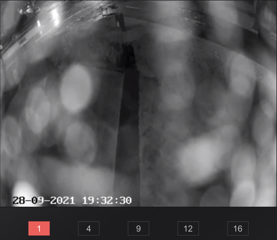

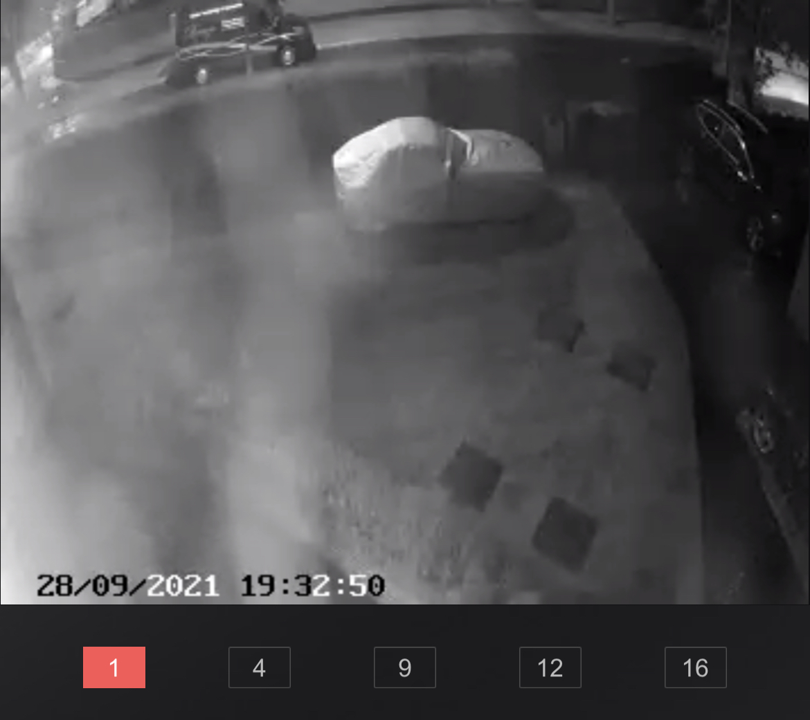

Thanks very much for the time taken to offer some great advice JB.
I've taken the plunge and ordered a 2347G2 to replace one of the cameras so I can see how well it fairs with the street lighting. Being on the eaves of the house I dont really want them illuminted so hoping I can turn it off and will try adding ambient light at ground level if I need. If all else fails I'll add it as a lower level camera on the garage.
Thought I'd show how awesome the current cameras are :\ Look forward to a before and after :)
Thanks again!

Good call. The 2347s are surprisingly good with only a little light so you may be just fine with the street lighting. Some ambient light may allow you to set the exposure to a faster time reducing motion blur when playback is paused.
