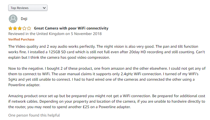

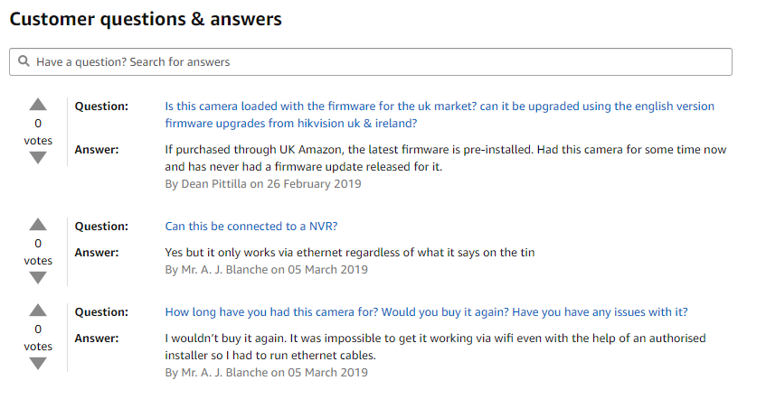

A quick Google search reveals Amazon reviews that show wi-fi is a problem with this model :(
Probably best to speak to your reseller / Hikvision Tech Support.
