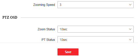

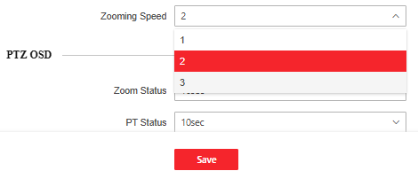

J johnfitzy Knows a LOT of stuff Trusted Member Messages 427 Points 43 Dec 30, 2024 #1 Hi... when I try to change the "Zooming Speed" value from 3 to 2 I get: But when I go back to the page the value has not changed: Has anyone with this or a similar camera seen this? I get the same result on a DS-2DE4A320IW-DE also.

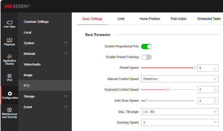

J johnfitzy Knows a LOT of stuff Trusted Member Messages 427 Points 43 Dec 30, 2024 Thread starter #2 OK now... the "Zooming Speed" cannot be changed if the "Image Parameters Switch" is on... It's odd because the "Zooming Speed" setting is on the PTZ menu, not the Image menu, and "Zooming Speed" is only set once, not per Image/Scene.
