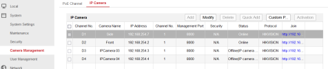

Hi Dan
I have two cameras both the same, model DS-2CD2335FWD-12.8mm
How do I get to see what current firmware is running?
Stewart
Hi Dan
I have two cameras both the same, model DS-2CD2335FWD-2.8mm
Stewart
Apologies @stewart
I mentioned Virtual Host in the above comment but didn't link you to the instructions on how to set it up, see below:
Virtual Host creates a link that allows you to log in to each directly connected camera, you will need a camera password to login to each camera and if the cameras were activated via Plug & Play when you first connected them to the NVR they should be using the same password as the NVR.

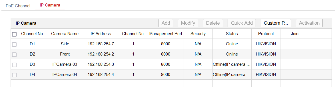

Hi Dan, following your instruction I can now see the camera IP addresses but cannot get by the Camera login. I have tried the NVR User and password and Hikvision default password “admin” “12345”. But still cannot login to the cameras. I am not sure if the CCTV installation guy set a password to the cameras or not.
The NVR IP is 192.168.1.64
Camera 1 IP is 192.168.1.64:65001
Camera 2 IP is 192.168.1.64:65002
The only thing I noticed when I ticked Enable Virtual Host the NVR did not reboot. So I rebooted at the NVR.
Any help would be appreciated
