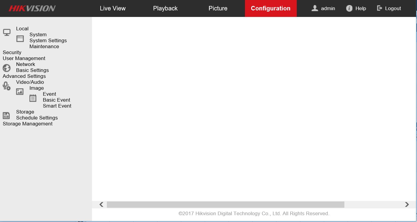

I've upgraded one of my cameras connected to a NVR DS-7608NI-K2/8p to V5.5.0. The camera, a DS-2CD2135FWD-IS, was running v5.4.5_170124 and I installed v5.5.0_170725 from IPC_G1_EN_STD_5.5.0_170725. According to the release notes my camera is compatible with this version.
However, after the upgrade and subsequent reboot the Configuration menu is corrupted. I'm not able to select any of the configuration items (and so not able to revert back to the previous version). I've done a hard reset using the button in the camera but the Configuration menu stays corrupted. The NVR is able to connect to the camera again (Plug&Play), Live View is working and the recorder is able to record images, just the camera's own Configuration menu fails. (yes, I am using IE)
Any suggestions?

Update: interestingly the menu goes back to normal when I bypass the NVR and physically connect the camera directly to the home network, after hard reset. When I reconnect the camera to the NVR (hard resetting again) and approach it through Virtual Host from the NVR's System/Camera Management screen the Configuration page goes haywire again. Could there be a compatibility issue with V5.5.0 and the firmware of the NVR?
