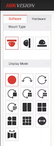

You can change the live view layout using the menu on the left-hand side of the browser live view, see below:
