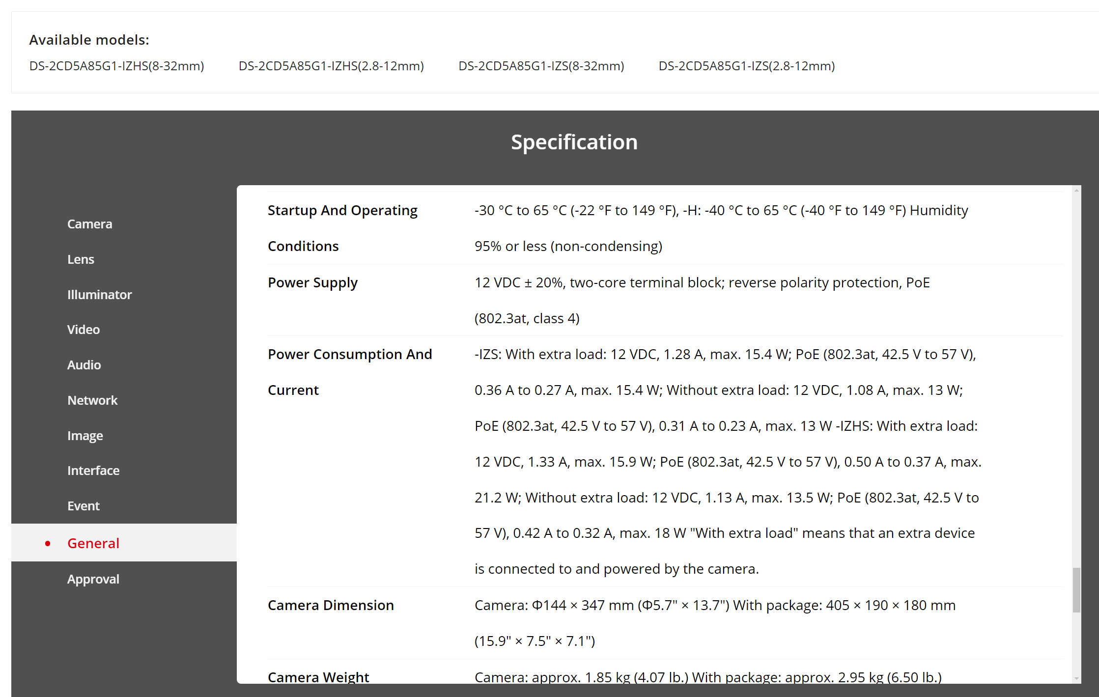

hey, I have a problem with the ds-2cd5a85g1-izs camera, after adding the camera to ds7732ni-k4 with the hikvision protocol, the camera resets over and over again and restarts all the time, if I add the camera with the ONVIF protocol, the camera works correctly, where to look for the reason?
