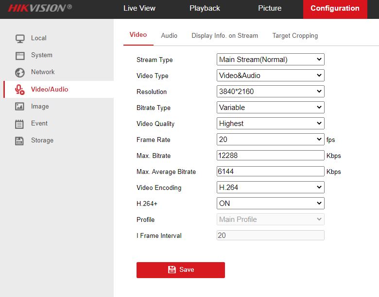

Side note and appreciate this is a side topic, but do you know if their are any optimal guides for Image and Video/Audio settings for devices that are standalone (I'm currently using 264+ as my synology NAS Security Camera suite doesn't like 265+)

There aren't really any guides to the optimal image settings because the settings vary with every scenario/install location.

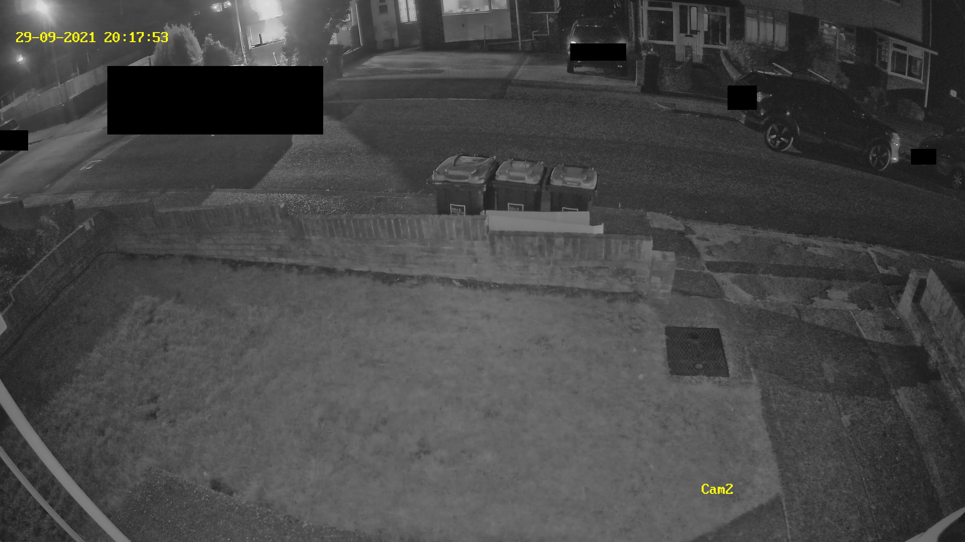

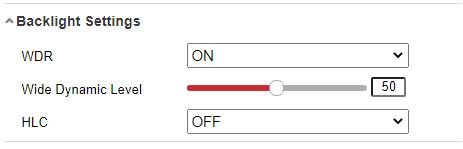

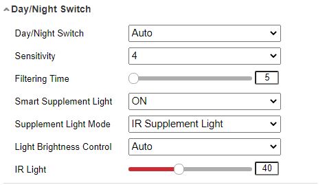

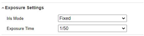

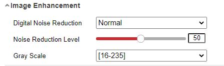

If you provide us with screenshots/downloaded snapshots of your cameras current live view, we can then advise if any of the image settings might improve your image.
So it's been 7 days on the POE injector and it finally dropped again. Applying firmware now and will see if it has any positive results. Fingers crossed.
As for the settings, see below. As it's currently a single camera I've got it recording to local SD and Synology NAS Surveillance, like I mentioned before I keep it on 264+ else the NAS complains the video isn't playable in the browser.
To be fair I'm pretty happy with the results, at night it'll go almost pitch black with street lights going off.
