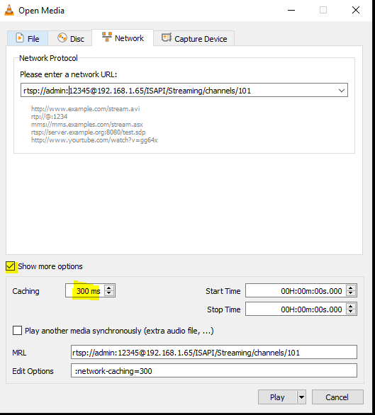

I have the lag too, even on the webGUI - Only a second or so.
In VLC (64bit) try lower the network caching to 300ms and see if it helps, might be a clue.
